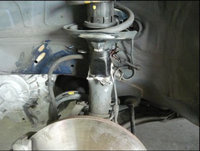

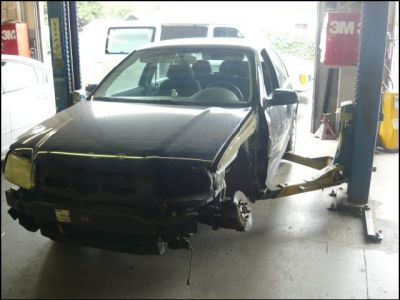

I had an accident a few days back where another car hit mine on the left front wheel. Based on the estimate provided by the mechanic, the suspension, the front axle assembly and a few things like hub, bearing, knuckle, ball joint, etc. needs to be replaced. I am just putting the key words from the estimate, I don't understand the technical details behind it.
The insurance company has considered the cost of repairs to be too high and totaled the car. I am thinking of getting it back as salvage and getting it fixed. The cost will still save me some money.
I am ok with all the problems with the resale value of such a vehicle and any cosmetic issues like paint etc. My concern is the safety. Is this kind of repair considered normal or will there be issues with safety in the future.
I have attached a couple of photos and can upload more if needed. Please let me know what you think.

Any time you have a vehicle that has been in a collision it is important to inspect all the components that could be impacted.
Form the pictures it appears you will at least need new strut, probably spring, control arms, hub, knuckle, say bar and links, ball joints, tie rod ends, and fender and bumper, grille, headlights maybe few more pieces that is not noticeable from the pictures.
If these are all the parts the vehicle needs that it should not be a problem to get it back to road worthy.
However, if there frame damage (impossible to know that from pictures), or damage to the subframe then the safety can become questionable. That type of repairs needs to be done at a certified body shop to meet the safety standard.
Hope this answers your questions.
