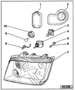

Headlights (Jetta), Assembly CAUTION! Before beginning repairs on the electrical system: Obtain the anti-theft radio security code. Switch off all electrical consumers. Switch the ignition off and remove ignition key. Disconnect negative (-) battery terminal. When disconnecting and reconnecting battery terminals, observe all applicable notes and torque specifications, as well as instructions on performing OBD program and electrical system function checks. NOTE: After performing any repairs or service that could affect headlight aim, check/adjust aim.
https://images.2carpros.com/forum/automotive_pictures/12900_h_5.jpg
1 - Sealing cap 2 - Sealing cap 3 - Double filament bulb for low and high beams Bulb H4, 12 V, 60 W/55 W 4 - Headlight beam adjusting motor* 5 - Not applicable to USA/CDN 6 - Not applicable to USA/CDN 7 - Headlight housing 8 - Fog light bulb Bulb H3, 12 V, 55 W 9 - Double filament bulb for parking/turn signal light Bulb 12 V, 21W/SW 10 - Parking/turn- signal light bulb holder *) Where applicable https://www.2carpros.com/kpages/auto_repair_manuals_alldata.htm
