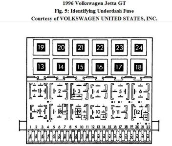

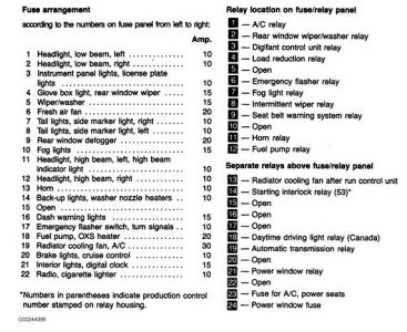

I asked and already donated regarding a question and recieved a reply posted on 7/11/2010 @ 6:45 PM from Rasmajaz.I was really looking for ALL the relay marks and the locations they are supposed to go as I moved a few of them and need to put them back where they belong. EX: relay mark #? Goes in relay location number?. Thank You rrobertt@verizon. Net
Saturday, July 31st, 2010 AT 9:29 AM
  • 75,992 POSTS
Hi rrobertt,Welcome to 2carpros and TY for the donation.
See diagram below:
https://www.2carpros.com/forum/automotive_pictures/12900_f_6.jpg
https://www.2carpros.com/forum/automotive_pictures/12900_f1_23.jpg
