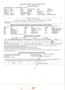

The 1976 fuel injected beetle didnt pass smog and i was wondering if you guys could tell me if i need a new catalitic converter or what. here are some things that they wrote why it didnt pass! smoke detected in tail pipe co2 & nox(1pm)

If the car failed due to visible smoke then there is a mechanical issue involved and replacement of the cat will not stop visible smoke. If it failed for an emission related issue then I need to know all the numbers from the test.

Heres the document
https://images.2carpros.com/forum/automotive_pictures/314434_20090208131851_1.jpg

The test results came through but I cant see the numbers. Could you please resend them to my E-mail address?
