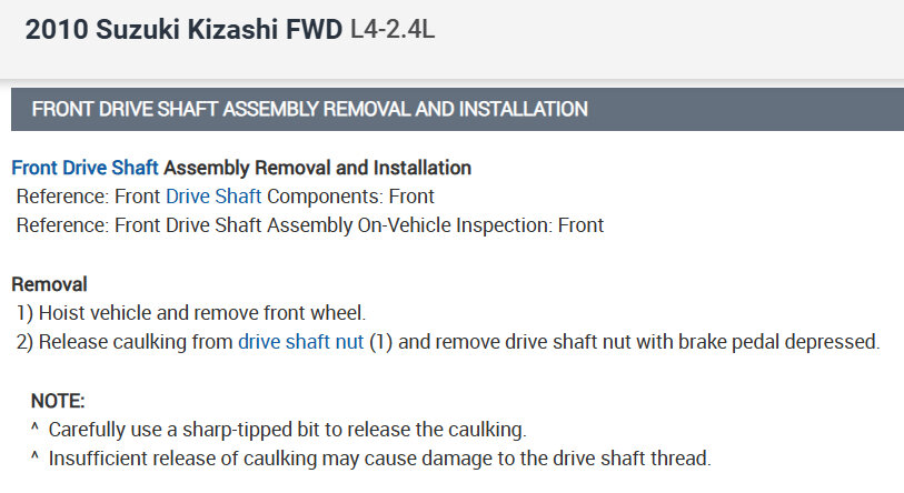

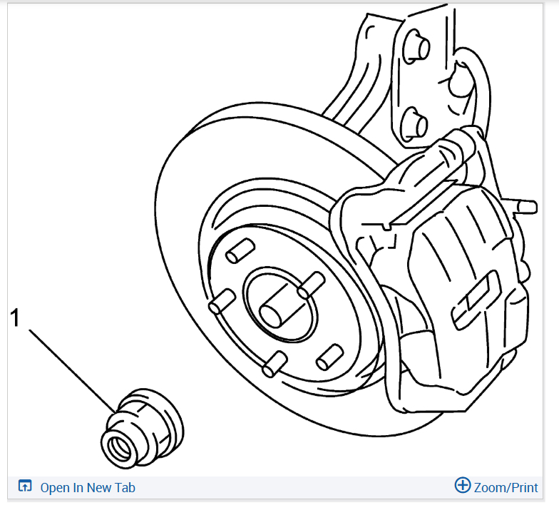

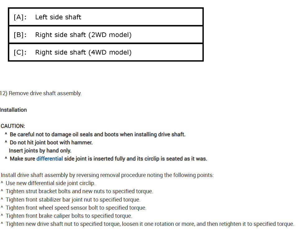

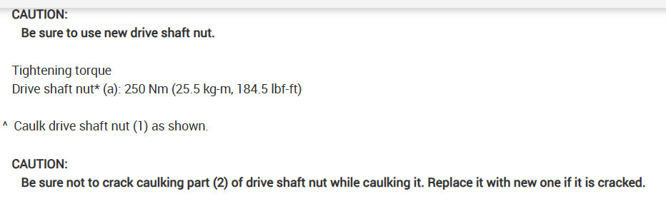

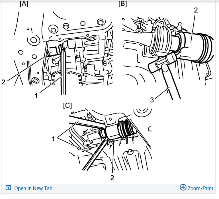

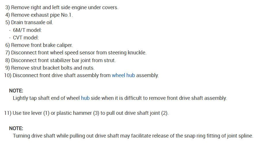

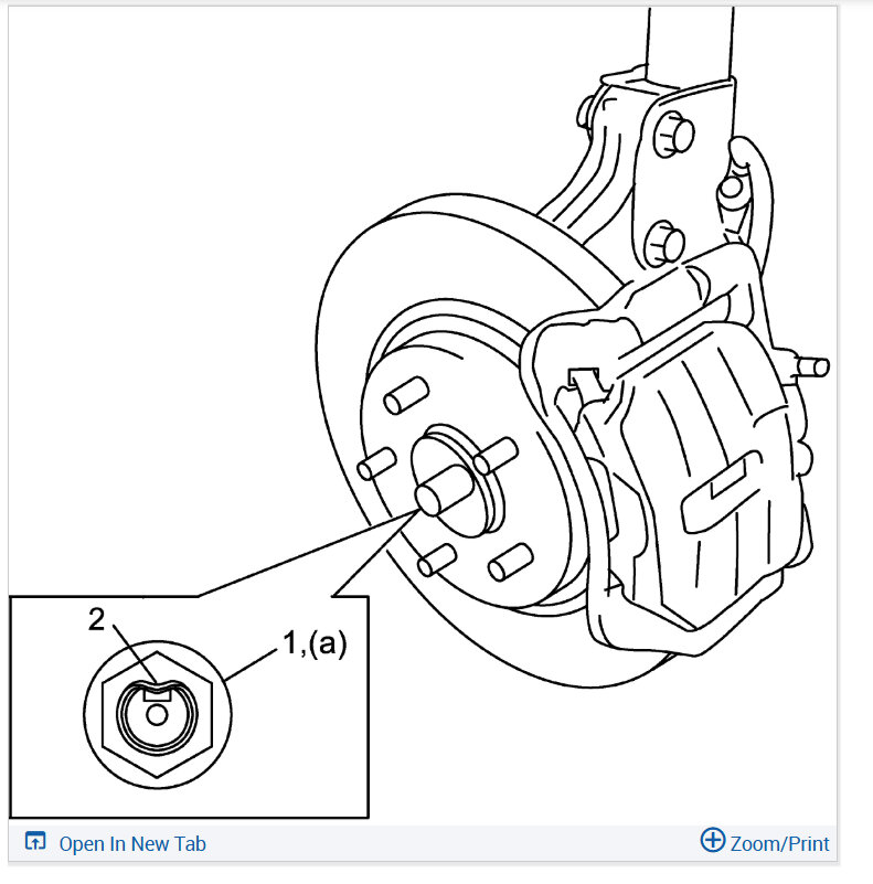

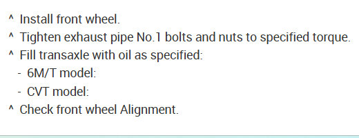

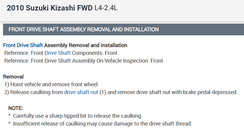

Sure, if the engine is not misfiring, I have seen worn out CV axles cause this problem. The CV cup wears out and causes a binding when under acceleration. Here is how to change the CV axles out which should solve the issue.
Dec 7, 2024 at 5:02 AM

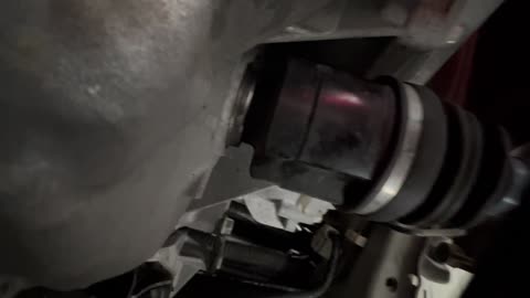

BALJINDER DHILLON
Hello there,

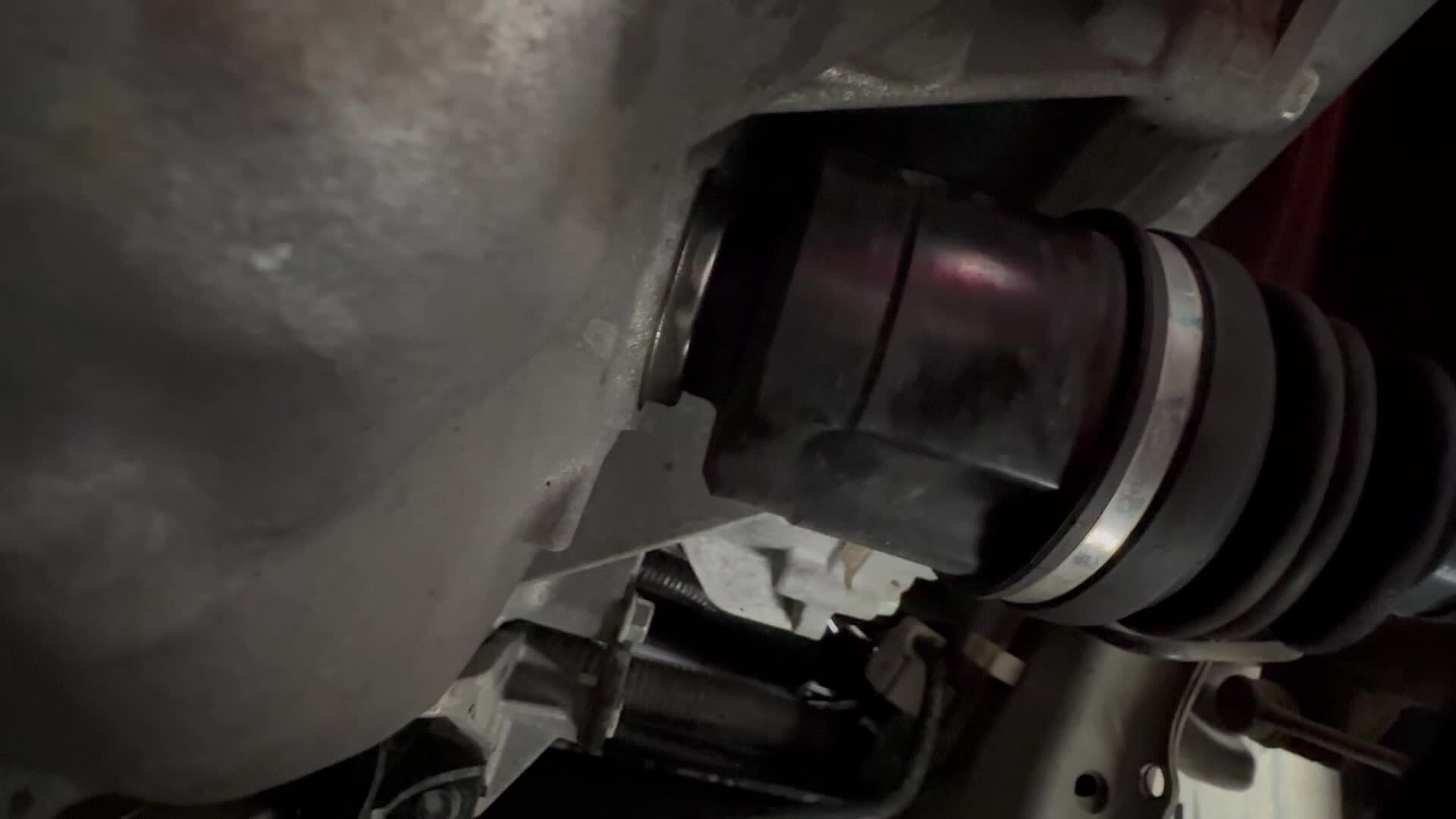

I appreciate your response; I did some work by myself and recorded a video from under the car. Could you please watch the video and advise me of the problem there? Thanks very much.
Dec 7, 2024 at 1:13 PM
  • 55,423 POSTS
Thanks for the video. You won't be able to tell by what you are doing, the CV axles will need to be removed and disassembled to check the cups and center ball holder for wear to be sure.
