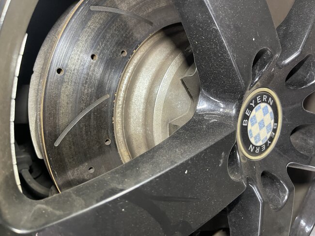

There is vibration when you hit the brake, but it's not so much in the steering, there is some, but it's in the front wheels. jacked it up and looks like the front rotors and brakes are new, slotted drilled rotors, tires are new, wheels in great, only thing I found was low air pressure in all tires...have not yet driven it since inflated. rear brakes also look new. Checked for any play on front and there is none on 12-6 or 3-9.

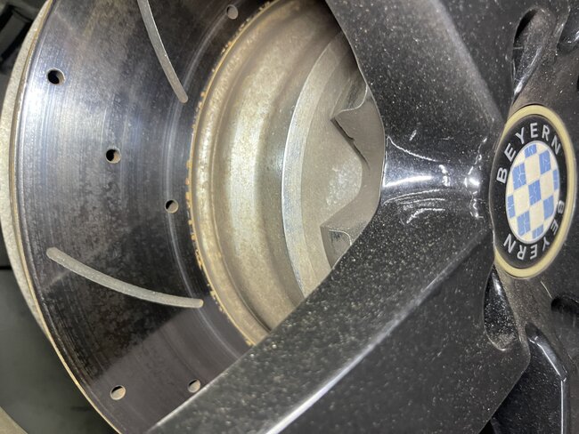

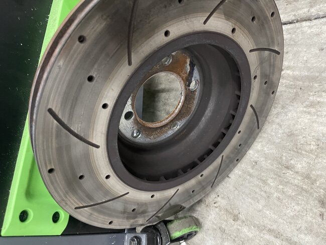

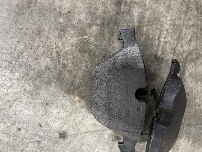

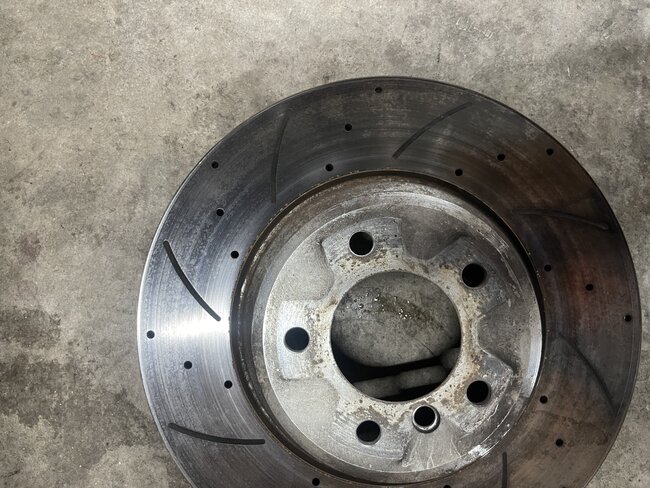

Inflated the tires and went for a drive, no shaking while driving even up to 80 except when you brake so tires and wheels are most likely out. Only after you brake, even when the rotors are cold. If the control bushings are bad i would have known, had so many of these but it doesn't have it and does not pull and especially when you brake it does not pull or cause a clunk that is associated with a bad bushing. Here are pictures of the rotors. Do you know if these can be turned? And if yes can i use the sane pads just to see first whether the rotors were the issue? I can then replace the pads.

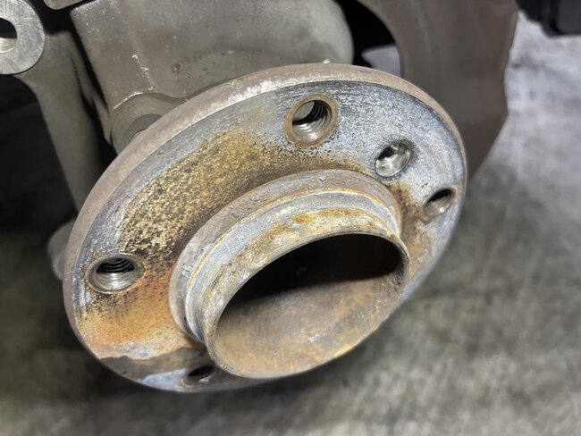

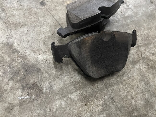

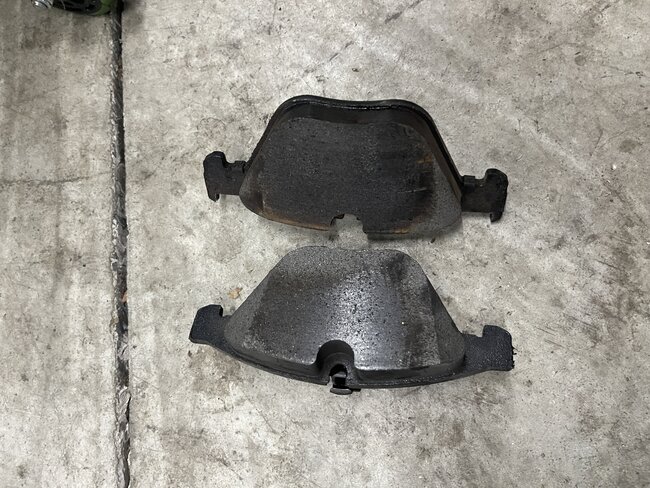

Removed them and these pads are bad CarQuest brand, i doubt they changed rotors maybe just pads to get by. And the marks do not look good. And going to turn the rotors and get some good pads and see. And where the rotors sit may not have been cleaned.

Thanks for the feedback.
The rotors and brake pads certainly do not look great.
