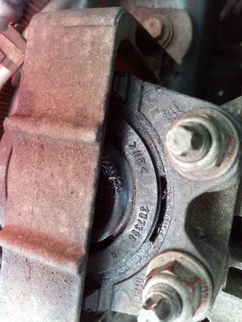

The car listed above is a 1.6 MK2. The vibration starts at around 50 MPH.

No, the engine management light is on. I need a new engine mount but do you think that would cause so much vibration?

As far as the engine mount is concerned, yes, it could be causing the issue. Which mount is bad? Is it loose, broken, or what is actually wrong with it?

Hi, no engine management light is on, it's the top right engine mount.

The mount could be an issue. What I suggest is to replace it if it's bad and see if that was the cause. Since it needs to be replaced, it won't be a waste of money.

That makes sense. I went through two manuals trying to find it, but I had no luck. Regardless, a mount can certainly cause it. The interesting thing is you can drive through the vibration which usually indicates a balance issue or bent rim.
Let me know if the mount takes care of it.
