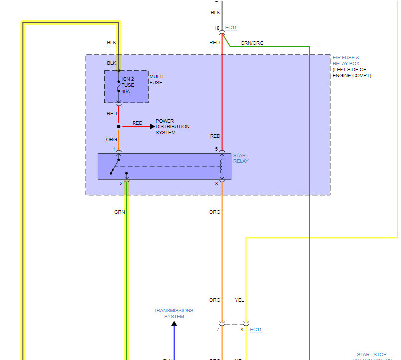

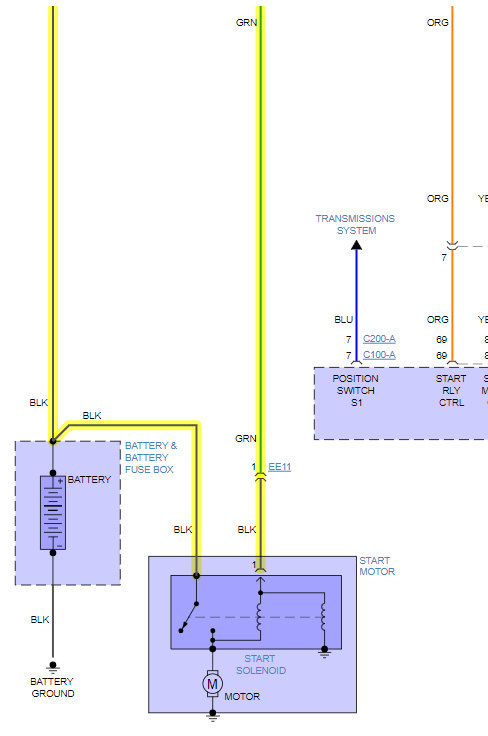

Checked the oil and it was low. Grabbed a couple of quarts and it was then at a good level. Tried starting the car and nothing. The car has power, but I only hear a quick clunking sound, like one click and nothing else. A friend showed up and we tried jumping the battery. We saw sparking and smoke coming from the starter. Any ideas??

Hello, this sounds like an interesting situation considering the vehicle is not that old. Have you actually checked down at the starter motor connections to see if something may have shorted out or are there any melted wires down there? And how low on oil was the car? If you had to put 2+ quarts in the vehicle that's a big concern. Are there any obvious leaks you can, see? I'm going to post the starter circuit wiring diagrams in a minute as well.

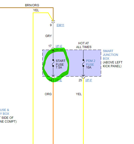

In the third diagram, I'd like you to check that Start Fuse (7.5amp) too.
