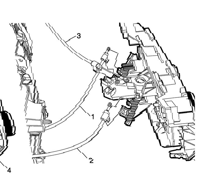

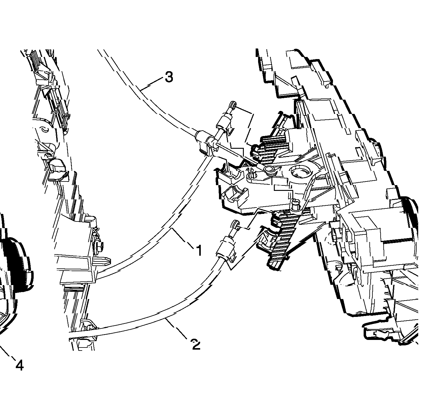

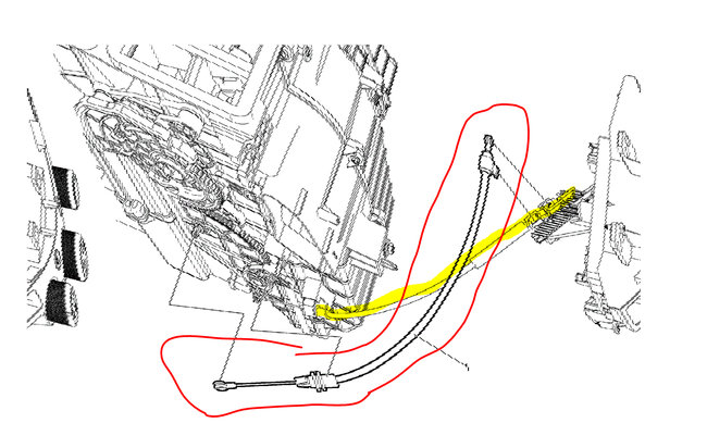

I assume they want to replace the entire HVAC box. The idea that the cable was replaced and now is hard again is most likely a cable issue or one of the components which adjust. I attached a pic below. It shows the cable in question. This cable (known as a mode door actuator cable) simply attaches to the controller you adjust with your hand, and a plastic door on the HVAC box. I have a feeling it is disconnected.

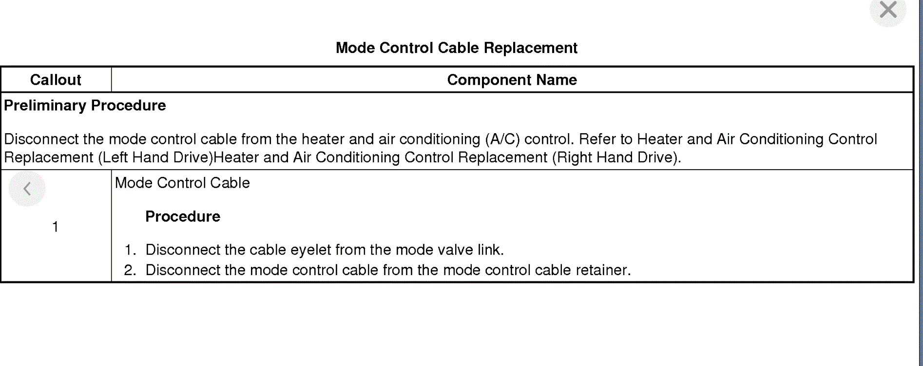

If you look at picture 2, it explains how it is replaced. Before we jump the gun and replace, what I want you to do is this. First, confirm it is properly attached and seated in the cable retainer. If it is, disconnect it at the mode door and see if you can operate the door by hand. If you can, the system doesn't need replaced. Instead, there is an issue between the mode door and the controller, most likely the cable again.
Let me know what you find.

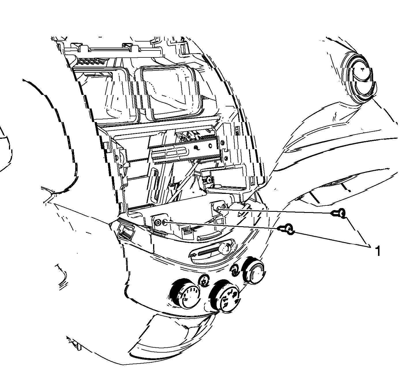

If you remove the panel from the controller on the dash, you will find the cables. One is for temperature control, one for mode (which is your focus), and one for fresh air. Basically, if you were to follow that cable back under the dash, it will lead you to the mode door actuator. Here are directions for removal of the panel in front where you make the adjustments. I attached the pics that correlate with the directions. In the picture, the mode door cable is indicated (number 2).
These directions are for controller replacement which isn't what you are doing. However, I provided them to help you gain access to the cable.

4. Remove the heater and air conditioning (A/C) control screws (1).
pic 2
5. Remove the heater and A/C control (4) by pulling it out to provide clearance for the removal of the cables.
