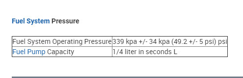

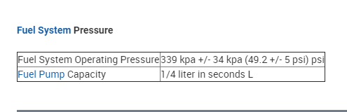

This clearly sounds like a fuel issue. We just need to be sure it is a pressure issue and not a delivery issue. Let's start with checking fuel pressure. I attached the spec but you should have north of 50 PSI.
If you can't get a fuel pressure gauge right away, there is one way to try to point towards a pump and that is to cycle the key about 5 times then trying to restart. This will cycle the pump and sometimes they are able to build the pressure again to cause it to start. It may stall again but at least that confirms building the pressure is making a difference. At that point, I would put a pump in it. However, let's see if we can get the pressure first and then go from there.

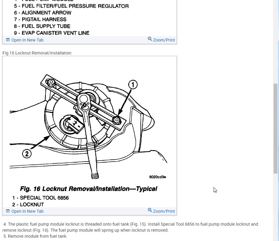

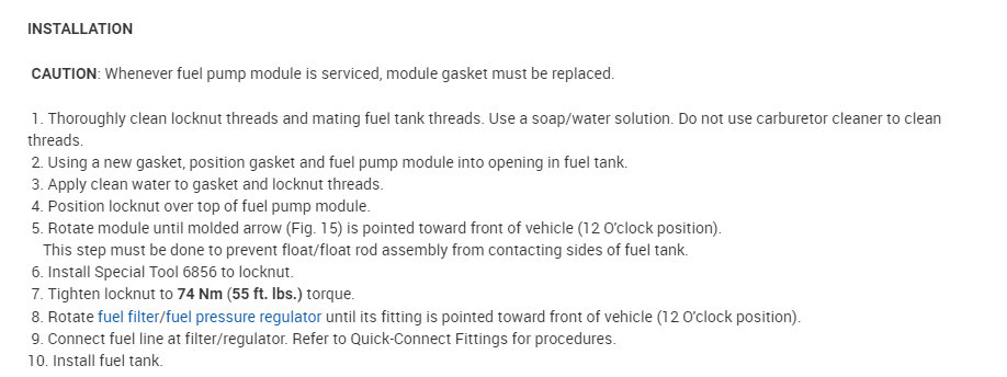

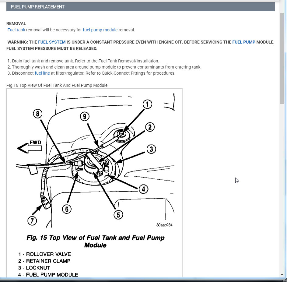

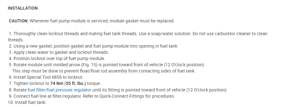

I attached the process for the pump just in case we prove that out. Thanks
