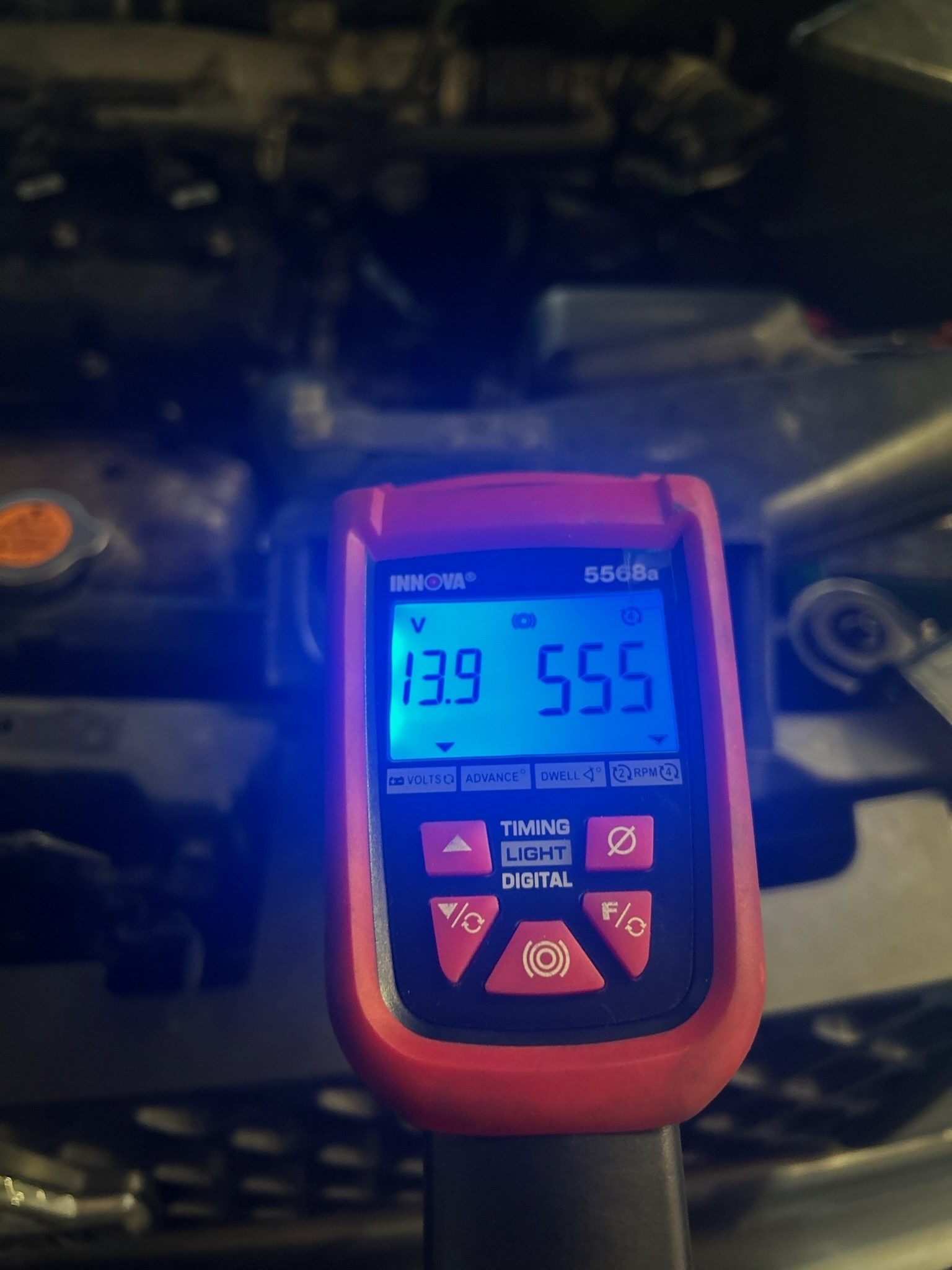

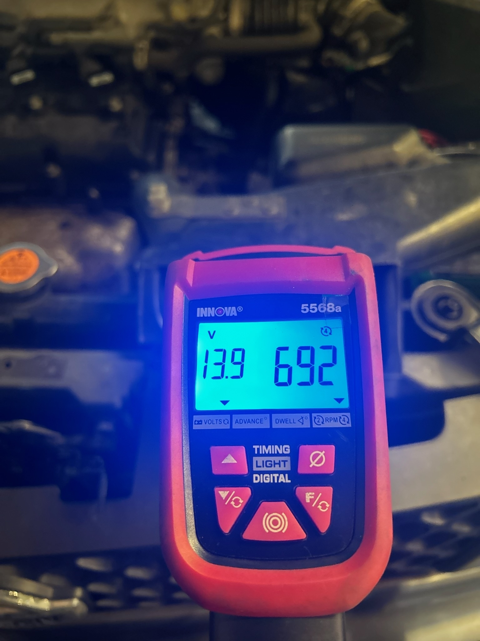

Reset computer. Checked idle 700 ish parked 555 in drive when warm

It runs pretty good. Only when braked in Drive does it vibrates. If i let go of the brake it drives off pretty quickly. A 5kph
I put the Nissan in neutral and that seems to settle it at intersections.
7
While driving it doesn't shake, everything works pretty clean and sound.
Rpms specs 700 in park N
550 in drive
