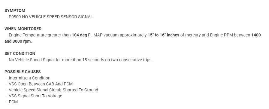

Here is what I need you to have done to confirm a few things for me: I had to scan the can-bus to get a code. The code I got was a P0500 which indicates a communication issue with the cab module/ABS module. If the module isn't communicating, neither will work. The fix was the replacement of the module.

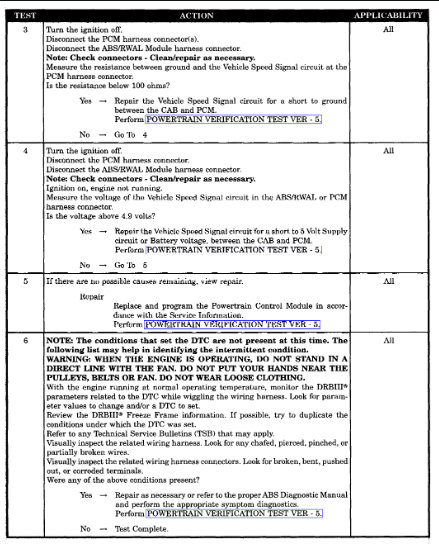

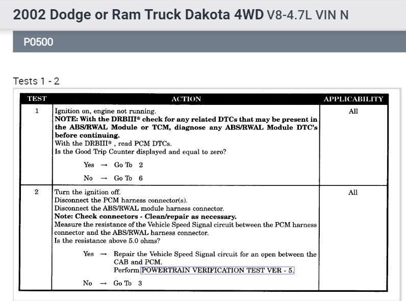

Okay, that is what I got. Do you have a scan tool that can communicate and actuate the modules on the vehicle? We need to check the ABS module to see if it is responding. The breakdown is the vehicle speed signal is not present.
Take a look through the diagnostics below and let me know if you are comfortable performing them.

Okay, I totally understand. What I would suggest is to have the ABS module tested to see if it is communicating with the other modules.
