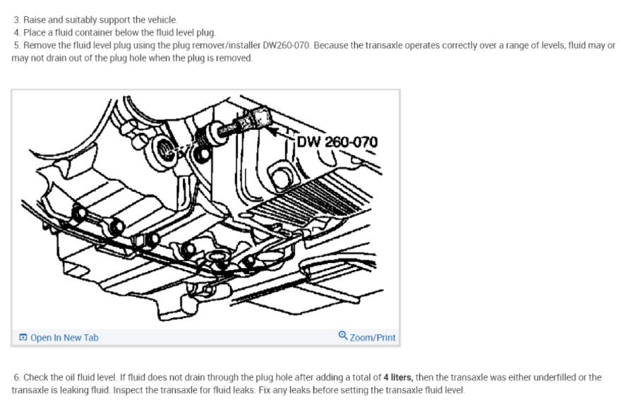

The vehicle has a CVT and unsure whether I can check the fluid level. Does say the first thing to check is the level but it does not have a dipstick and because the car is pretty low, difficult to get under to check. Do you think I can be able to check?
Jul 17, 2021 at 8:07 AM
SQM
  • 6,383 POSTS

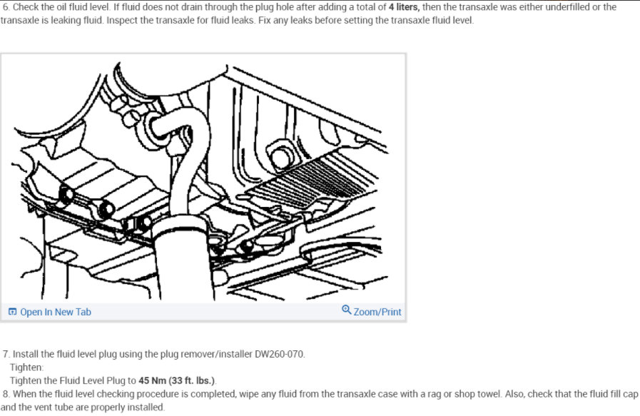

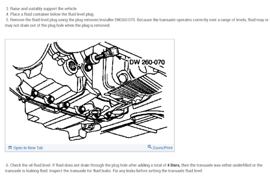

This CVT does not have a traditional 'dipstick' to check the transmission fluid.
There is a check and fill plug on the side of the transmission. To access that plug you will have to lift the car on a jack/lift then use a special tool to undo the plug and check the level. Usually the fluid should be just below the level of the plug. You should be able to put you finger inside and be able to tell the level.
I have attached diagrams to give you a little better idea.
Let me know if you have any questions.
Jul 17, 2021 at 8:39 AM

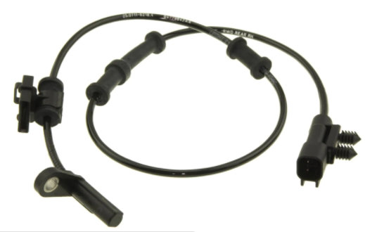

Do you know what the C112 FR RH In ABS SOL error code is? And how to fix it?
Jul 17, 2021 at 11:04 AM
SQM
  • 6,383 POSTS
Disconnecting the battery can reset the code, but it does not work for all vehicles as some will require the scan tool.
That C112 code typically points to wheel speed/abs sensor. If you had issue with the CV shaft it can happen or it could be simply for a faulty sensor. Check the sensor on the front right side wheel. Make sure it is connected properly and does not have any damage or loose wires.

The wheel speed sensor picks up the rotation of the CV axle, which is driven by the transmission. Good chances that the code got triggered when the sensor read different than the output sensor on the transmission.
