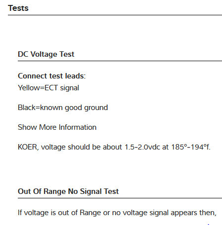

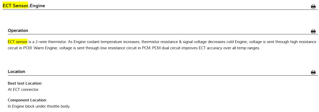

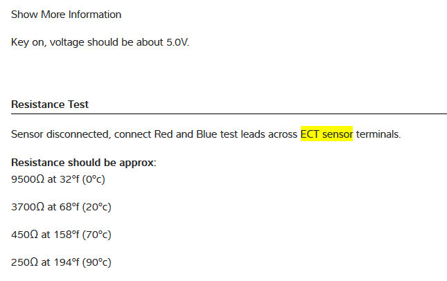

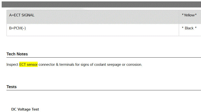

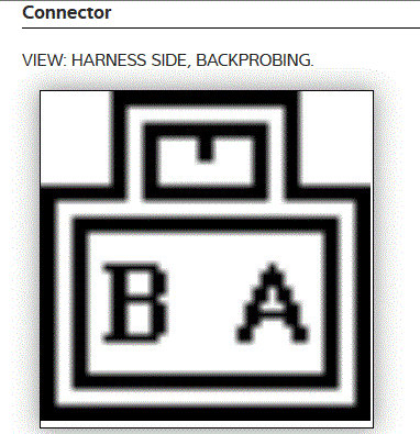

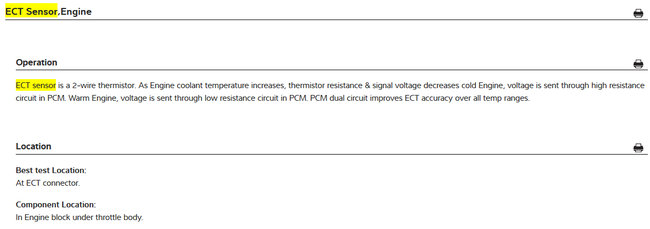

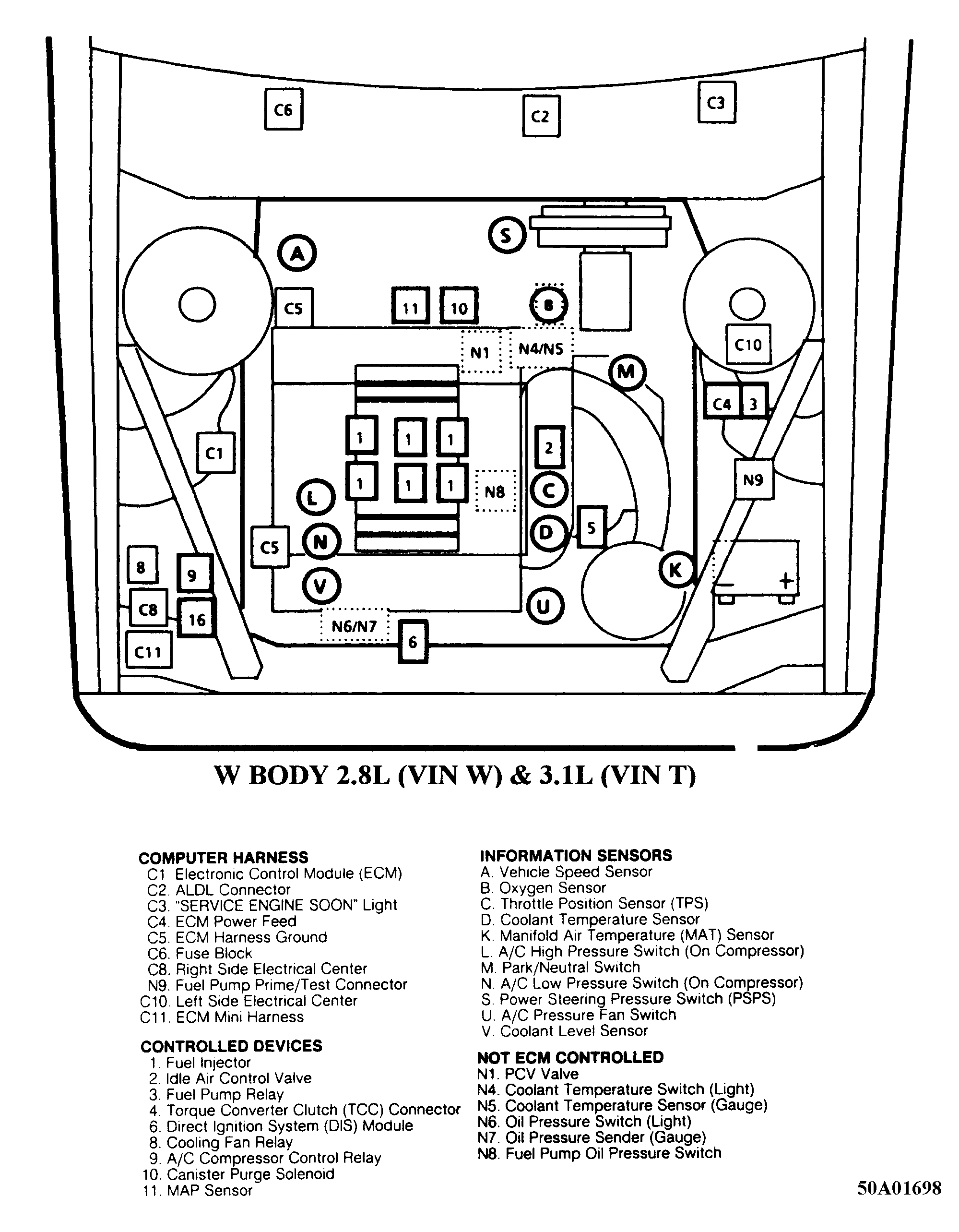

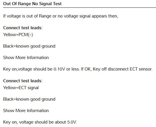

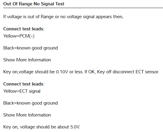

You don't have to buy a coolant temperature sensor to test it. I'm attaching a series of images containing how to test the engine coolant temperature sensor and where it is located. All you need is a decent multi-meter. Here's the one that I own: https://www.amazon.com/gp/offer-listing/B000X5TSUA
In reality, to me it sounds like you have a decent sized vacuum or intake air leak somewhere. As it warms up, the leak changes, and so does the performance of the car. The computer can only do so much to try to compensate for such a leak, but it tries. Here's a link to our guide on looking for an air leak: https://www.2carpros.com/articles/how-to-use-an-engine-vacuum-gauge
And here's a video on running this test: https://www.2carpros.com/articles/how-to-use-an-engine-vacuum-gauge. Try it out on a cold engine and hopefully it'll point you to whatever the problem is.
Hopefully these tests will get you fixed up. Let us know what you find and we'll go from there.
Harry

What is the correct voltage reading you should get for the coolant temperature sensor? I didn’t see the readings in the information. I also did replace all the vacuum lines along the intake manifold and intake plenum. Could intake plenum gaskets or intake manifold gaskets cause this to happen?
Feb 5, 2019 at 10:42 PM
HARRY P
  • 2,292 POSTS
Sorry, I'm not sure how it happened but those are the wrong images. I'm reloading them now. The voltages and resistance values are in the correct images. Yes, intake plenum and manifold gaskets could cause an issue like this. They would be allowing extra, unmetered air into the system, which the computer may or may not be able to adjust for.

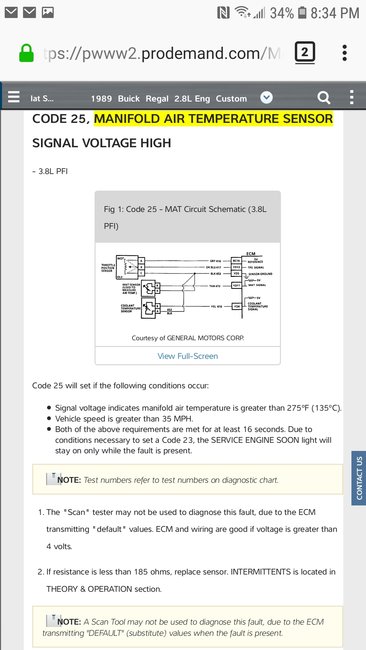

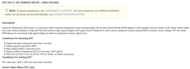

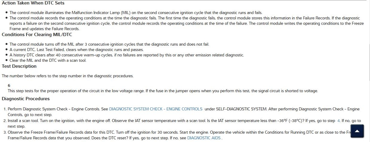

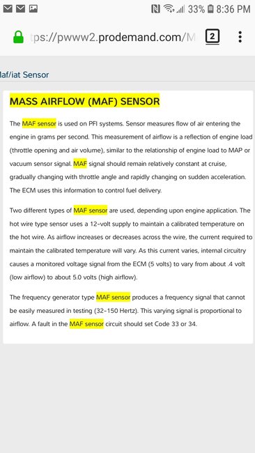

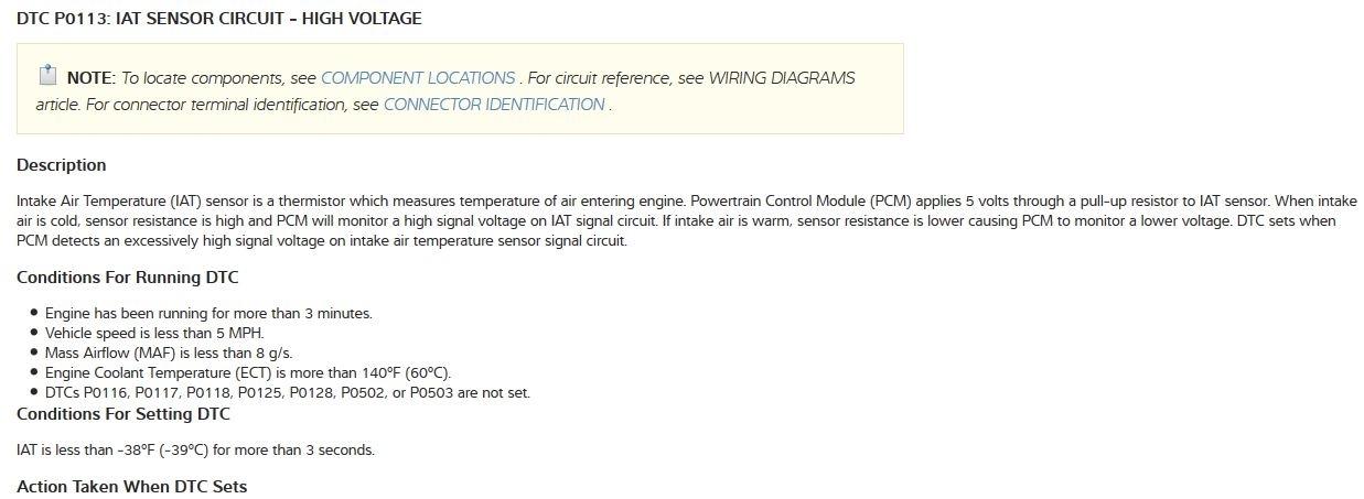

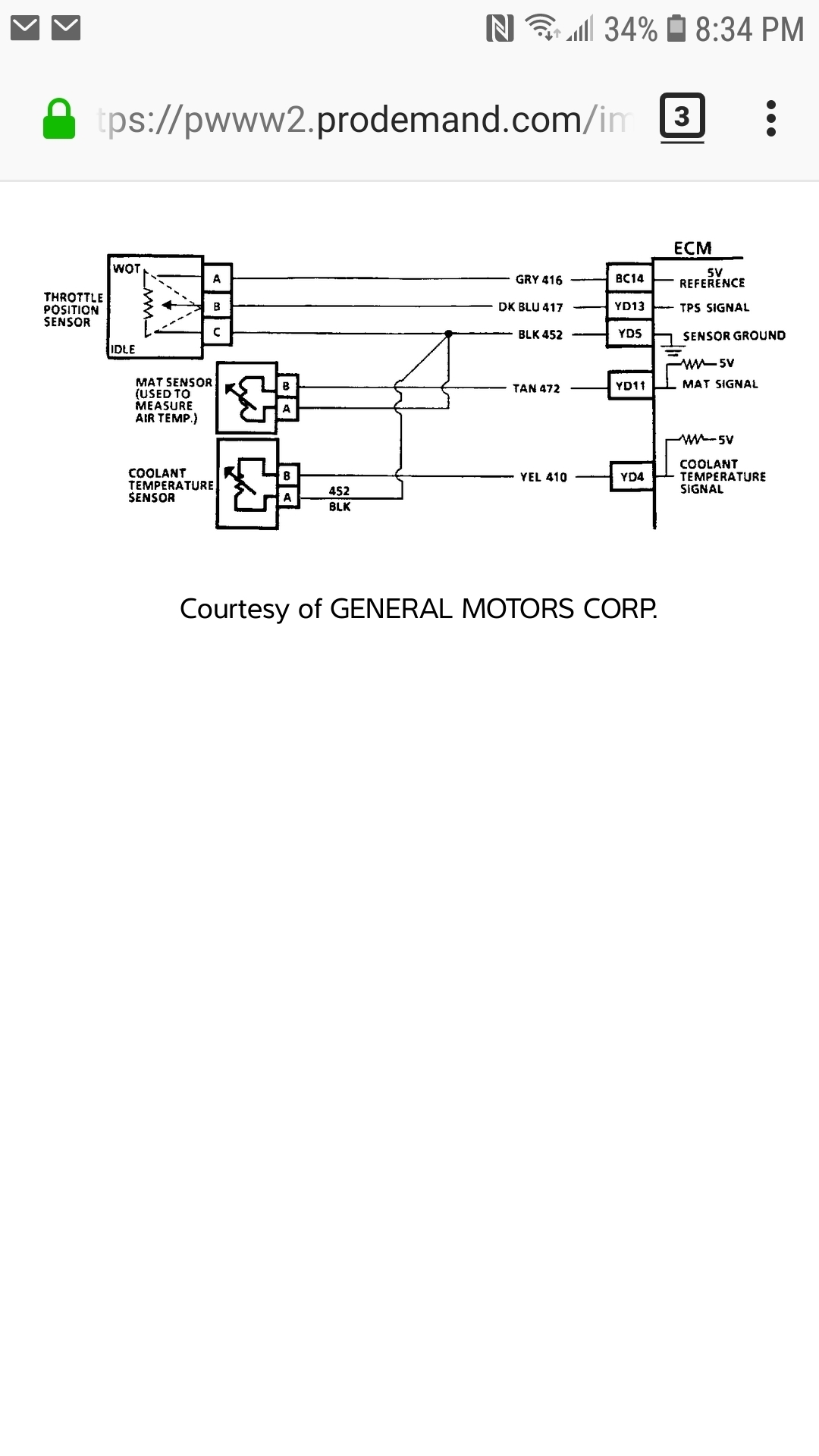

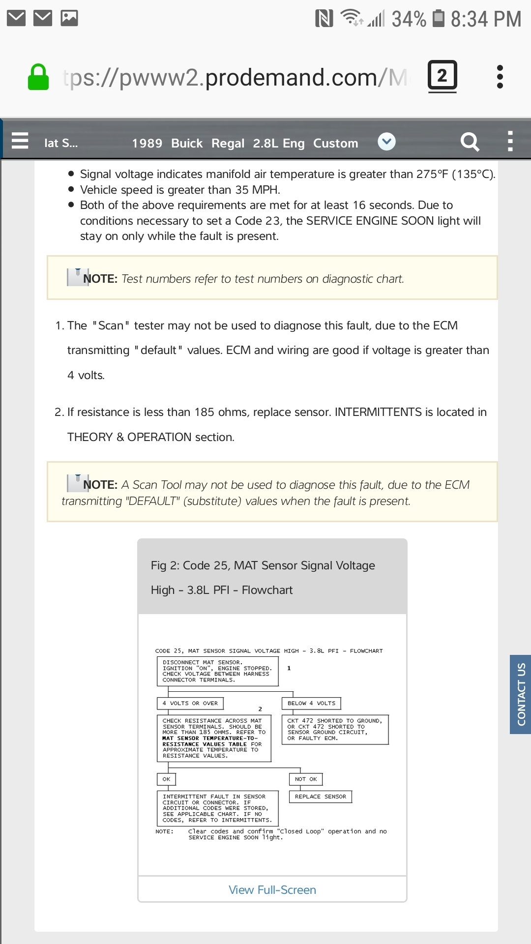

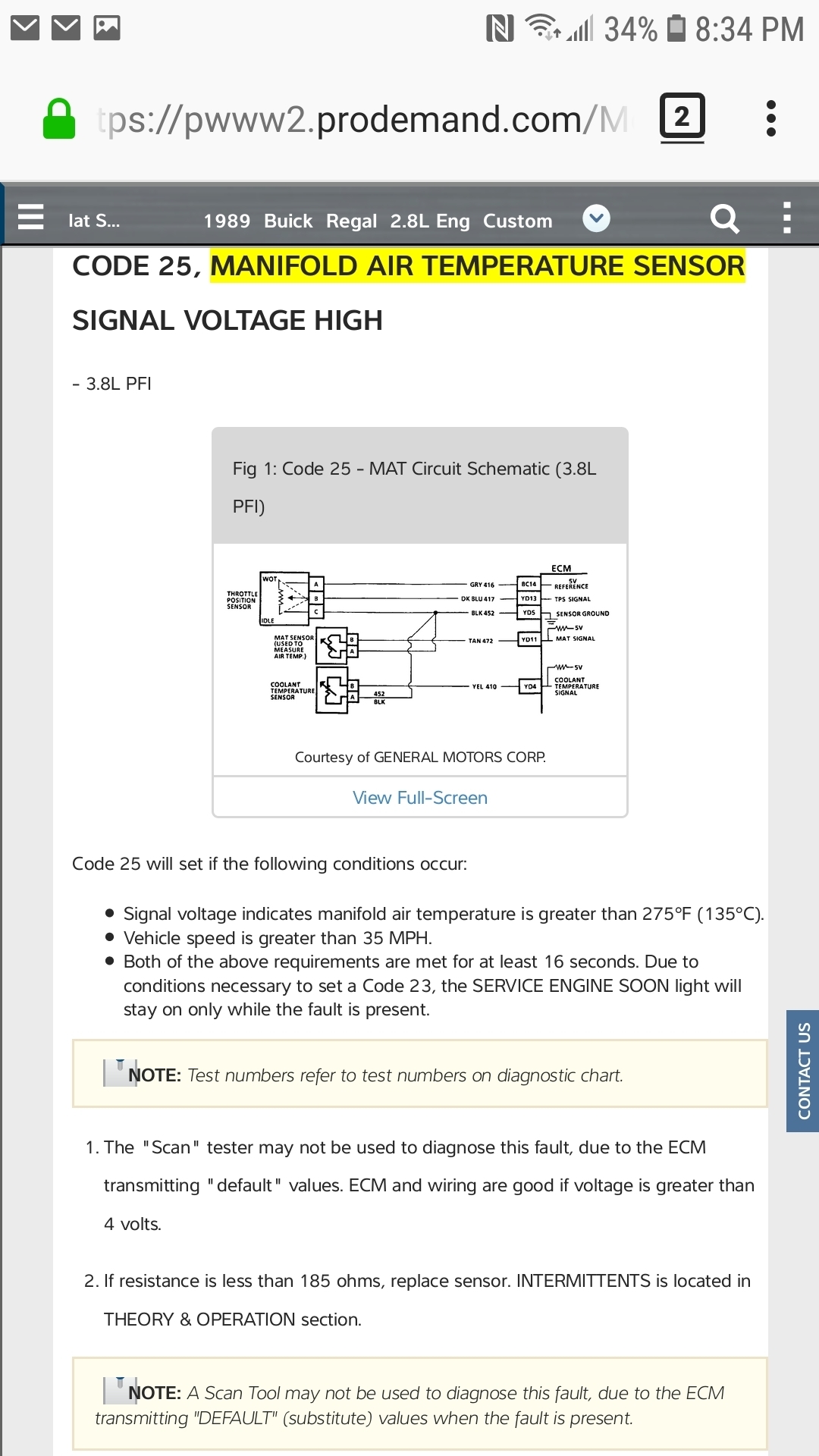

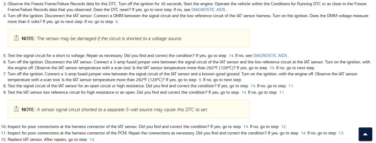

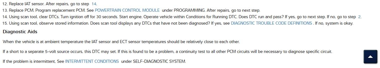

And how about the intake manifold air temperature sensor? I did more research related to my concern and it said when the car has troubling cold starting that sensor isn’t letting the computer give the right readings.
Feb 6, 2019 at 6:30 AM
HARRY P
  • 2,292 POSTS
Regarding air temperature sensor readings, I'll have to dig further later on. But here's what a quick check on Prodemand turned up.
