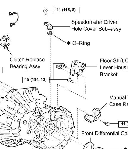

On a Corolla XRS 1.8L 170hp 2ZZ 6spd engine, where is the location of the vehicle speed sensor? Can't find schematics.
Wednesday, May 26th, 2021 AT 6:44 PM (Merged)
  • 109,885 POSTS
I have attached a picture indicating locations of the wheel speed sensors. On the transmission is a place for a gear driven speedometer gear but it has been replaced with a cover see picture 2.
Let me know if this helps.

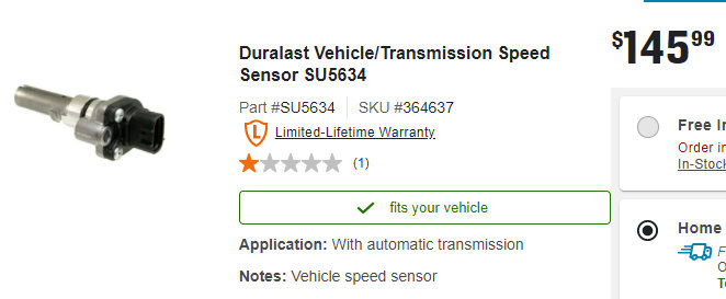

DANNY L
  • 5,648 POSTS
Hello, I'm Danny
I've attached a picture below of what the VSS- vehicle speed sensor looks like on your Corolla. It's mounted in the case of your automatic transmission. This picture and part number is from AutoZone auto parts stores and the part number can be cross referenced from any other auto parts stores near you. Hope this helps and thanks again for using 2CarPros.
+1

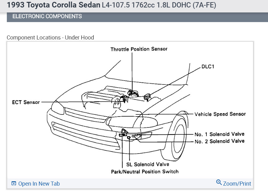

  • 1993 TOYOTA COROLLA
The speedometer in my 1993 corolla was working sporadically and recently quit completely. I was told to check the speed sensor. I unplugged it and reoved the bolt, but have been unable to get the sensor out. I have pried on it quite a bit and it is really stuck. Any suggestions?
+1
MMPRINCE4000
  • 8,548 POSTS
This is the 4 speed automatic?
Looks like one bolt holds it in: Althouth it does say there is a retaining plate that must be removed after bolt. I have no clear picture of it.
https://www.2carpros.com/forum/automotive_pictures/108325_vss_1.jpg
+15

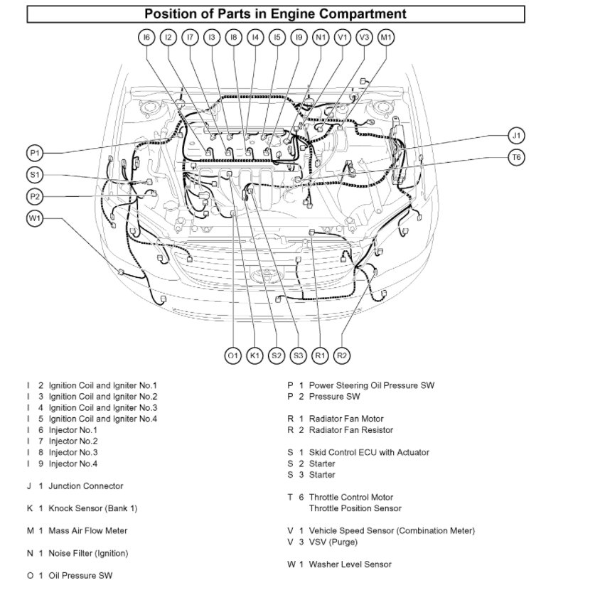

  • 289,000 MILES
My transmission starts slipping and jumping in and out of gear, while driving sometimes. When this happens the speedometer needle jumps up and down from zero to approximate actual speed of vehicle. I do not know why it does this. Added fluid seemed to help but has not solved problem. Please help!
+1
KEN L
  • MASTER CERTIFIED MECHANIC
  • 48,369 POSTS
It sounds like you have a VSS that is going out here is the location so you can replace it. Check out the diagrams (Below). Please let us know what happens. Cheers, Ken
+1

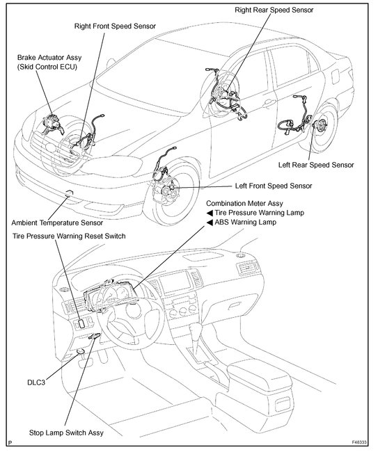

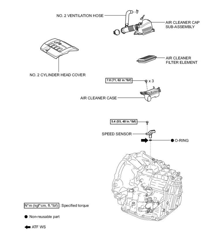

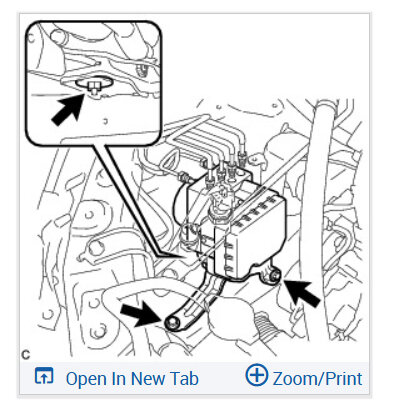

Hello, entering the chat with similar intermittent P0500 issues in my 2010 corolla, 1.8 LE. Same as others, no speedo, no shifting, power steering in not calibrated, check engine. I replaced the input VSS on the top of the trans under the air filter. Did not resolve. Tried replacing the instrument cluster in case the problem was the signal not getting through there. It magically resolves itself sometimes - all lights, codes and problems gone - but then comes back. Next I want to find and replace the output speed sensor - looking for a diagram or description of where I will find that. Thanks for your help. What a pain in the butt!
Wednesday, December 4th, 2024 AT 9:55 AM
KEN L
  • 48,369 POSTS
So this car does not have a VSS sensor, it uses the ABS wheel speed sensor data from the ABS control module. Can I ask if you have an ABS warning light on?
The P0500 - Vehicle Speed Sensor (VSS) Malfunction code
Please let us know.
Wednesday, December 4th, 2024 AT 10:45 AM
EETTHHAANN
  • 6 POSTS
Interesting. the ABS light does come on along with the others. The couple mechanics I've talked with haven't mentioned the ABS though. I'm curious about this make not having a VSS.
https://www.standardbrand.com/en/ecatalog?year=2010
This is the part i replaced and from what I'm told there's the one top of the transmission, under the air filter, the input sensor and that there is another identical one on the final drive of the transmission which is the output. They said if one is bad or has a bad connection it can explain all these problems coming on and off intermittently. Thanks for your help!
Wednesday, December 4th, 2024 AT 12:52 PM

There is a revolution sensor but not a VSS, here are the wiring diagrams and location of the sensor to help you see for yourself. Check out the images (below). Please let us know what happens.
Thursday, December 5th, 2024 AT 1:03 PM
EETTHHAANN
  • 6 POSTS
Hi Ken, thank you. I wonder if revolution/speed sensor are used interchangeably? Those diagrams definitely match what I've seen.
Whichever it's called I've been told there is an 'input' and an 'output' sensor. The one I've found and another identical one. Standard auto lists each but they're the same part no. Would you know where the second one is in case that is the problem?
I went back and looked for corrosion in the pins of the sensor and my instrument cluster and they're good.
I should mention that I've had VSC/traction control lights and no cruise control for years - making me think I've had bad wheel speed sensors for a while - but have never had this combo of check engine/speedo/shifting/power steering/ABS light/e-brake light issues until it all came on recently with the P0500 code.
Is it possible it's all due to a bad ABS module and if so, would it be intermittent like this?
It's a real head scratcher. Thinking of biting the bullet and taking it to the dealer to see if they can pinpoint it with a diagnostic.
Thursday, December 5th, 2024 AT 2:30 PM
KEN L
  • 48,369 POSTS
Yes, this can be all because of the ABS module, there is no output speed sensor. I would scan the ABS for codes to see if there are any wheel speed sensors that are out.
Please go over this video:
https://www.youtube.com/watch?v=HvooM1X2SDs&t
This is the part that needs to be replaced if there are no wheel speed sensor codes. Check out the images (below). Let us know how it goes.
