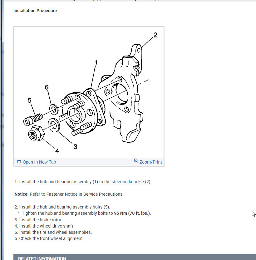

I have a right front wheel speed sensor that needs to be replaced
Jan 14, 2010 at 3:18 AM
Here are some guides that will help with this:
https://www.2carpros.com/articles/abs-wheel-speed-sensor-test
https://www.2carpros.com/articles/how-to-replace-an-abs-wheel-speed-sensor

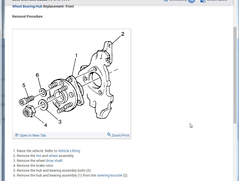

I attached below the the process from the manual that will help with this. We don't have a manual for this specific vehicle as it is not offered here in the USA but the process is from a similar vehicle.
Please run through this material and let us know if there are questions. Thanks
