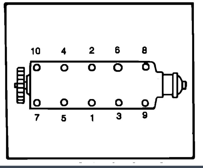

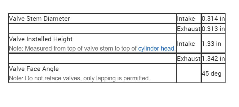

That's great. My suggestion to you would be to get the valve lapping tool, or a suction cup device into a drill and go about lapping them that way. I have included the valve seat and valve measurements in the diagrams below. I hope that this helps.

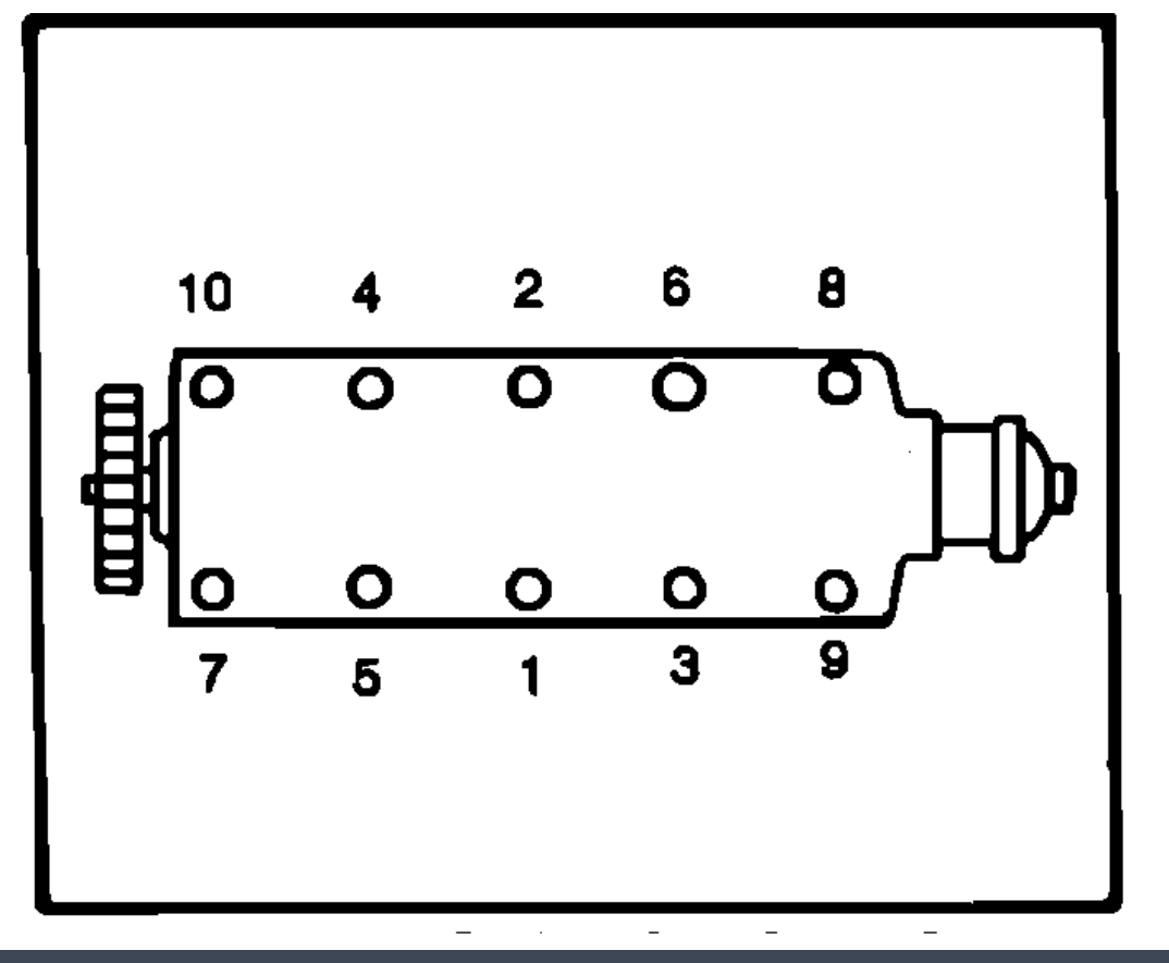

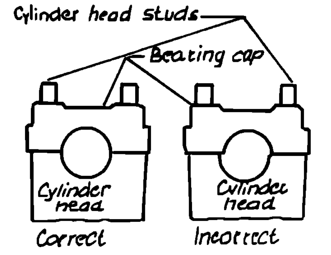

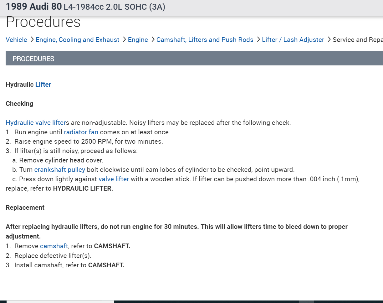

Well, today I decided to take the head apart and try to find the cause of this oddity. When I removed the camshaft the valves sealed tight against the seats and I even did the leak test to confirm that there was no leak, and sure enough there wasn't!
When I put the cam back in and tightened it properly, the valves once again developed this gap.
Feb 20, 2019 at 7:31 PM
SCGRANTURISMO
  • 4,897 POSTS
Hello again,

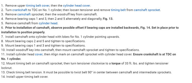

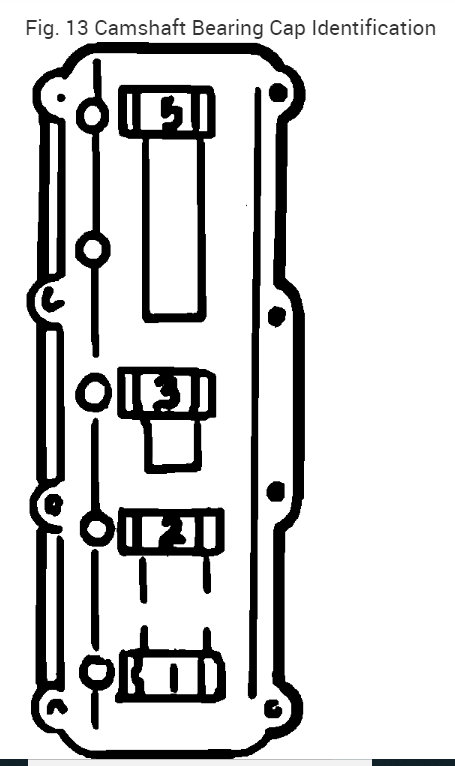

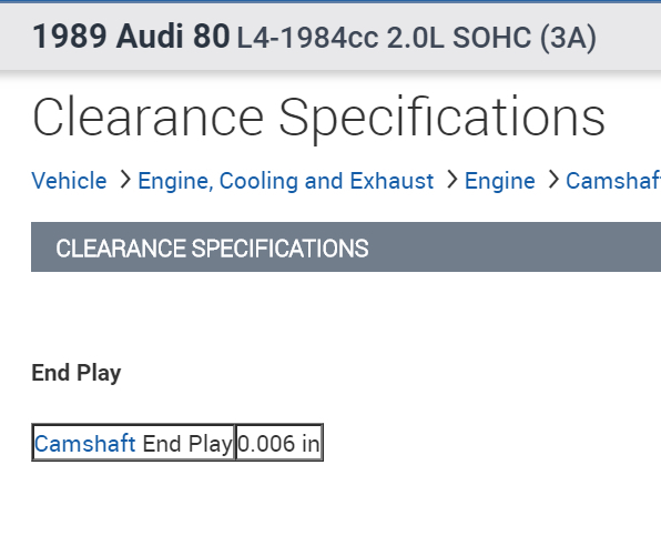

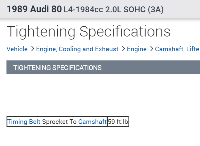

Do you have any worn camshaft bearings? I am including in the diagrams below troubleshooting, procedures, and specs for the cylinder head, camshaft, and lifters for your vehicle's cylinder head. Please go through them and let us know what you find out.
