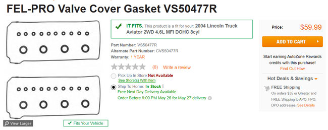

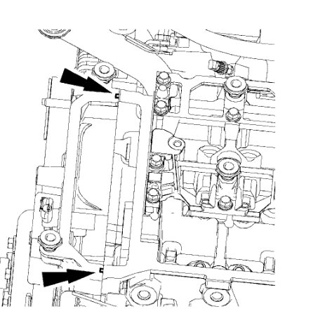

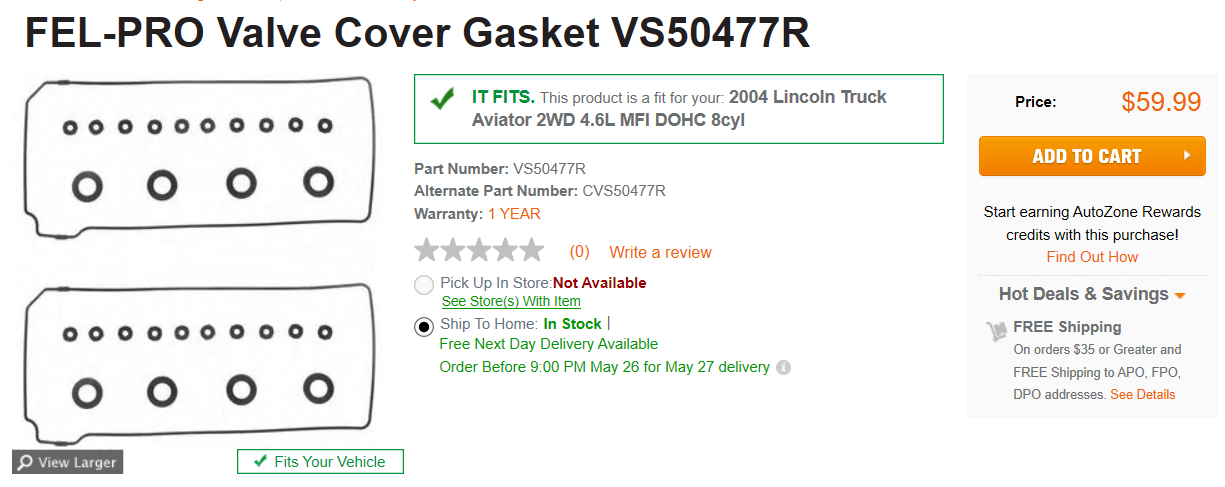

Probably some bad COP's and spark plugs from oil saturation?? At least 2 spark plug tubes had some oil inside, spark plugs were covered in oil and coil boots were saturated. Is this oil coming from bad/leaking spark plug tube seals and would replacing them fix my problem? Are the seals just at the top of the tubes and attached to the valve cover, or are there o-ring/seals at the bottom of the tubes also?

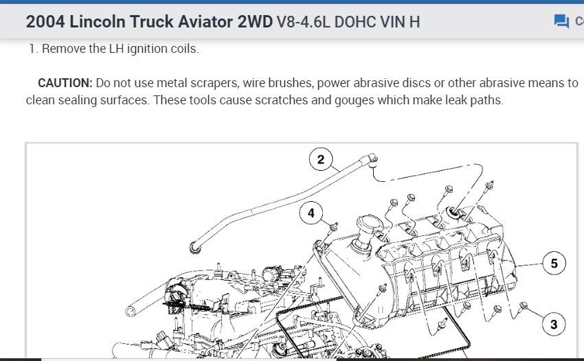

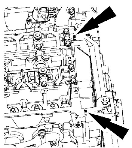

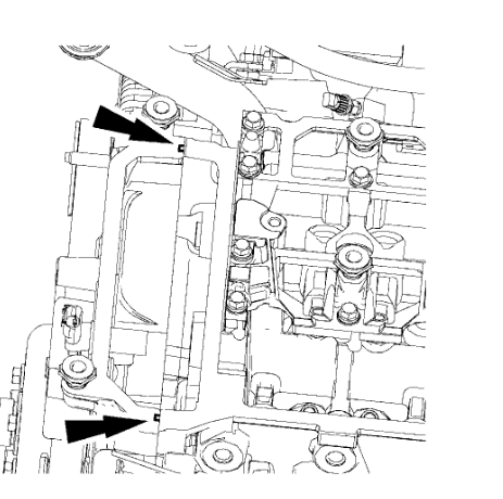

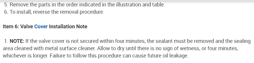

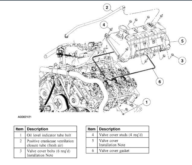

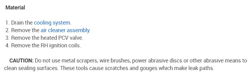

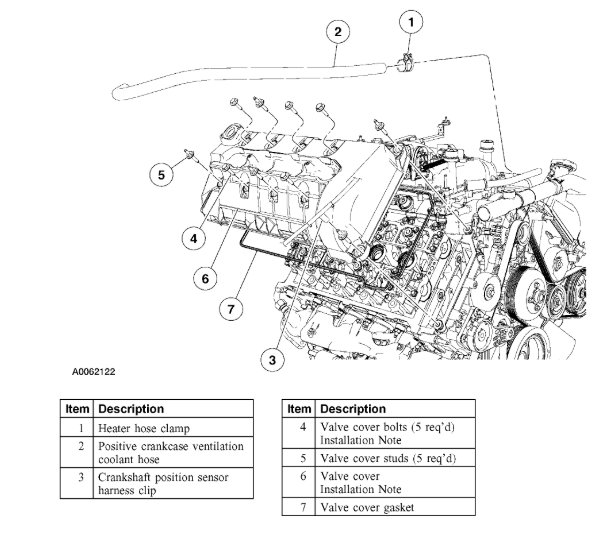

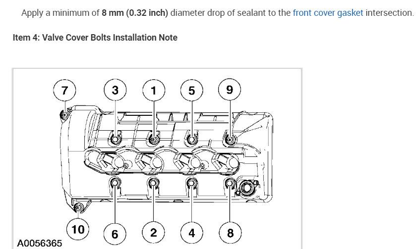

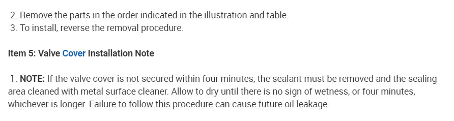

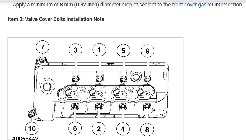

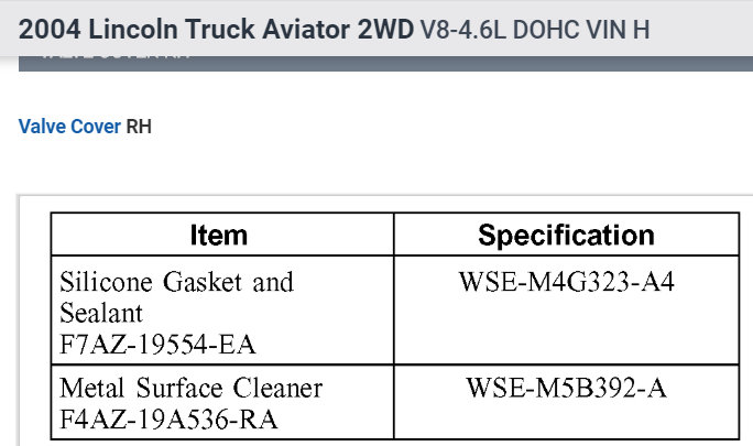

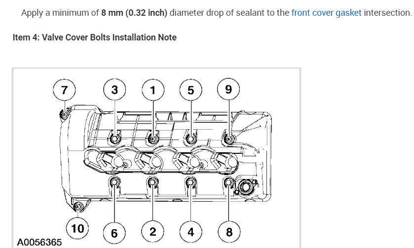

How do you replace these seals, and are they part of valve cover gasket replacement?
How do you replace valve cover gasket?
