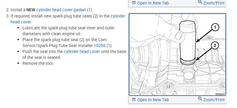

the center rings of the set are not going all the way in, they are too tight, how do i get them all the way if, is there a trick? do they have to go all the way in? the old ones seem to be.
the cover is plastic, so i don't want to hit it too hard and brake it.

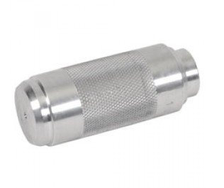

It is recommended to use a tube seal installer when putting the seals back in. This will help them go into the slot.
See picture below.
https://www.2carpros.com/articles/replace-valve-cover-gasket
