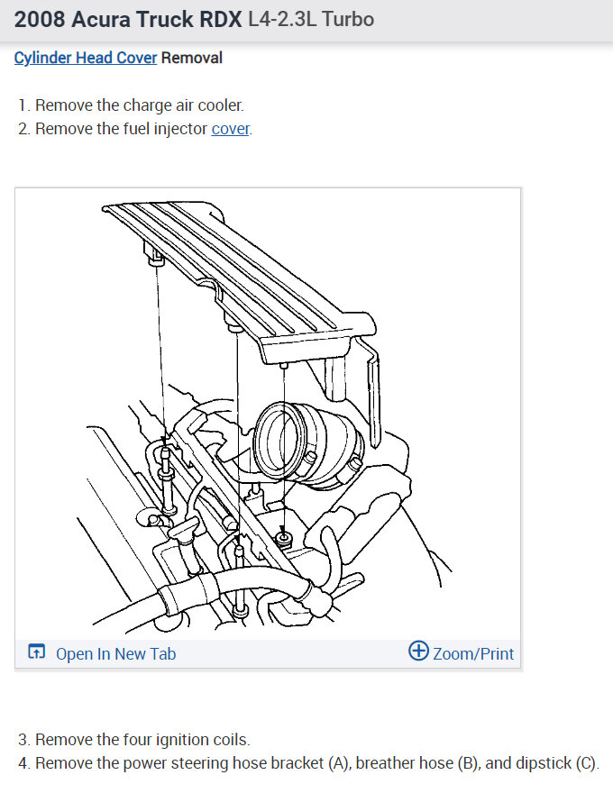

Do you have detailed instructions for gasket replacement?
80,000 MILES • 2.3L • 4 CYL • 4WD • AUTOMATIC
ALSCAMRY
  • 6 POSTS

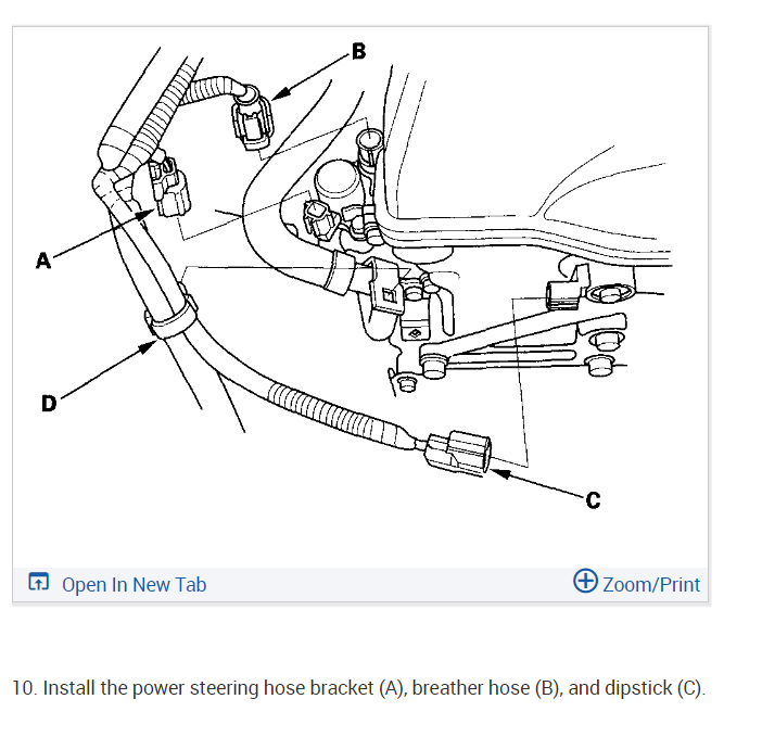

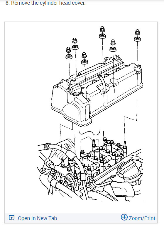

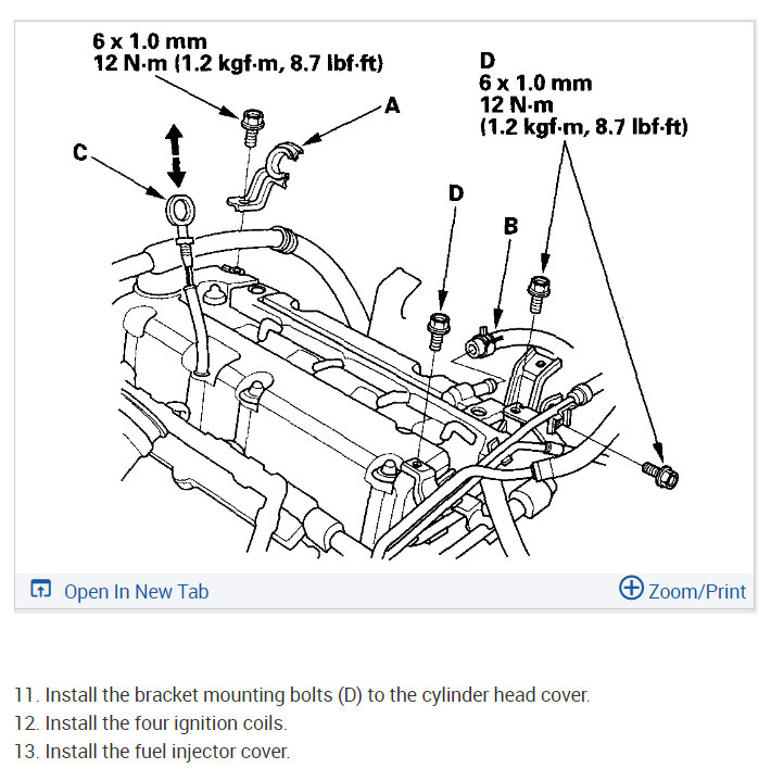

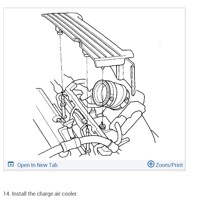

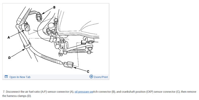

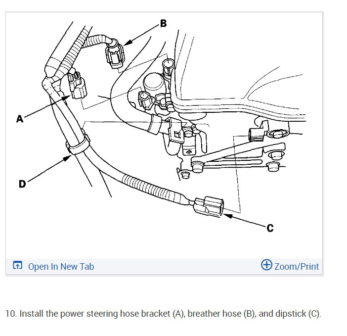

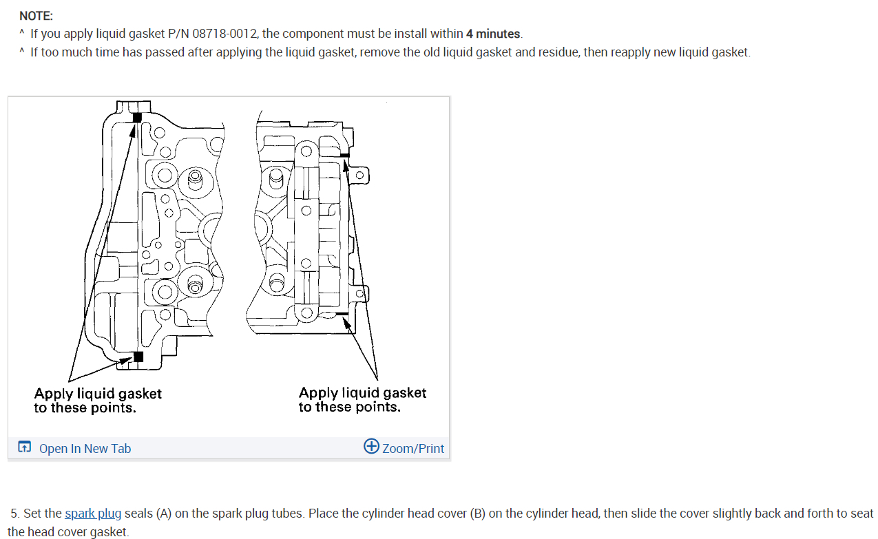

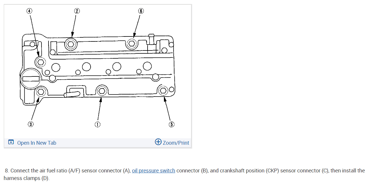

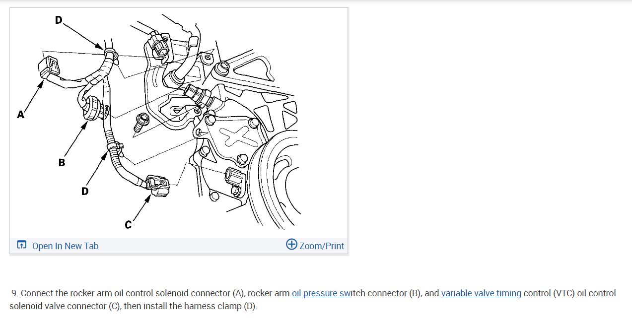

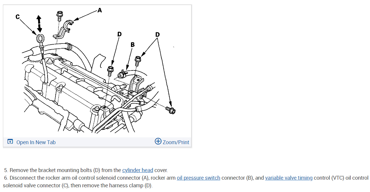

I am concerned about the intercooler removal and the electrical wiring over the valve cover.
Dec 30, 2023 at 4:53 AM
  • 55,694 POSTS

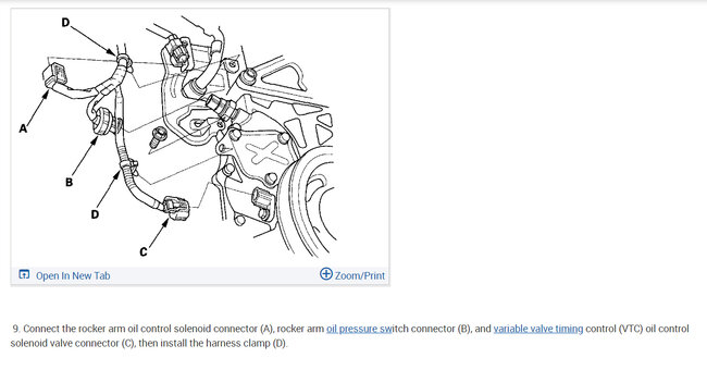

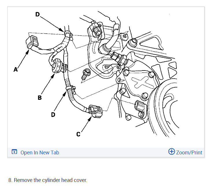

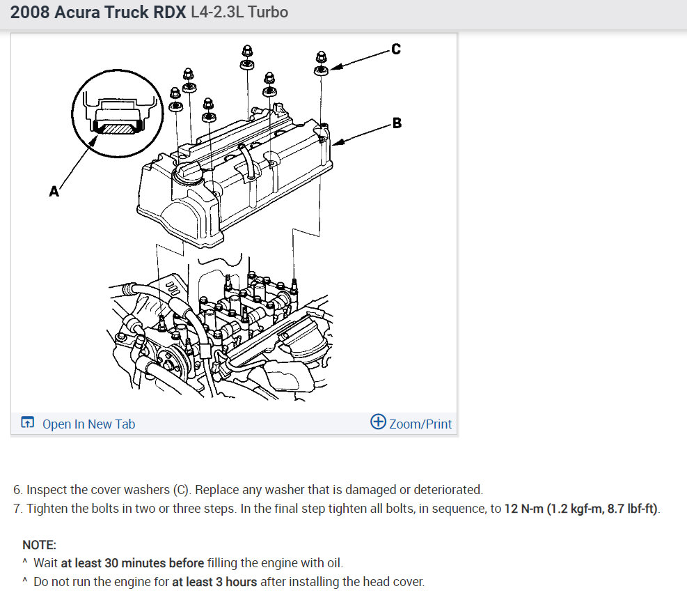

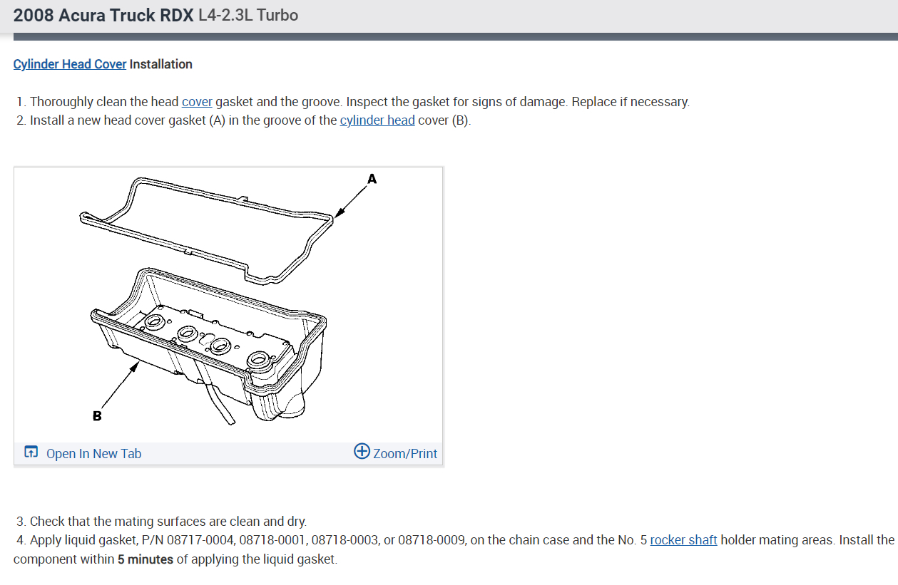

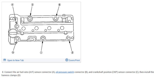

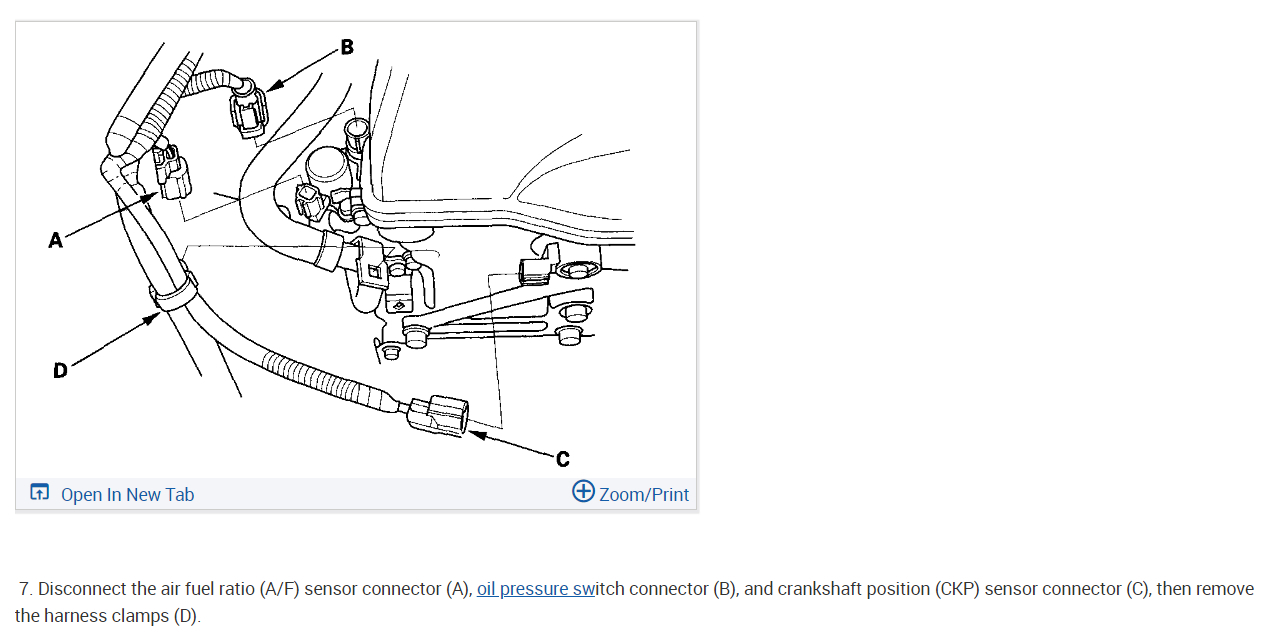

Good call, it does look like you will need to disconnect the engine wiring harness down at the front of the engine sensors. I would disconnect the negative side of the battery as well to avoid electrical problems. Here are the instructions which show what to do to change the valve cover gasket with torque specs as well. Check out the images (below). Let us know if you need anything else.
Dec 30, 2023 at 5:07 AM
ALSCAMRY
  • 6 POSTS
Thank you very much! I will review the diagrams and see if I can do it. My concern (as always) is reaching those electrical connectors way down in back of engine.
Dec 30, 2023 at 5:31 AM
  • 55,694 POSTS
Yep, they can be tough but take your time and just remove anything that gets in your way and you should be fine, upload images if you have a problem so I can help walk you through the repair.
Dec 31, 2023 at 5:38 AM
