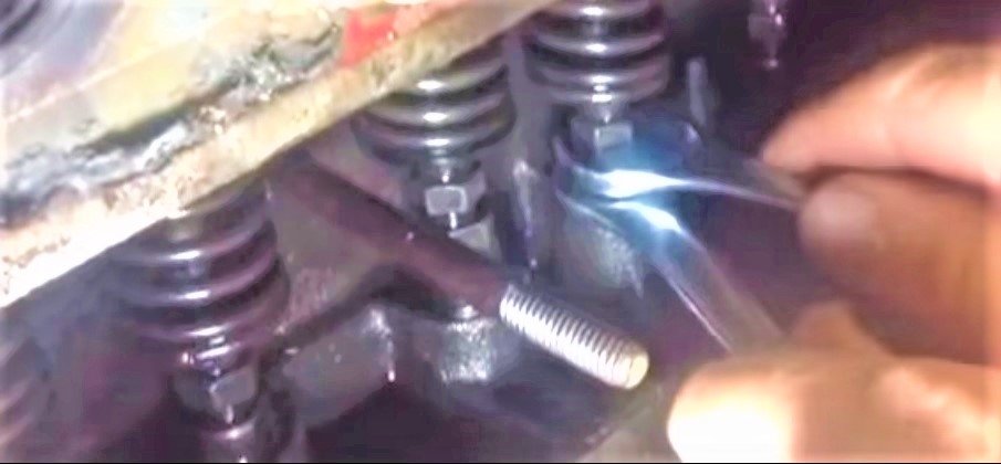

so I'm trying to adjust the valves on my 302 engine and when I built it, I did the 0-lash then 1/2 turn for "best results " but when I started her she runs really rough and will hardly idle(the motor will rock).
so I backed them all off and I'm trying to adjust them while it is running and I get her ticking then turn until it stops and it sounds okay until I do the other half turn to set it, then it starts idle rough and tries to shut off.
I don't know what to do help?

Thanks for the response! okay, so I think I get what you are saying. here is what I was told to do when I tightened down my rocker arms during my motor build. tighten them down until I cant spin them anymore (zero-lash) then for the "pre-load" do 1/2 turn more and that should be at the optimum performance for the cam and lifters I bought. they told me that this would keep it from tapping and from the valves hanging open. so I did all that correctly and it won't idle right just as if I tighten them all the way. about 1 hr ago i took off the intake and did the following procedure except I only did 1/4 turn after 0 lash and will find out tomorrow if that works. i bought this truck when i was 15 only had it 2 years now and just rebuilt it, still trying to figure out all the tips and tricks. if this doesn't work what do you think i should try?

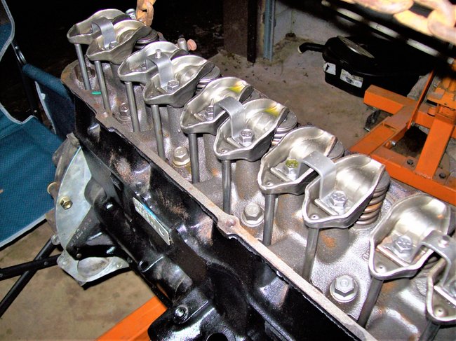

Why are we not just using solid lifters in the holes instead of those pesky self adjusting tappets that normally and automatically take the slack/ slop out of the system (so you don't periodically have to manually adjust them with two wrenches, as I have to do with my '46 Willys Jeep). Pic down yonder!

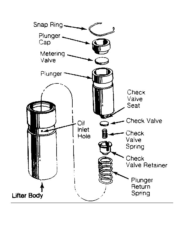

Think of the tappet (hydraulic lifter) as 5 gallon bucket with a 2 gallon bucket inside. The 2 gallon bucket is sitting on "bubble wrap".
If these are new (un-oiled/ engine not run) tappets and you tighten the rockers until there is no "give". Basically you have stepped into the 2 gallon bucket and shoved it to the bottom of the 5 gallon bucket, the bubble wrap is busted.
At this point you might say that you have a solid lifter per it's situation.
Right now you could say you are at rock bottom zero.
If you tighten the rocker any more, the valve will begin to open (as it should be 100% closed with the tappet "down") Open valves while it's running just ain't good at all!
Now that it has run, I'd get them (tappets) all down (one at a time) and adjust them one at a time.
Back the rockers out until the rocker and push rods are gapped apart. Run them back together until they just touch.
What we have now is "zero" with the tappet unable to adjust out any more to compensate for wear. (this is not what we want).
Tappets are not all the same as far as adjustments.
If you can/ even go to a parts store and measure the amount a plunger can push inward on a "Brand New" tappet exactly like yours.
This is a "make believe" number!
180 thousandths- plunge
I would rotate each rocker nut the number of threads equal to (make believe, lets say 5 revs) (120 thousandths). This would be 2/3s of the travel available, leaving 1/3 of the plunge unused.
It doesn't matter if there is oil in them. With the tappet "down" and the rocker completely having been backed completely out, the tappet's plunger should be all of the way up, before you tightened the additional (make believe) 5 threads.
Now when it is run, oil pressure will adjust everything as it should.
You now will have 2/3 of whatever travel to automatically adjust the system.
