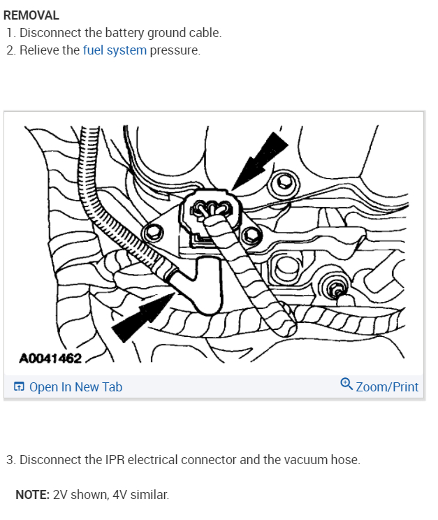

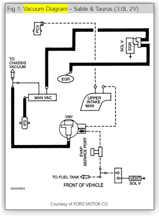

Took off fuel rail sensor confused about where the vacuum line comes from and goes to. Also, I have a red and yellow small plastic tube where do they hook up to? They are attached to intake manifold where do they go? Where does the vacuum line from the EGR valve come from? Thank you
Mar 8, 2022 at 11:10 AM
  • 55,433 POSTS
Here is the vacuum line diagrams for your car, check out the diagrams (below). Let us know what happens and please upload pictures or videos of the problem..........................
