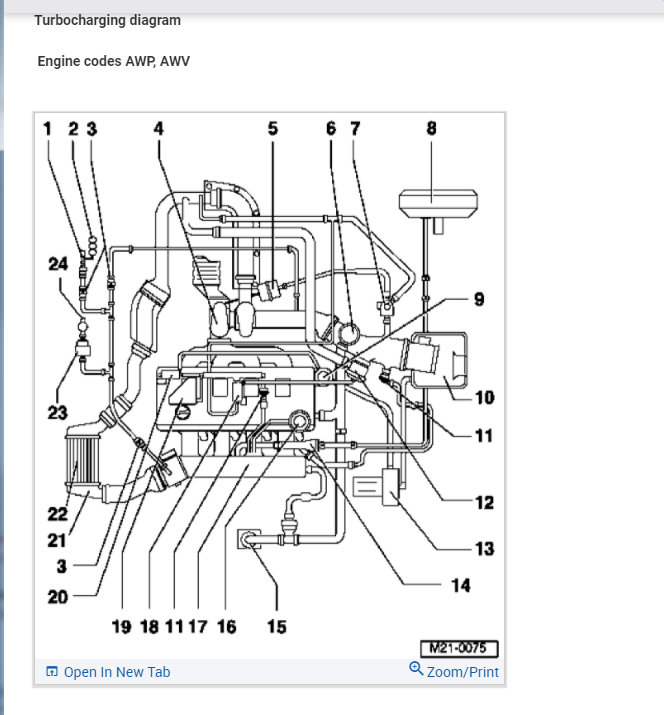

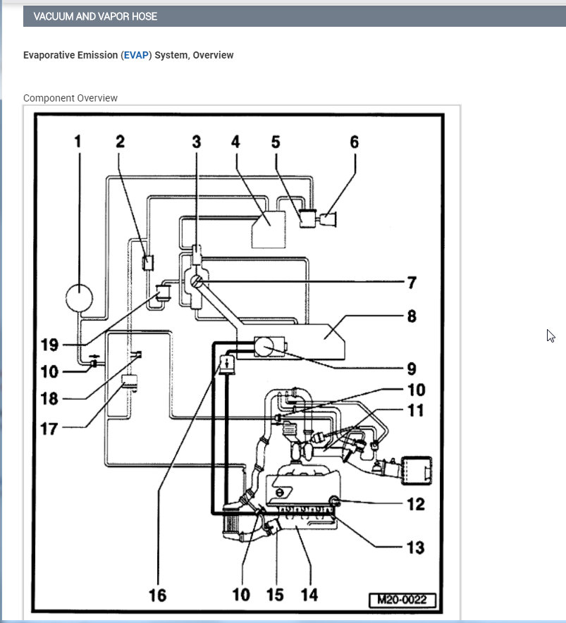

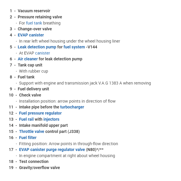

Vacuum line diagram needed.
Aug 25, 2020 at 10:28 PM

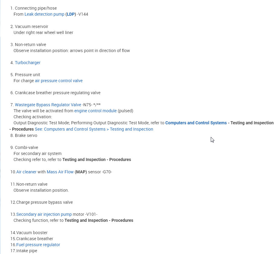

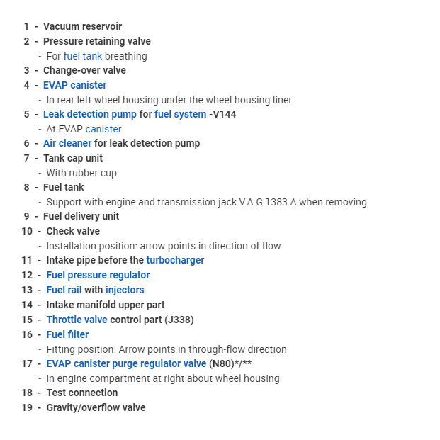

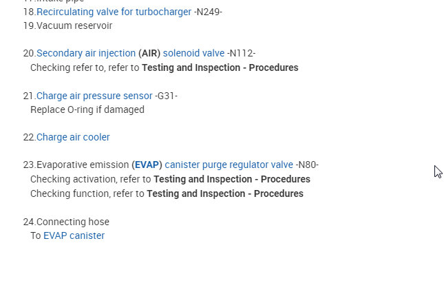

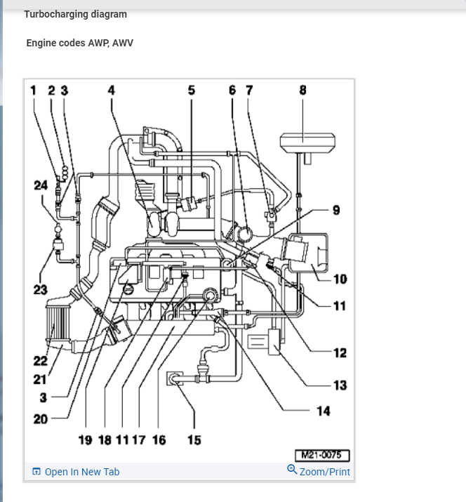

I suspect the issue is with the P1297 - Connection Turbocharger - Throttle Valve Pressure Hose. I attached the vacuum hose and turbocharger diagrams for your inspection. I would recommend using some brake cleaner and spray it around these hoses and listen for the RPM to raise and that should help locate where the leak it.
Here is a guide that will help with that. Let us know what you find. Thanks
https://www.2carpros.com/articles/repair-lean-mixture-codes-p0171-or-p0174-on-some-manufacturers
