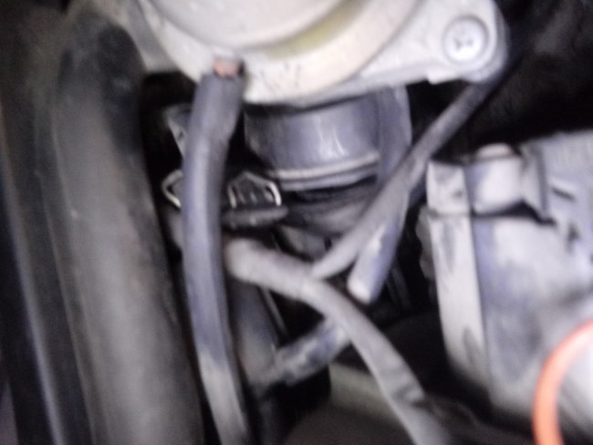

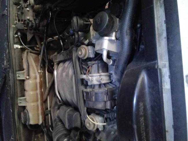

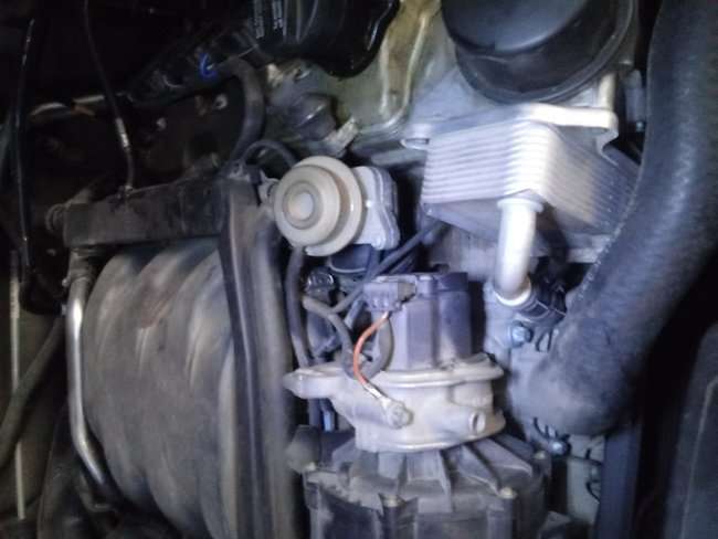

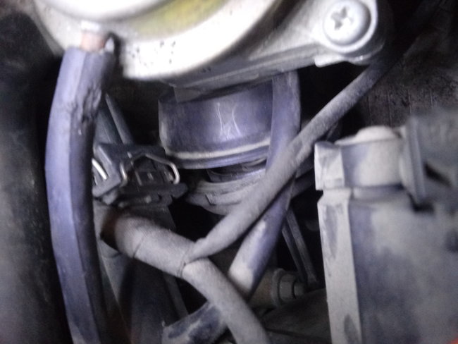

I see a broken part but don't know what it is. I was no where near it either to break it. Please please please help.. Urgent. I have to try to fix by tomorrow. Have to move by Friday. Thank. You. It is that little black thing. (Obviously with all the pictures) Again, thank you for your help!

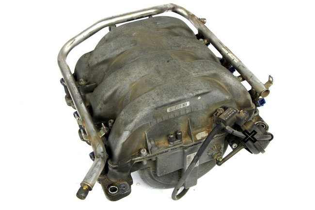

That is a variable intake manifold switch-over valve. it's responsible for changing the length of the intake runners during higher rpm's for increased engine performance. If you are in a pinch you can just block off the vacuum line that goes to this valve with a golf tee, bolt, or anything that will fit in the vacuum hose for that matter. If you have trouble disconnecting the line to the valve just cut it in half, you can repair that later, and plug it there.

The black thing looks like it has come apart, which they do when they become brittle. Originally they just snap together and have a vacuum diaphragm inside of it. You can cut that hose that I put an X on in the picture I sent and it should stop the vacuum leak, the check engine light will come on but the engine will not break down or anything. Safe travels.

Below my first response is an image of an engine, just click on it. You're very welcome!
