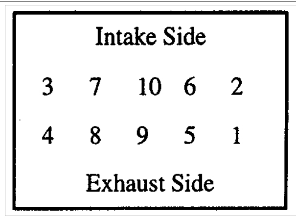

so i just performed a compression check; cylinder number. 1=135, number 2=0, number 3=0, number 4=140.
Mar 28, 2018 at 2:06 PM

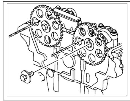

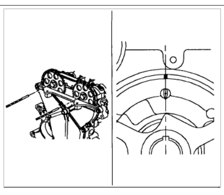

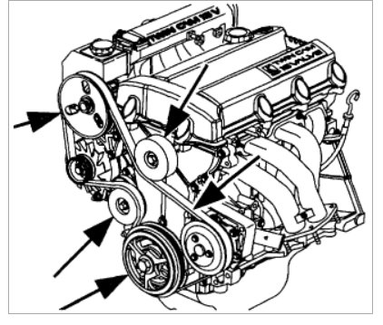

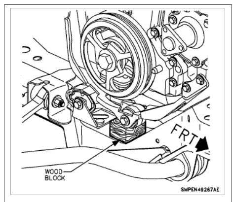

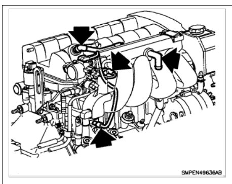

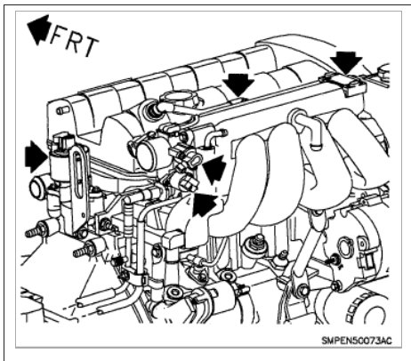

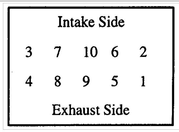

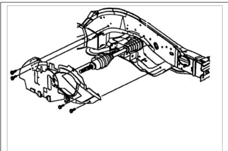

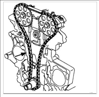

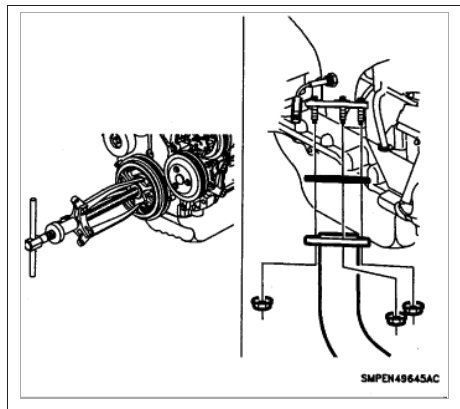

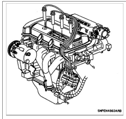

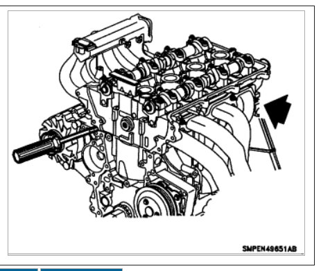

  • 55,224 POSTS

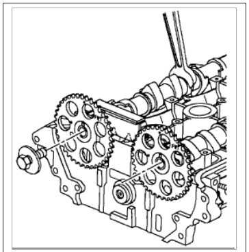

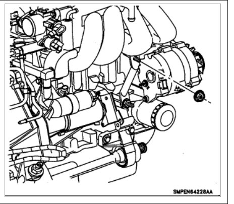

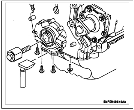

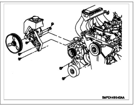

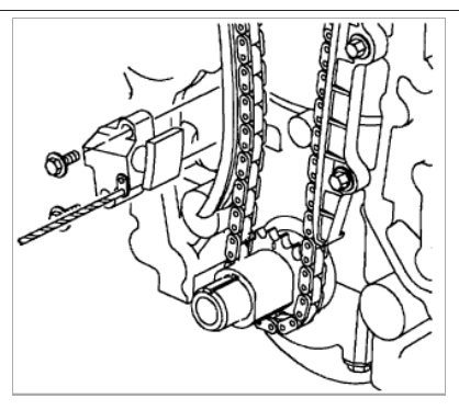

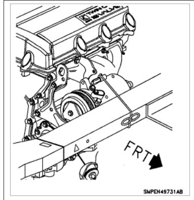

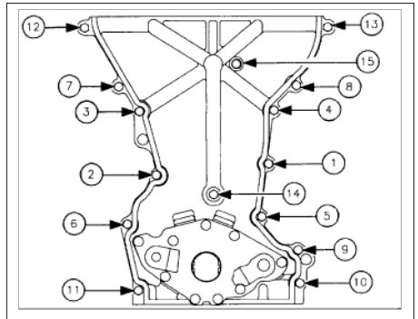

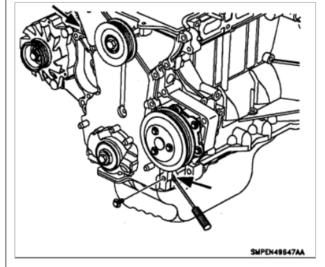

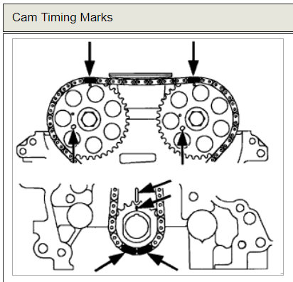

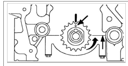

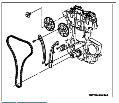

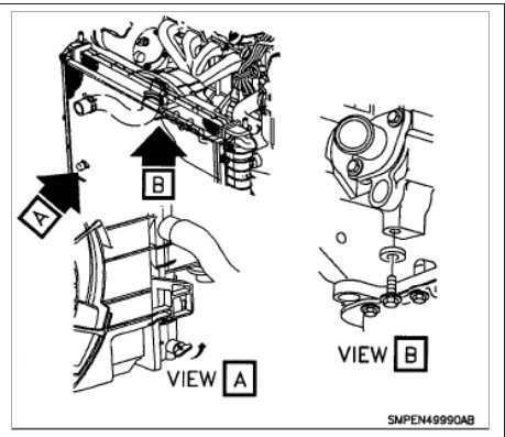

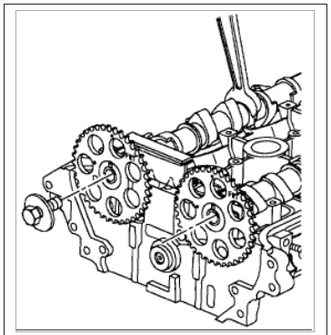

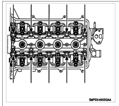

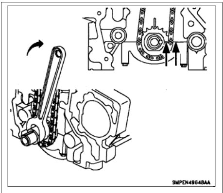

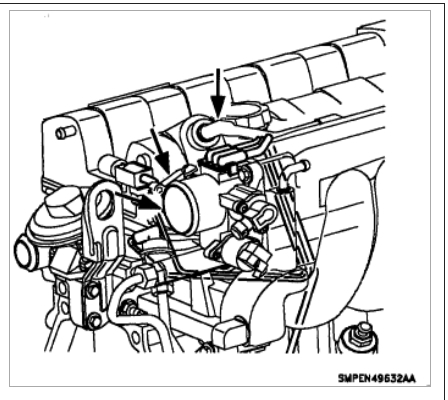

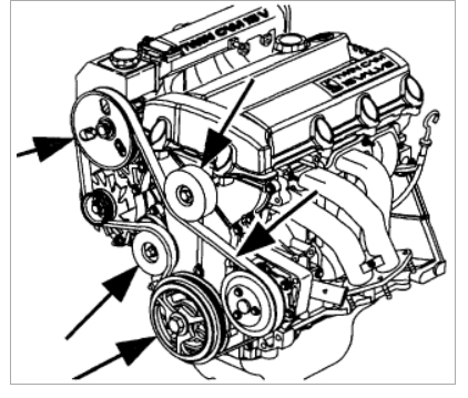

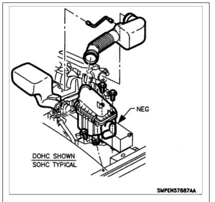

Yep, nice work it looks like you may have a blown head gasket between two cylinders which is common.

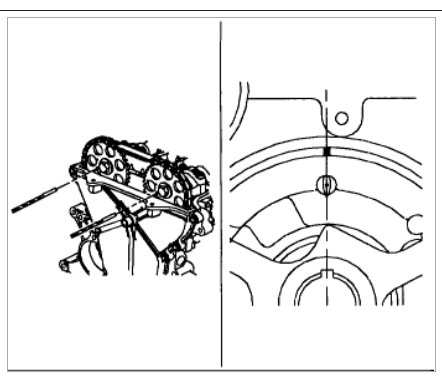

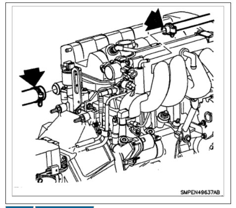

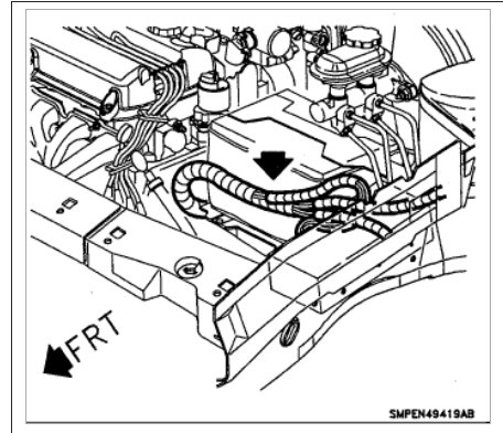

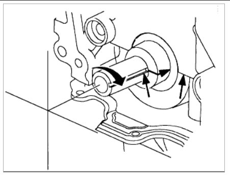

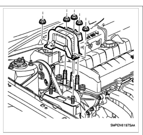

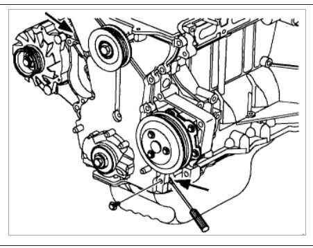

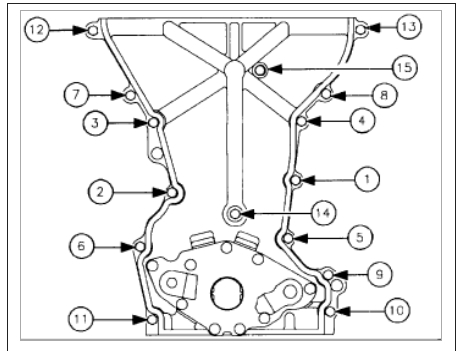

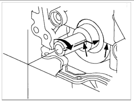

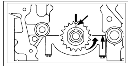

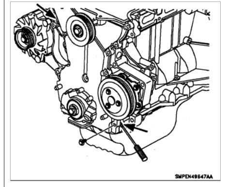

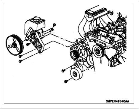

Looks like we are removing the cylinder head. You will need to remove the front harmonic balancer.
https://www.2carpros.com/articles/how-a-harmonic-balancer-works
Here are the diagrams to show you the job you are in for (below).

Could be but the head still needs to come off. Please take video or pics of the problem when you get it apart.
