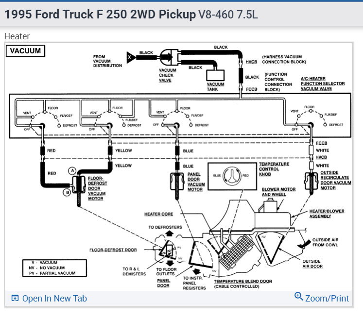

complete under-hood vacuum line system diagram needed?
1995 FORD F-250
341,000 MILES • 7.5L • V8 • 4WD • AUTOMATIC
QUADRACER777

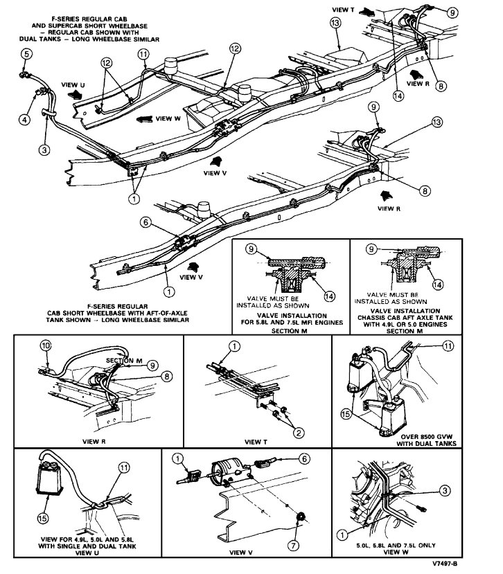

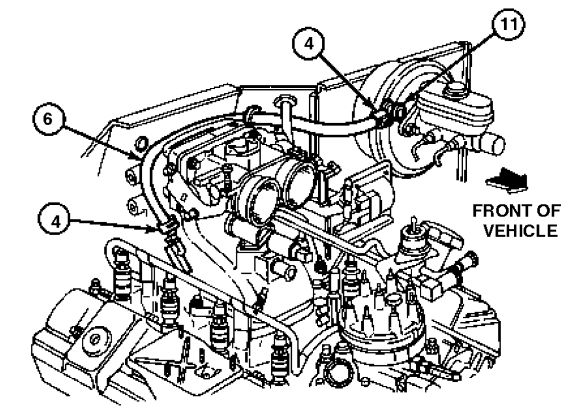

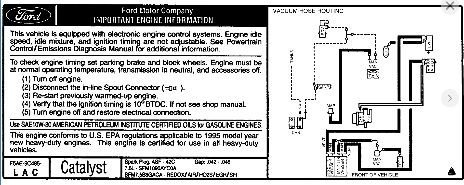

I am nearing the end of a project and cannot find a comprehensive diagram of the complete under-hood vacuum line system. Also, there is an opening in the A/C blower motor that I cannot for the life of me remember what it connects to. Some images attached.

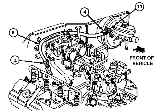

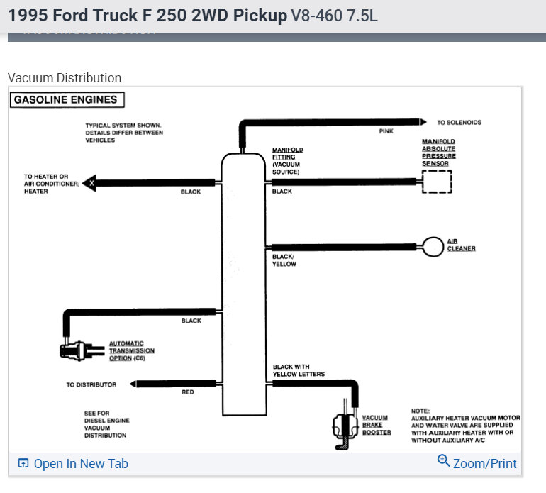

I don't see an image? Here are all of the vacuum line diagrams as requested. Check out the images (below). Please let us know if you need anything else to get the problem fixed.
