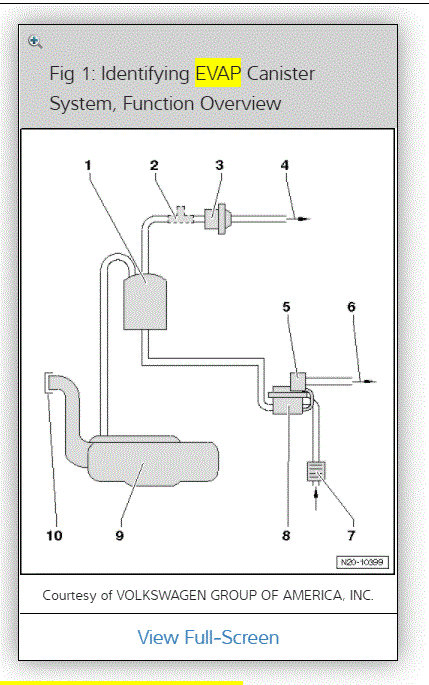

Can you send me a diagram of the vacuum system?
Dec 16, 2021 at 2:22 PM
  • 110,194 POSTS

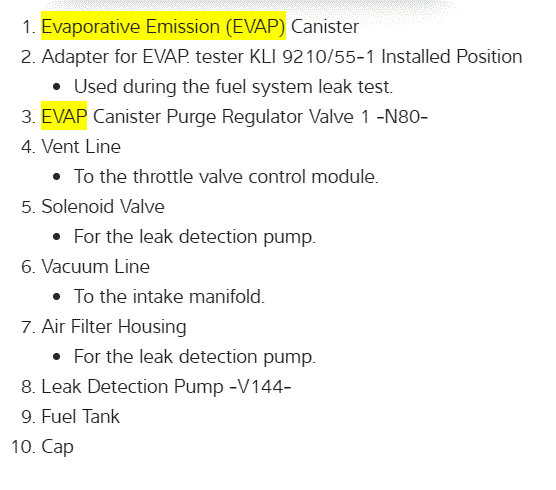

I just responded to the other post you had. The manual doesn't have a vacuum schematic provided. I was able to find one more for the canister that also shows where other hoses run. Take a look and let me know if it helps.
Also, let me know if this is a 4wd vehicle.
