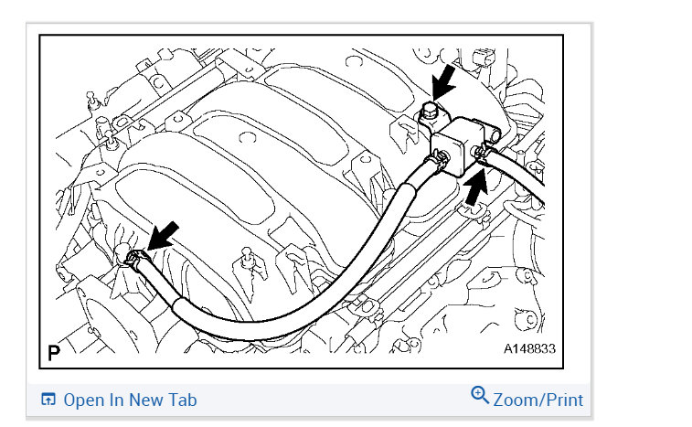

Intake Runner Controller vacuum line missing.
Aug 22, 2022 at 8:40 AM
AL514
  • 5,587 POSTS

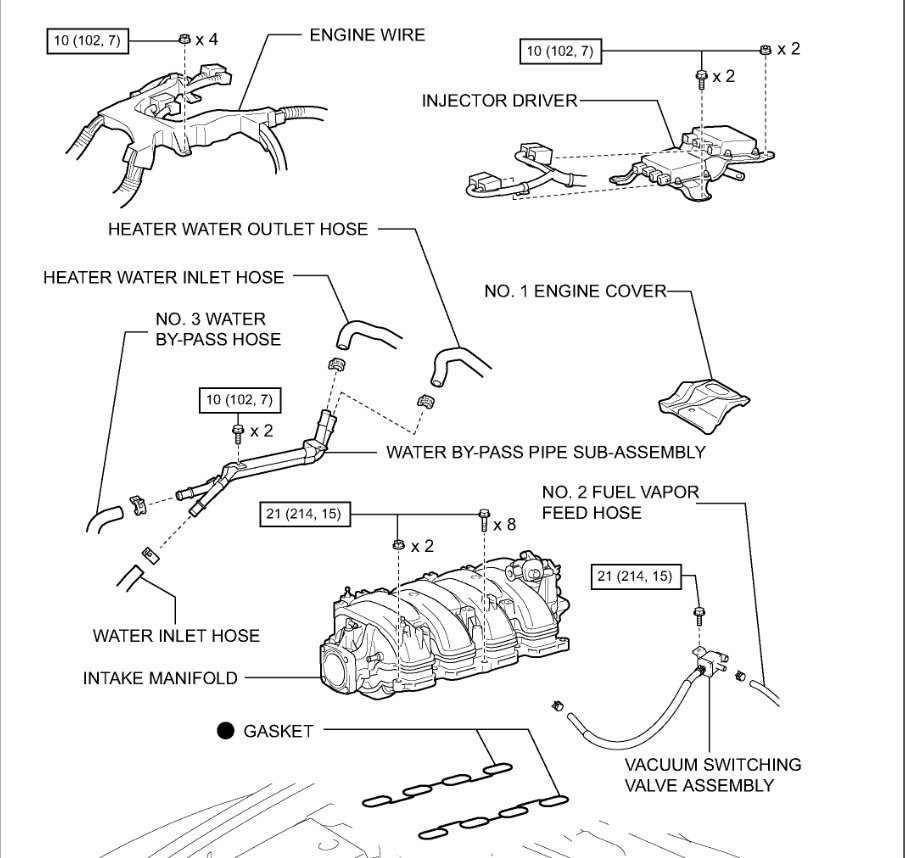

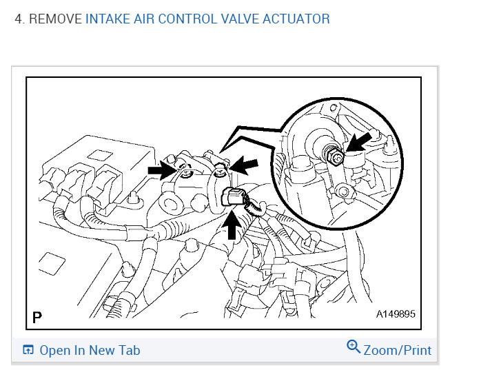

Hello, in the first diagram, is that the vacuum line you're referring to? The second is the entire Intake manifold assembly, and for the LS460 it looks like there are Intake air control valve actuators (variable Inductance Control valve), but they are electronically controlled. I don't see any runner controllers that are vacuum actuated. Or if you could take a picture. Is there a solenoid that's missing a vacuum line to it?
