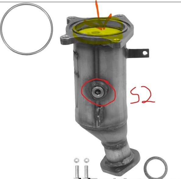

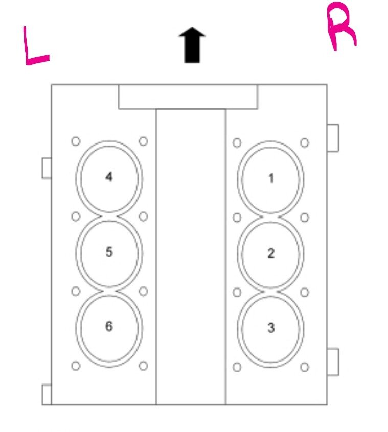

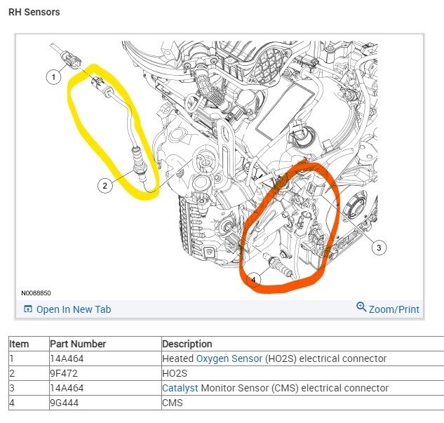

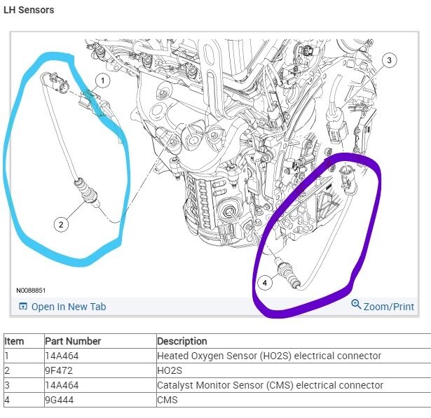

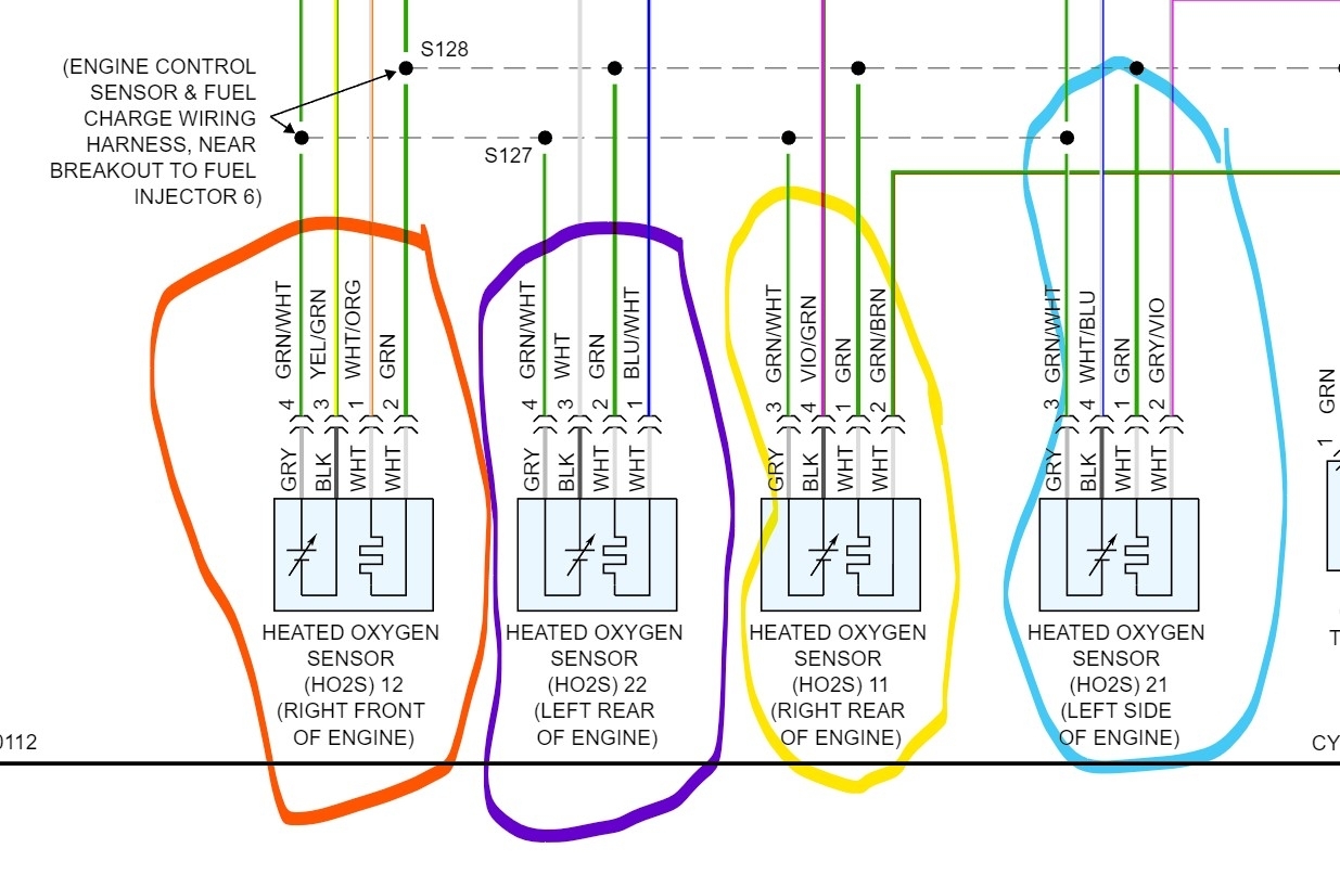

It's highly unlikely that it's a sensor but on that engine, you have the upstream sensors that are in the exhaust manifolds, then the converters that bolt to the manifolds. The downstream sensors are the ones that are in the sides of the converters. For the locations I attached the wiring and locations. The B1 S2 sensor is the one on the side of the converter on the right side of the engine with the orange circle, which would be the rear bank next to the firewall. However, given the cost of a replacement converter you will want to test the sensor(s) first. To do that you connect up the scan tool and watch the voltage that the O2 sensors are showing when you compare the upstream and downstream sensors show. A P0420 code generally means that the downstream sensor's voltage is following the upstream sensor. That would show on the scan tool as the voltages rising and falling together when a good converter would show the upstream sensor changing a lot while the downstream sensor barely changes. Easy to see with a scan tool.

I have seen videos on there showing perpetual motion, free energy, and how to make millions by helping out a prince. Doesn't mean they are actually true. As I said I have never seen that method actually work and I know folks who have tried it after watching folks like Scotty say it works. The problem is that it might work if the converter is only coated with loose soot or if it's from fuel saturation, but most are not in those categories, usually the contaminate is hard baked on like a nonstick coating or if there was the right mix of fuel in that they will have physical damage from the substrate overheating and melting. You can check the one on yours easily enough. The converter unbolts from the manifold, and you can look at the top layer right there in front of you. That is how you replace them on that engine.
The sensor goes in the side as shown, the substrate is at the top in the opening.
