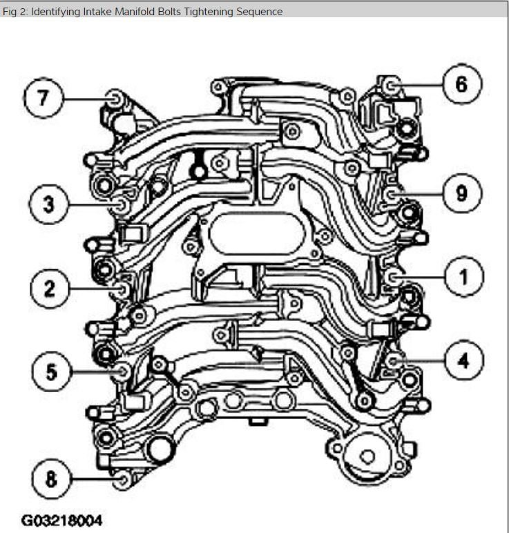

I need to know the torque specs and tightening sequence for the upper intake/plenum on my car?

I assume you meant to say 4.6l. Here are the sequence and torque of bolts. Check out the diagrams (Below). Please let us know if you need anything else to get the problem fixed.
