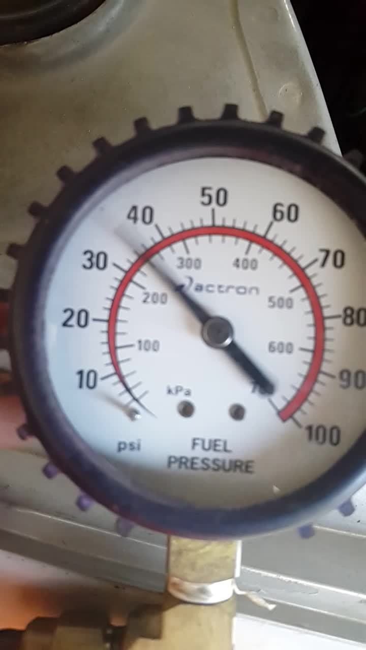

Hi, I have problems in terms of performance, loss of power of my car, checking the fuel pressure I find unstable. The residual pressure after five minutes is approximately 17 psi.

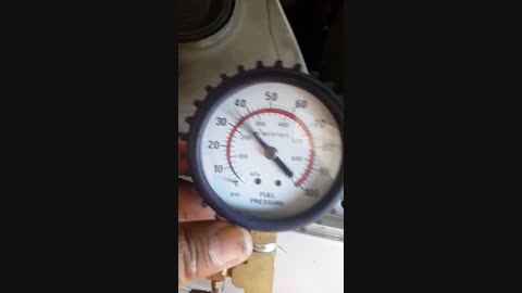

With the FP and + B jumper, it gives 44 psi. Engine started, with vacuum hose disconnected, also 44 psi (here I can notice only certain vibrations in the manometer needle).
Apr 25, 2019 at 7:24 AM
What about the pressure without the jumper?
Apr 25, 2019 at 7:39 AM
MARIOC68
  • 120 POSTS
I already described it. Without the jumper, vacuum hose disconnected, 44 psi. Without the jumper, with the hose connected, erratic reading, which shows the video.
Apr 25, 2019 at 7:45 AM
Got it. I saw the video. If it does not vary with the hose off, that is good.
If it varies only with the hose connected then it looks like the regulator itself is the issue.
Apr 25, 2019 at 7:56 AM
MARIOC68
  • 120 POSTS

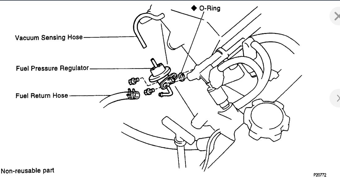

Is there any way to verify or test the fuel pressure regulator, if this is the culprit?
Apr 25, 2019 at 8:18 AM
If you have stable pressure with it disconnected and fluctuating with it connected, then the only thing is the regulator.
Is the vacuum strong at the regulator hose?

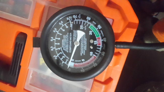

Perform a couple of vacuum tests on the intake manifold. Use two different gauges, both indicate 20 inch hg. But one with very slight fluctuation, almost imperceptible; with the other tool the fuctuacion is greater, as indicated by the fuel manometer. The two tools of different brand.
Apr 26, 2019 at 9:39 AM
MARIOC68
  • 120 POSTS
this tool, erratic readings with a lot of variation.
Apr 26, 2019 at 9:41 AM
For that to cause it the fluctuation would have to be drastic.
You need a regulator.

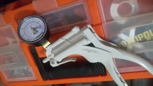

Does it hold vacuum when you pump it up with the engine off?
Apr 26, 2019 at 9:43 AM
MARIOC68
  • 120 POSTS
with this the reading is much more stable.
Apr 26, 2019 at 9:44 AM
MARIOC68
  • 120 POSTS
perform a vacuum test only on the regulator (with engine off), connecting the vacuum gun to the regulator. The vacuum is maintained, reaching a maximum of 25 inch Hg.
Apr 26, 2019 at 9:49 AM
Okay, then you need a regulator.

Excuse me, how much should the regulator admit of empty when it is in good condition?
Apr 26, 2019 at 11:00 AM
It does not empty. It limits. It maintains a certain predetermined pressure.
