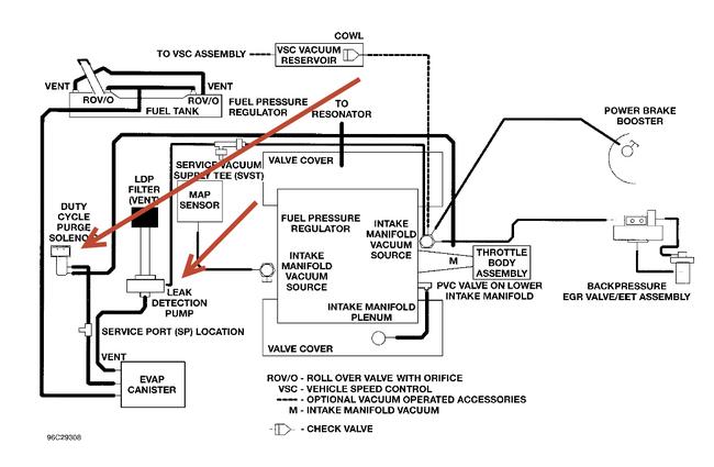

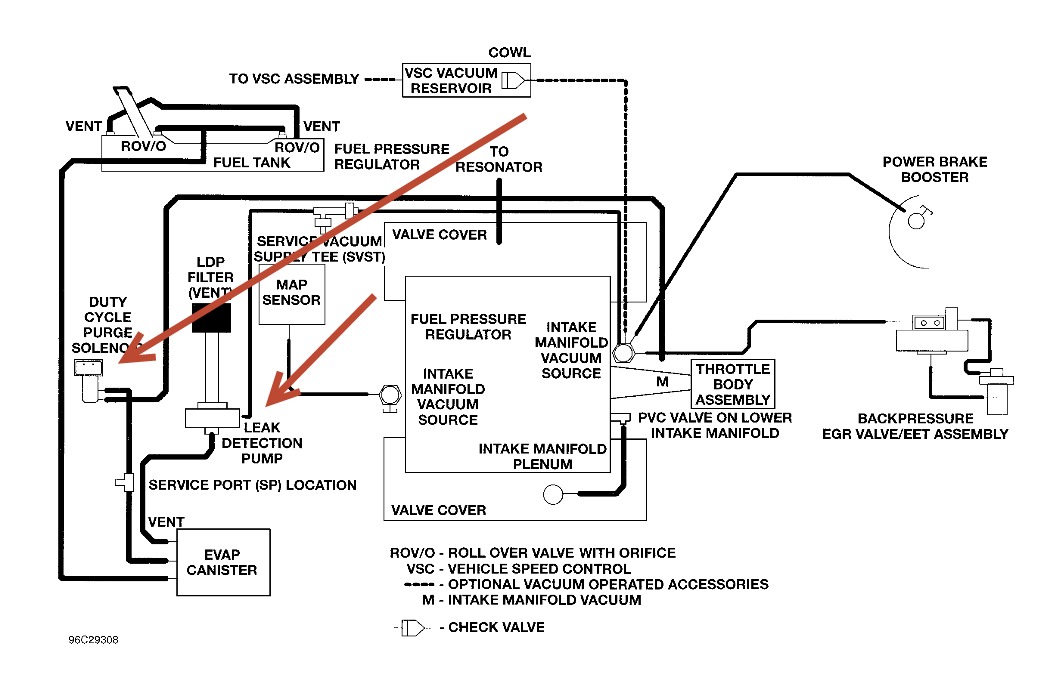

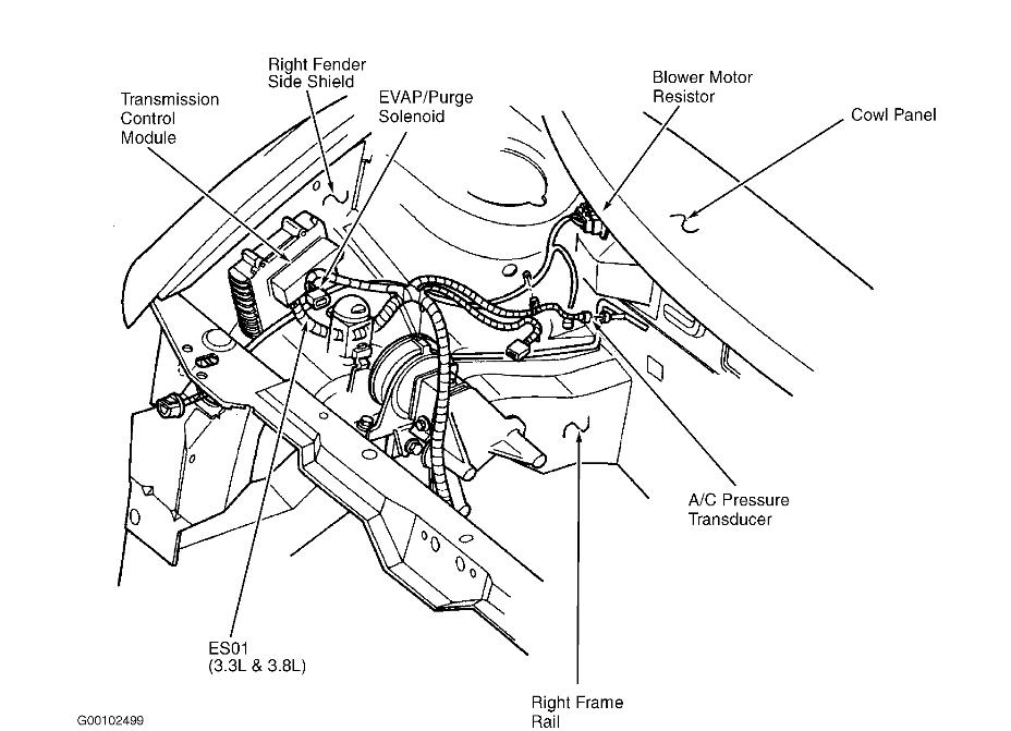

HMAC300
  • 48,601 POSTS
the throttle platejust follow the air tube from air cleaner to engine remove the duct work and you'll see it. ok in the drawing I've sent there is a thing called a purge solenoid. at idle it should have vacuum on one side only. if it is comeing out both sides then the solenoid is staying open and your car won't idle to good. all you need do is to see if vacuum is coming out of both sides or if a one piece hose at solenoid block off vacuum and see if it straightens out if it does then the solenoid is bad and needs to be replaced. also the other other thing I've pointed to may do the same but not sure if your car has that or not and whether it would actually cause the problem. Other than that I don't know what to tell you.
Jul 4, 2013 at 8:25 AM

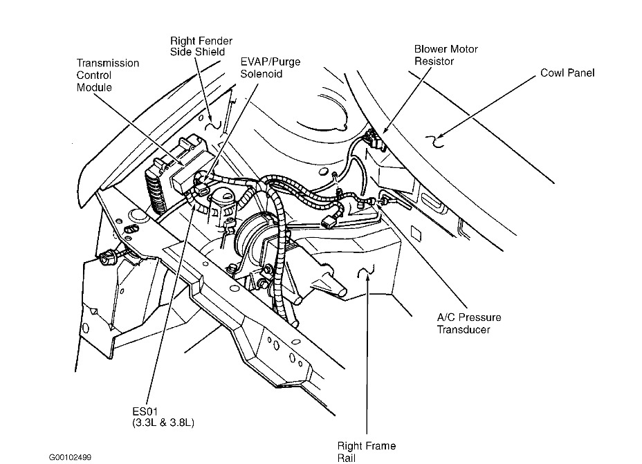

  • 48,601 POSTS
ya know I don't know if you have missed this or not but have you checked the purge valve solenoid and the other parts I sent in the two drawings? I still see no reply on that. even though you replaced the crank sensor the CONNECTOR does go bad and will shut the vehicle off that is why I said to do a wiggle test on it.
