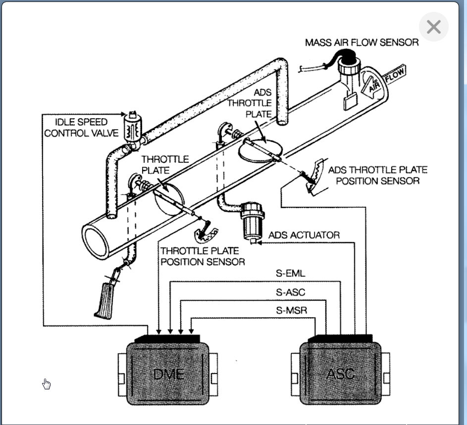

Actually the car is accelerating but the speed is going up at a normal rate. For the driver though she said she is comfortable to drive with it but i am pretty sure she is riding the brakes.
How does it occur this high idle?i guess it has the similarities of stuck gas pedal right?
Mar 1, 2021 at 6:46 PM
Here is a guide that will help with high idle in general:
https://www.2carpros.com/articles/engine-idles-too-high
The idea could be the same as a stuck pedal but it is unlikely to be the issue unless the throttle cable is sticking.
However, the idea is the idle is high due to extra air or fuel entering the engine raising the idle. Or the idle control is not correct. On this vehicle it appears the DME controls the idle control valve. Usually when these fail the engine will stall as they stick closed.
https://www.2carpros.com/articles/idle-air-control-valve-service
I attached the info below on this which should illustrate this better.
