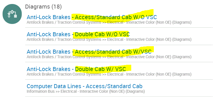

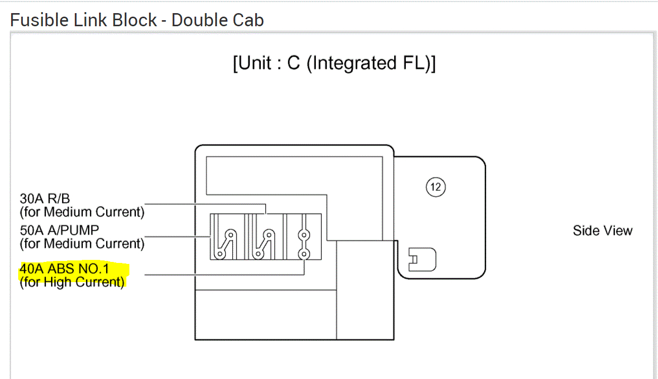

You know, I had another quick test for you to try. If you remove the ABS fuses from the vehicle, it will turn off the ABS. You will still have standard (non-abs) brakes. That would tell us if what you hear is coming from the ABS.
I thought it would be easy to identify the fuse, but as expected, it isn't. LOL I need to know if you have a crew cab, if the vehicle has stability control, if it is a regular cab, and so on. The fuses are all in different locations based on the vehicle.
If you look at the attached pic below, it identifies the options. If you want to try this, let me know which one you have and I'll be able to look up the correct information.
See pic below.
May 23, 2021 at 7:32 PM
NOTRICH
  • 7 POSTS
This is a 2006 Toyota Tundra Crew Cab SR5, 4.7L engine, 2WD, disk brakes on front, drum brakes on rear, no stability control.

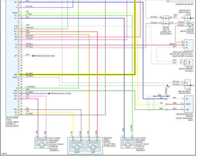

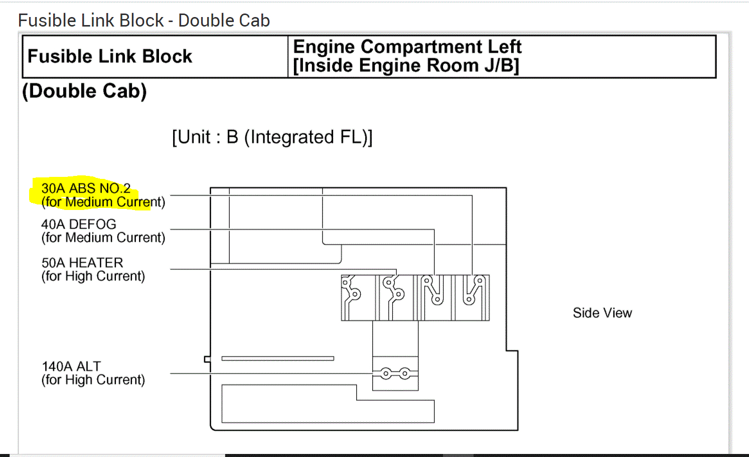

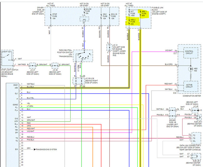

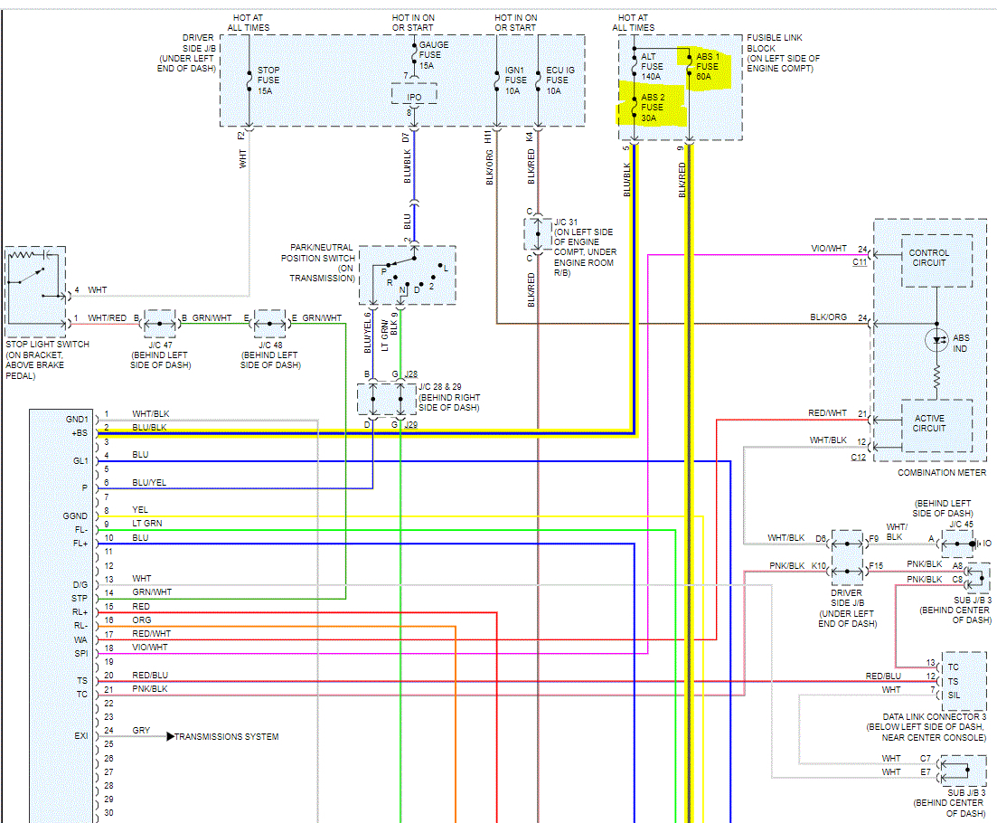

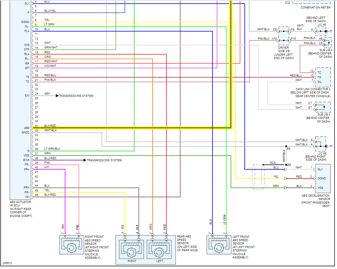

I found it, but it is a fusible link and not a traditional fuse. It is in the fusible link box under the hood. It won't be something that can easily be removed.
I attached the wiring schematic for this vehicle's ABS system. I highlighted the power supplies to the ABS and added the pics of the fusible link.

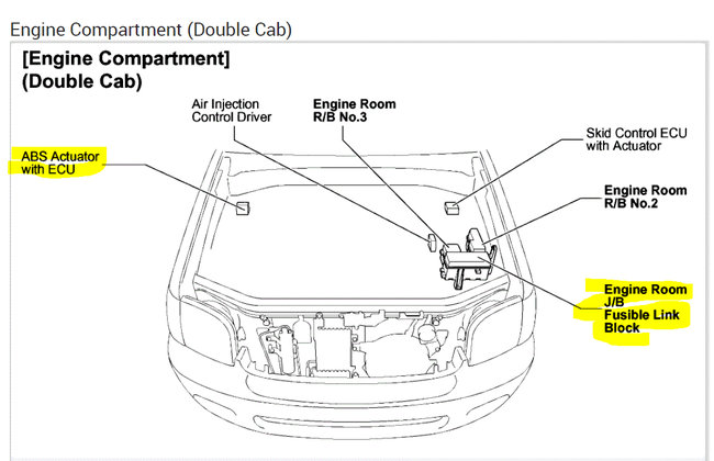

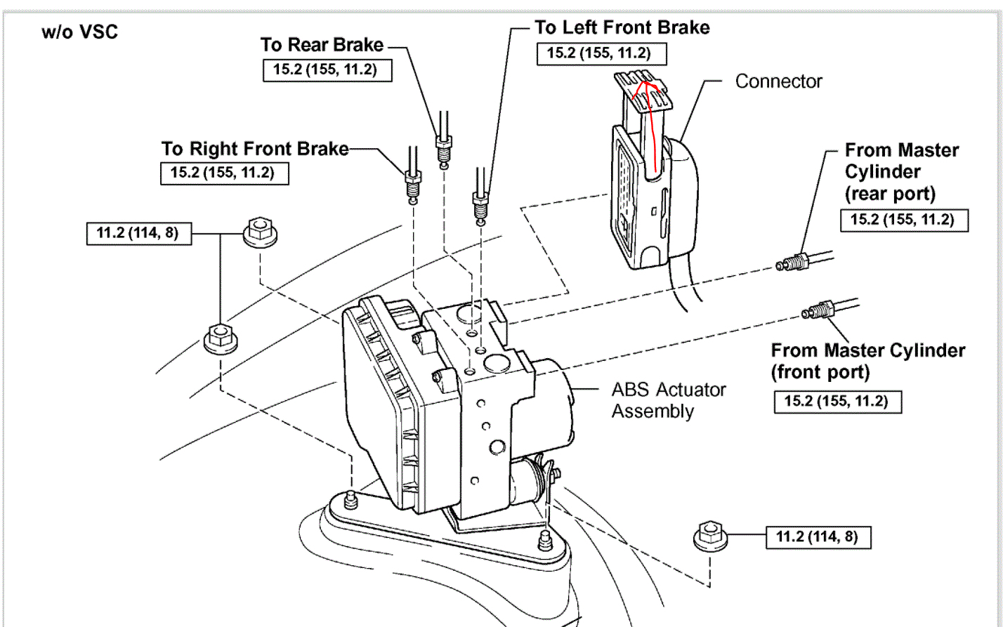

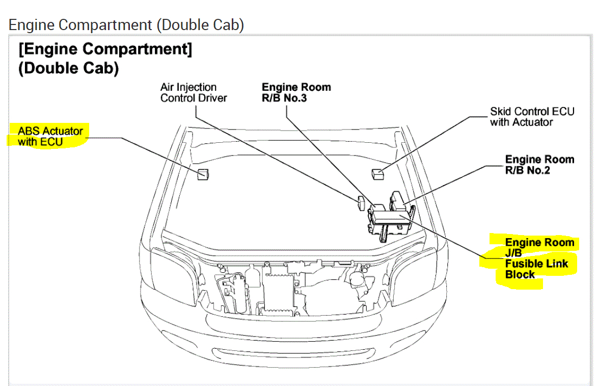

I have to be honest. It would likely be easier to disconnect the ABS actuator to see what happens. It will set the ABS light on until it's reconnected.
The actuator is under the hood on the passenger side of the vehicle. There is a cover over it. You will need to remove the cover to access it.
If you look at pic 4, it shows the location of the actuator. Pic 5 shows the actuator and the connector. There is a slide that you move upward and then the connector will come off.
If you still want to try this, you can pick which you feel more comfortable doing.

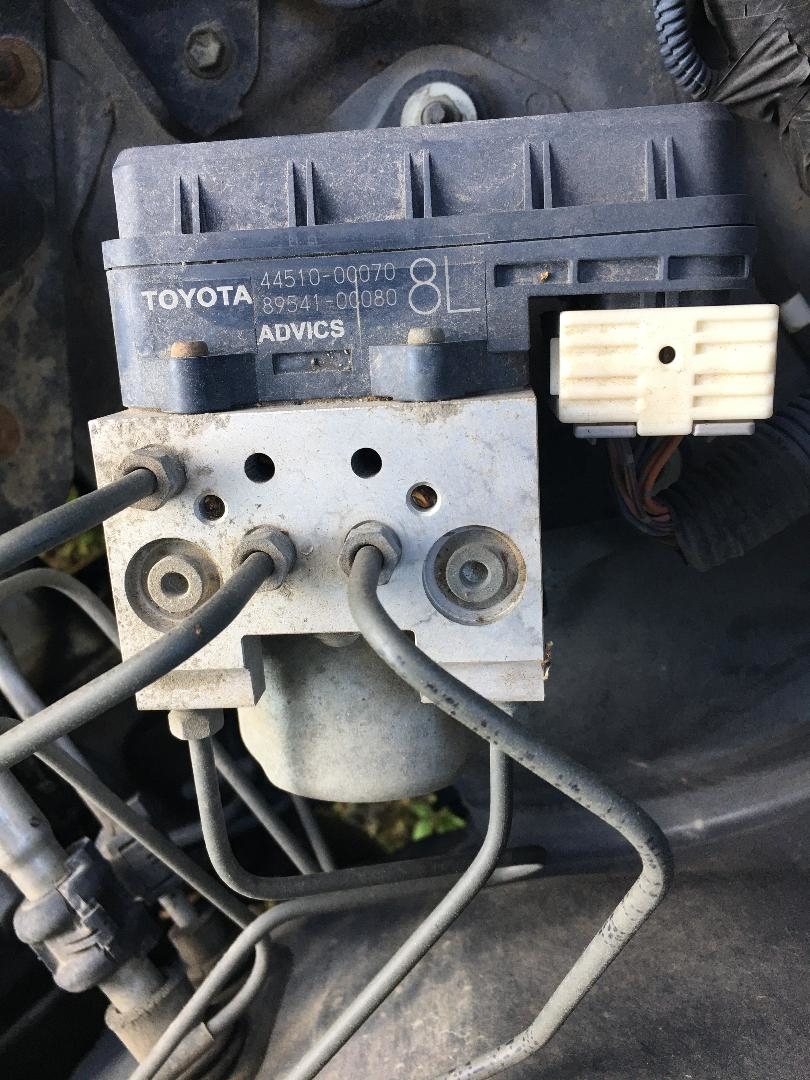

Joe,

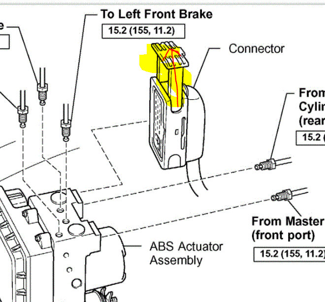

Is this the ABS actuator that you advised me as the best way to temporarily disconnect the ABS? Since it has five lines leading to the master cylinder and I assume each brake, I believe this is it. It has an unusual electrical connector that looks like it may be difficult to disconnect.
May 26, 2021 at 8:08 PM
  • 110,194 POSTS
That's it. As far as the connector, pull up on the slide. That will release the lock and then you will be able to remove the connector.
I attached a pic below showing the lock slide.
