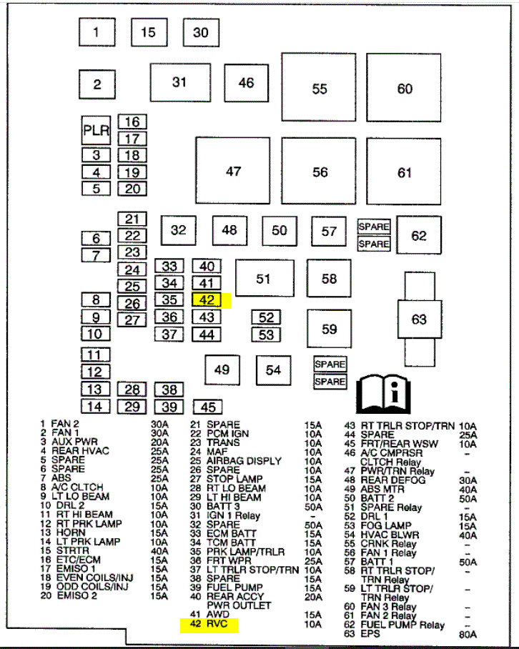

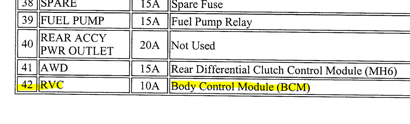

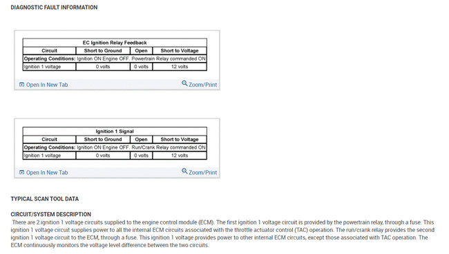

What does fuse # 42 RVC 10amp control and what does RVC mean?
Jul 3, 2021 at 7:40 AM
  • 110,240 POSTS
RVC stands for regulated voltage control. The fuse you refer to is for the body control module. A body control module is responsible for controlling several electrical components and communicates with other modules on the vehicle.
I attached two pics below. Did I get the correct fuse you are referring to?
Also, let me know what kind of issues you are having.

KEVIN BURDEN

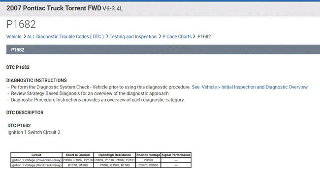

Thank you. I wonder if this has something to do with the p1682 reading different voltages code one getting because this fuse is missing. I'm going to put in a fuse and let you know.
Jul 5, 2021 at 3:36 AM
  • 110,240 POSTS
The code you indicated deals with the ignition 1 power circuit. Are there any specific issues you are having? Also, are there additional codes?

Fuse marked RVC was missing I replaced it and it did nothing it's fuse #42 on the 07 torrent. Twice while driving the car I got a p1682 code but no effect on anything. while driving the car that the voltage wanders between 14.1 and 12.4 it's very random but always happens. Sometimes it will stay at 12.4 for 90% of my trip and sometimes it stays at 14.1 90%. That's as best as I can explained it . Thanks for your patience.

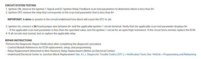

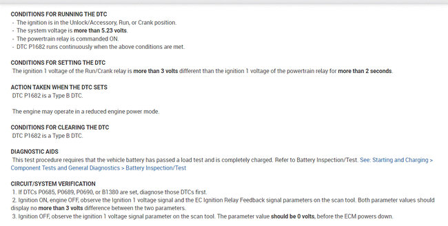

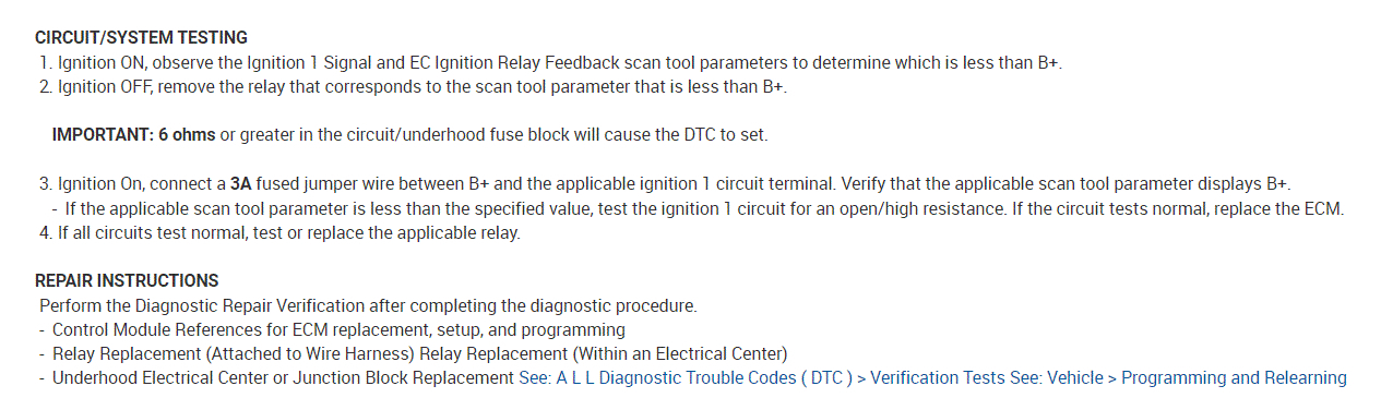

  • 110,240 POSTS

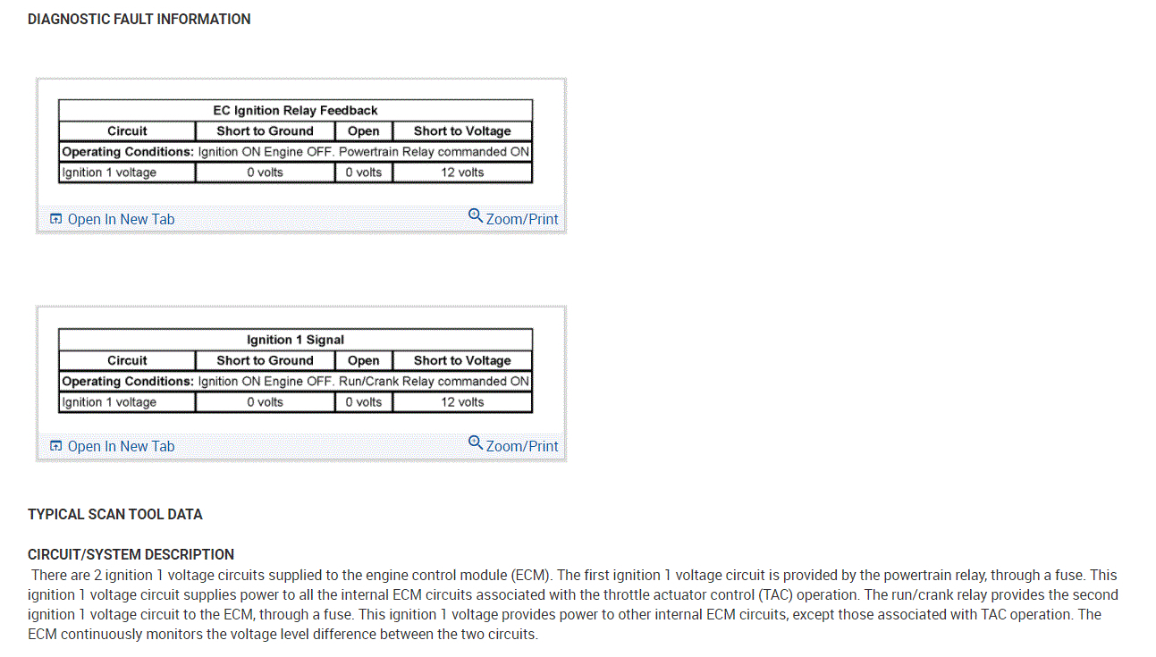

It sounds like the voltage regulator may be bad. What makes it difficult to confirm is the idea that it works normally at times.
If you want to check, I attached the diagnostics related to the code you have. Take a look through them to see if they help and if you are comfortable performing them.
Let me know what you find.
