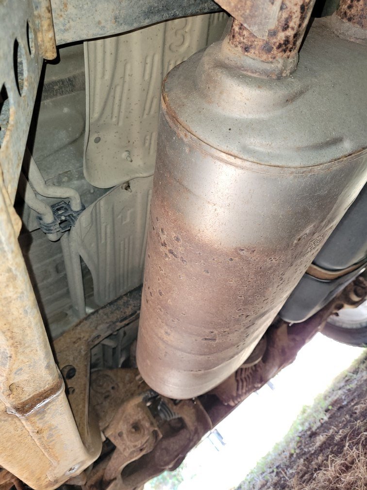

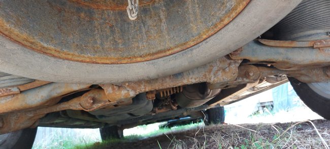

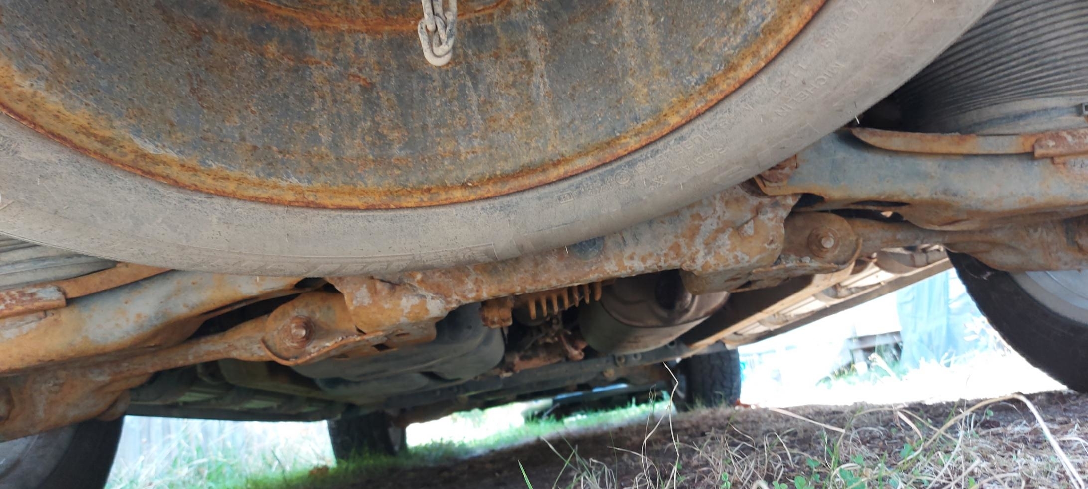

This van has some rust on the undercarriage and I am wondering if this is something that I can get rid of somehow as otherwise the vehicle is in good shape. any recommendation appreciated.

No, there is nothing you can do with it. It is much deeper than surface rust.
The rear suspension looks like it was underwater for a period of time. That will cause the process you see.
You can scrape off the surface rust but most of the rust is embedded into the metal itself.
The exhaust is just surface rust you can remove with a good stiff wire brush.

This is a little more then normal surface rust. All vehicles can get this and it is not something that you are going to prevent 100%.
Frankly that does not look that bad. Clearly this is a relatively new vehicle so it is something to keep an eye on.
However, more than likely this vehicle was parked on gravel or in grass for most of its life which makes this issue worse. Basically the grass and gravel release moisture for a longer time after it gets wet so the metal stays wet longer and this surface rust will grow.
Clearly many years from now this metal will have some holes in it from this but that will not happen over night. There is no way to know how long but the ways to prolong the life is to wash the undercarriage on a regular basis and keep it stored in a garage or covering on a solid surface.
