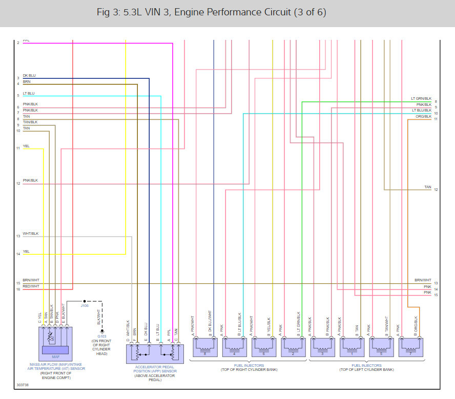

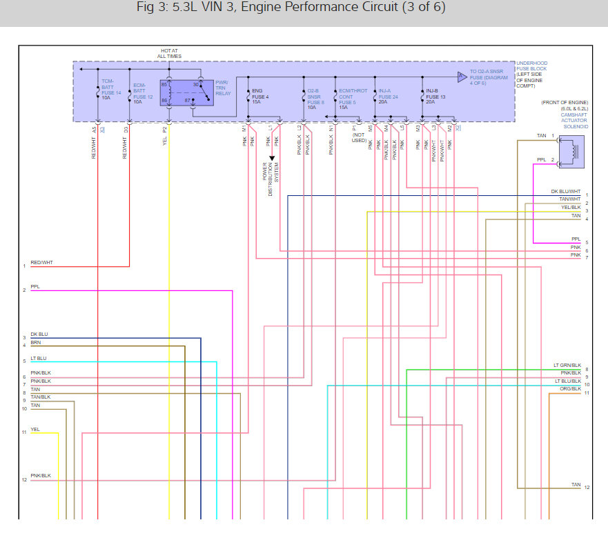

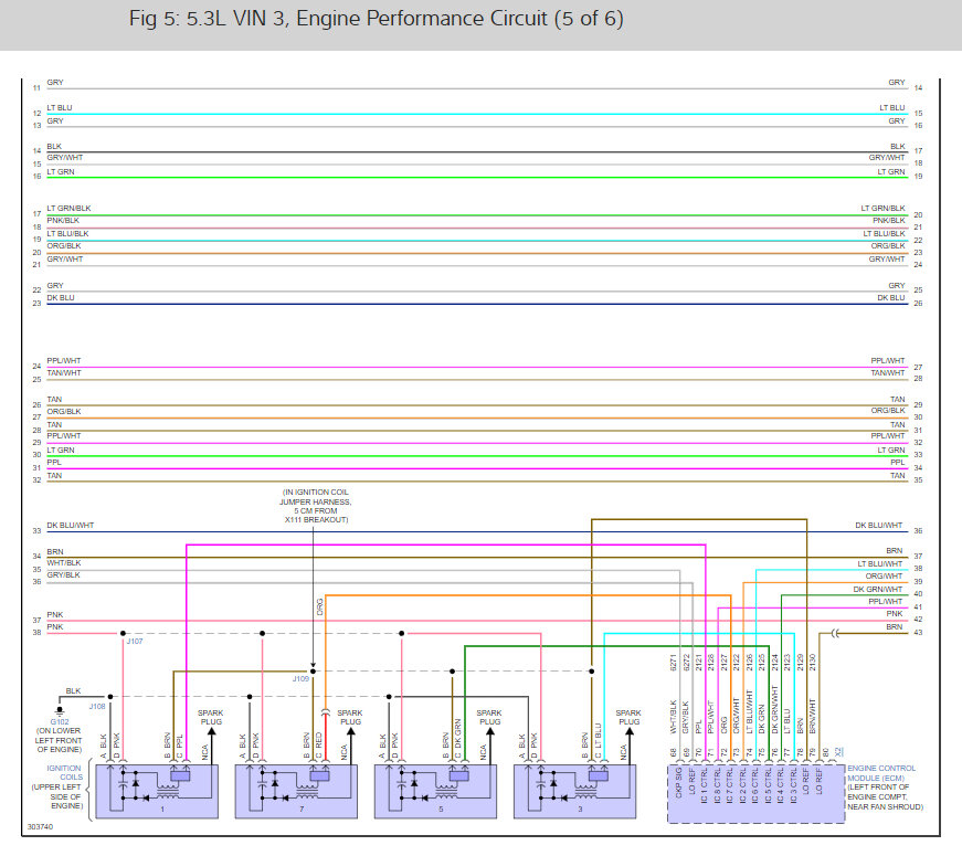

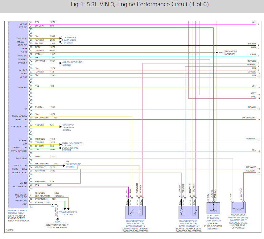

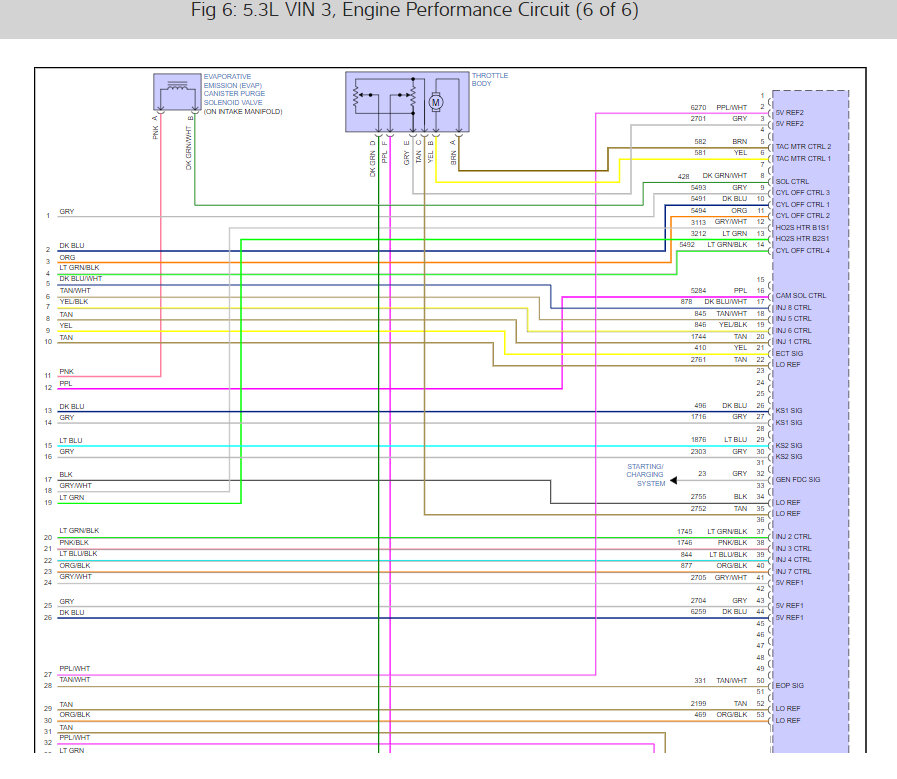

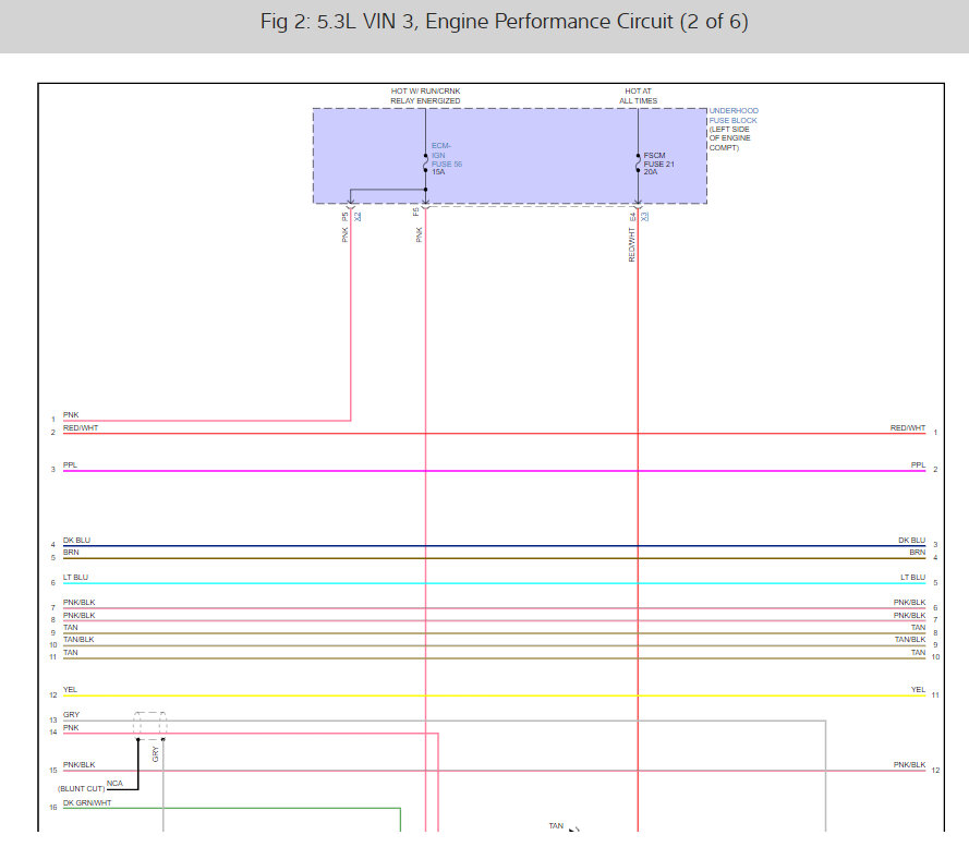

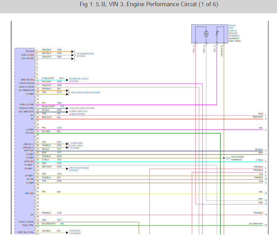

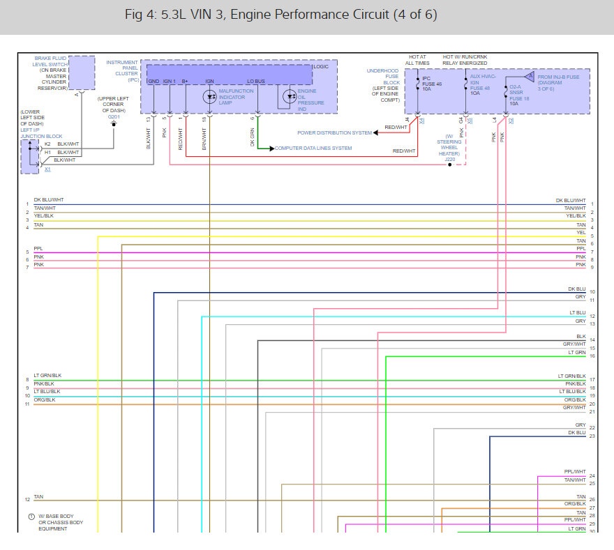

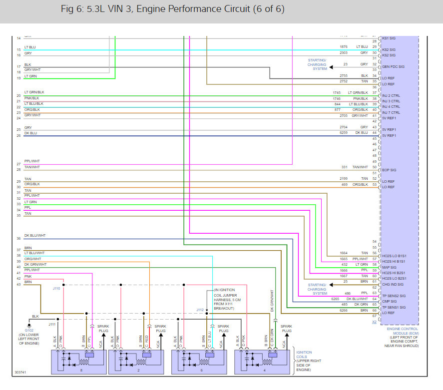

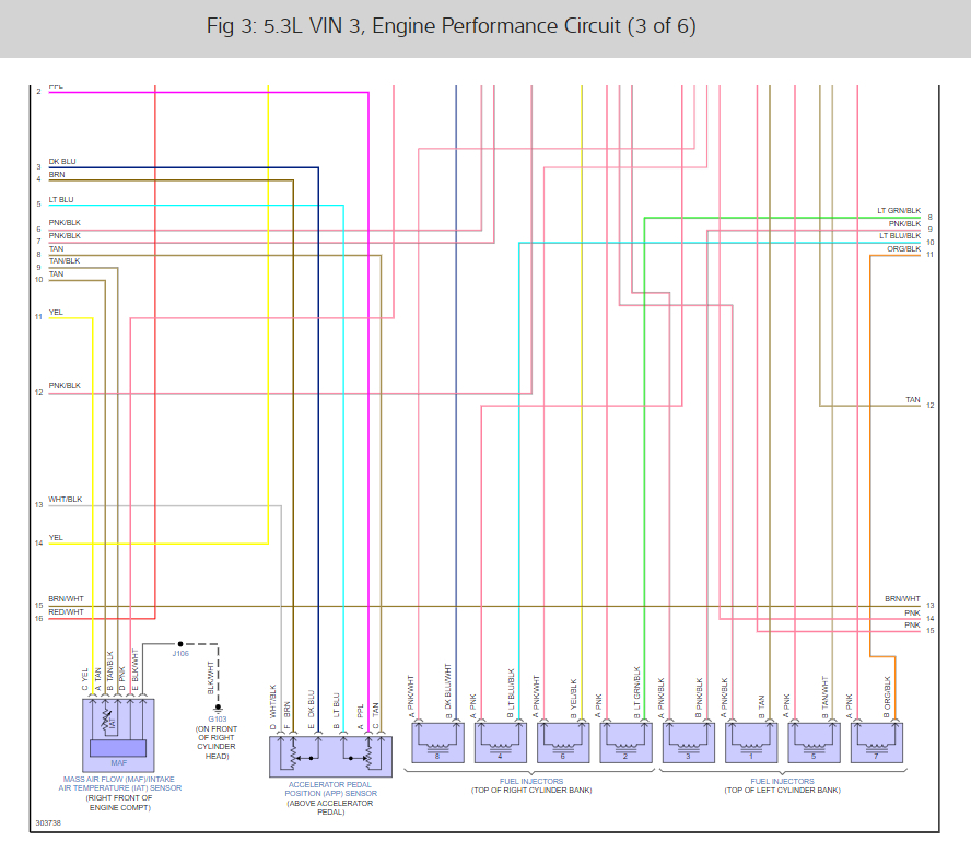

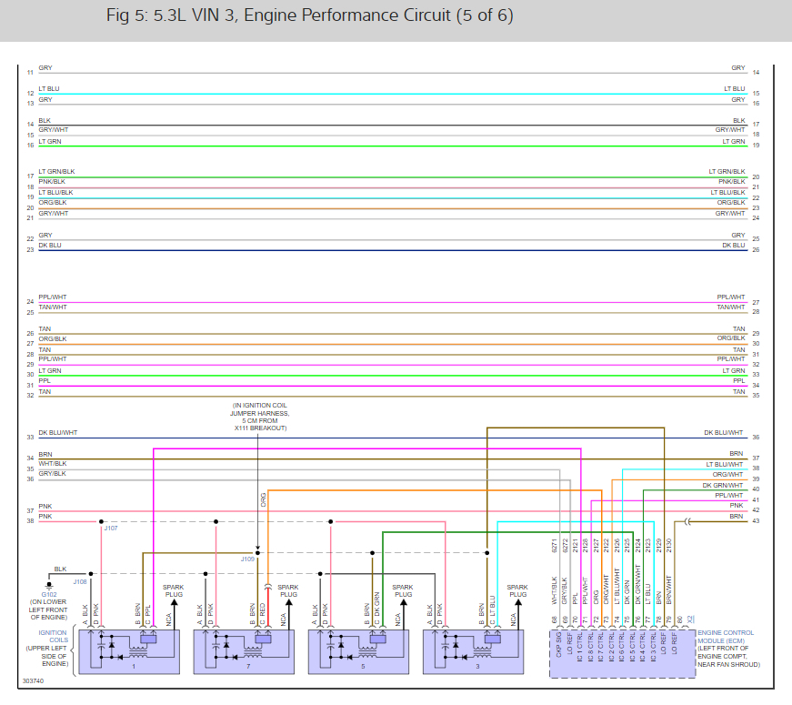

Please help. need the engine ground wiring diagram or really the all of the engine wire diagram to the PCM. I'm thinking it has a bad ground or some sort of issue the wiring somewhere. i just can't figure out were. i don't know what wires are what. Please help. thank you.
Nov 9, 2023 at 12:55 AM
  • 55,403 POSTS

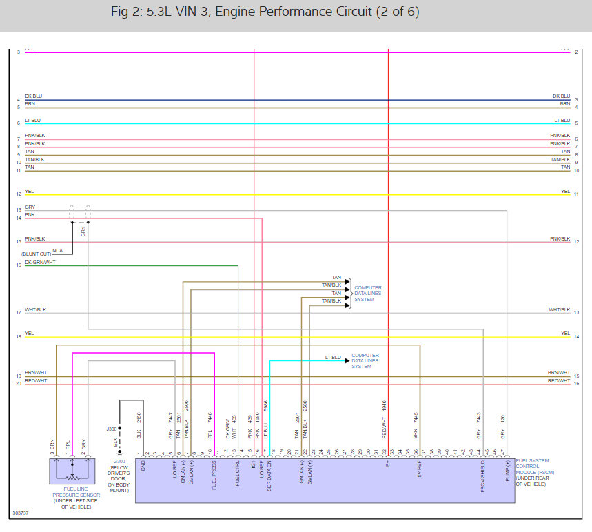

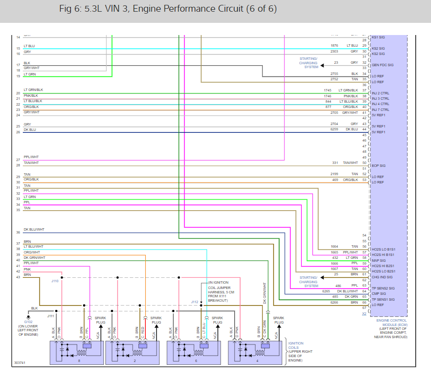

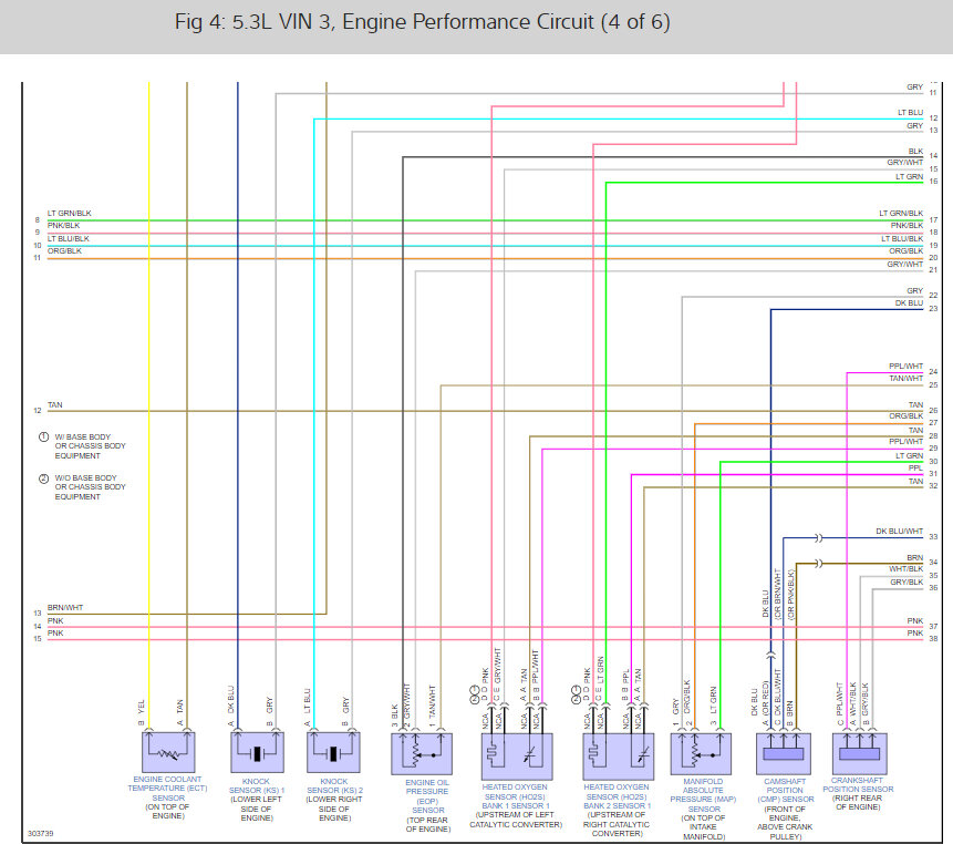

U0073: This is a diagnostic trouble code (DTC) for "Control Module Communication Bus 'A' Off." It means that there is a general communication problem on the CAN (Controller Area Network) bus A of your vehicle.
P0300: This code stands for "Random/Multiple Cylinder Misfire Detected."
Here is a guide to help you test the wiring round connections to the engine and it shows how the PCM is wired:
Check out the images below. Let us know what you find.
