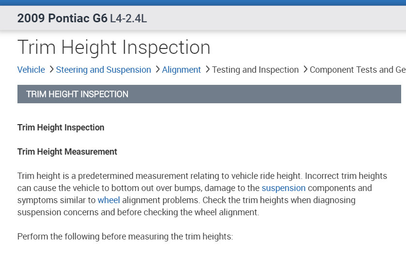

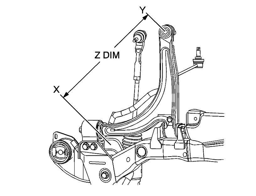

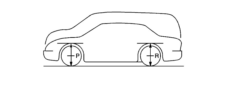

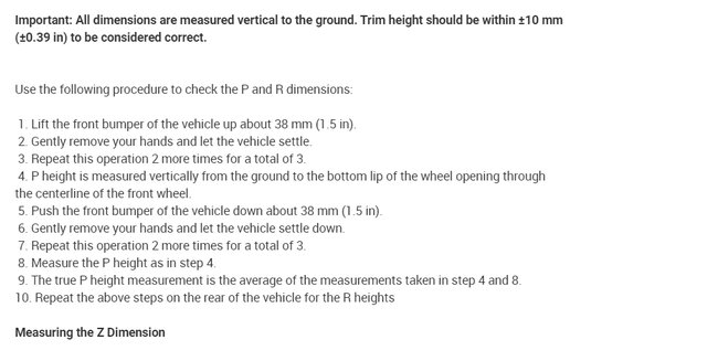

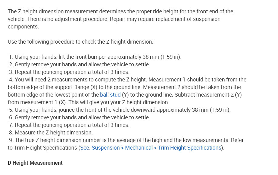

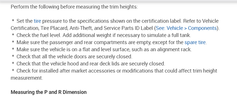

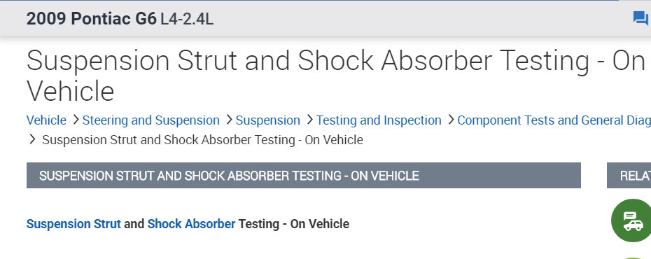

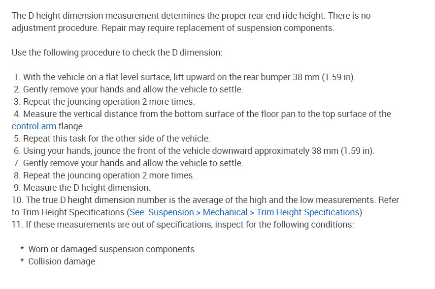

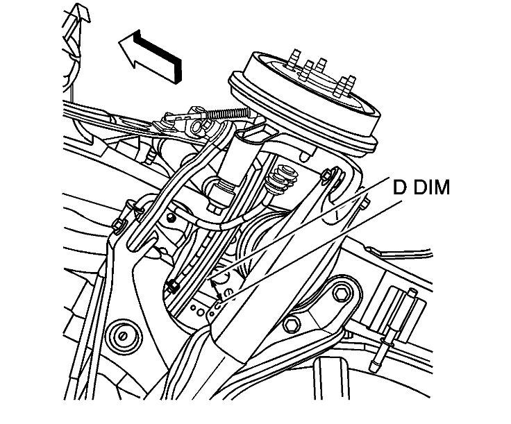

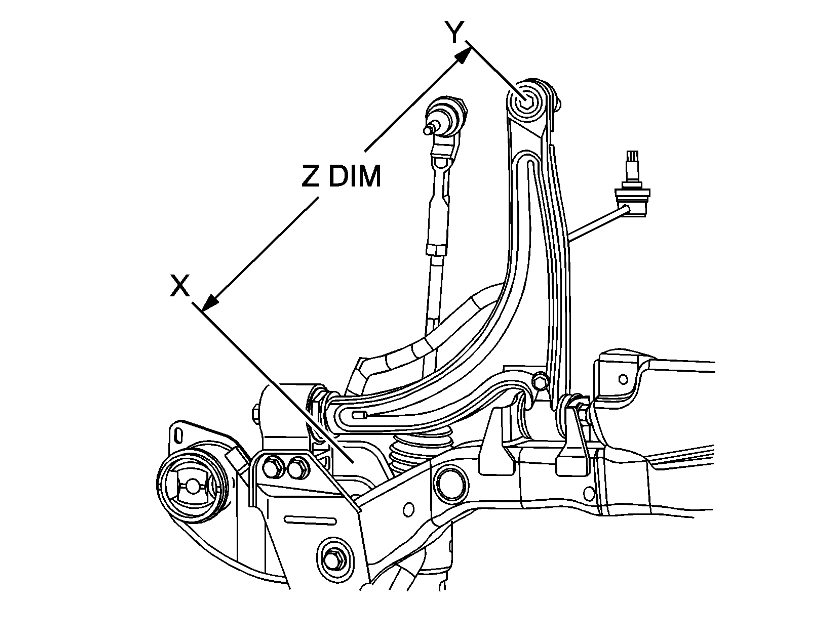

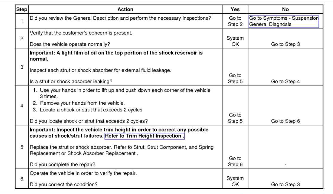

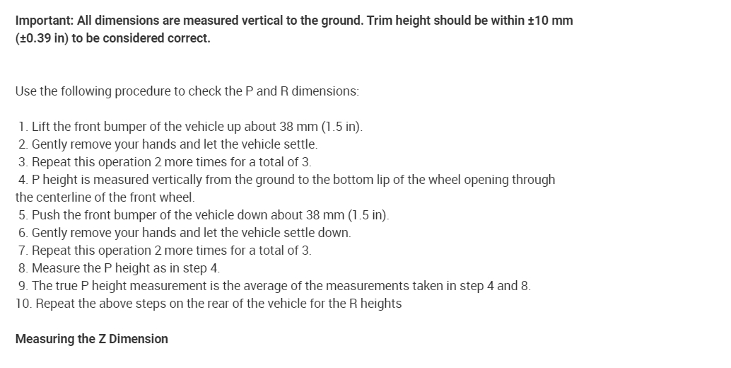

Yes, it does sound like it is probably strut related, but let's do some testing to make sure. In the diagrams down below I have included the Suspension Strut and Shock Absorber Testing [On Vehicle] guide, and the Trim Height Inspection guide, both from the vehicle manufacturer, to see if your shocks and/or struts have failed, and need to be replaced. Please go through these guides and get back to us with what you find out. We can go from there, if necessary.
Thanks,
Alex
