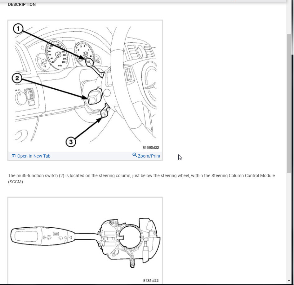

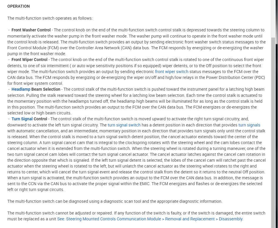

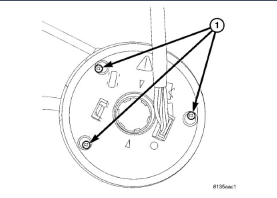

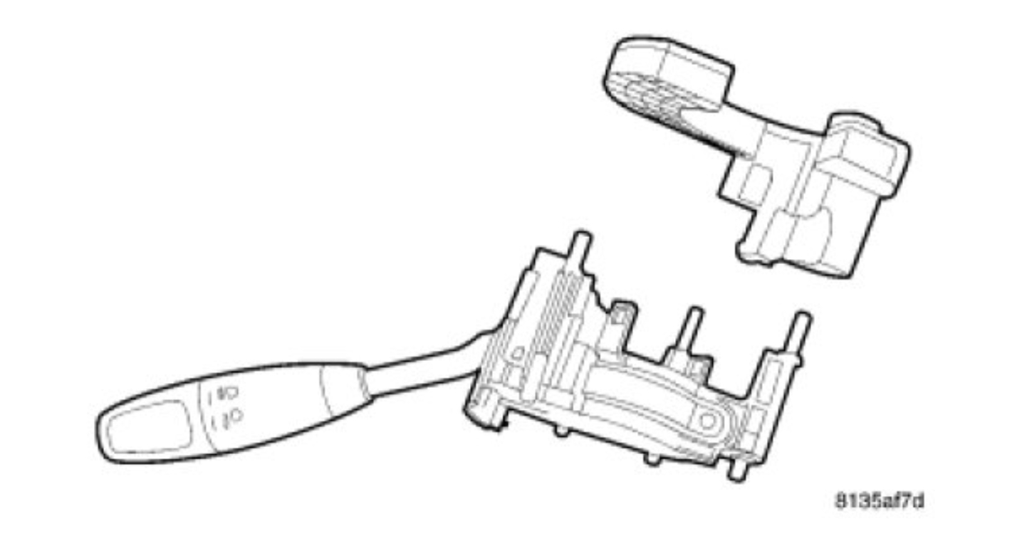

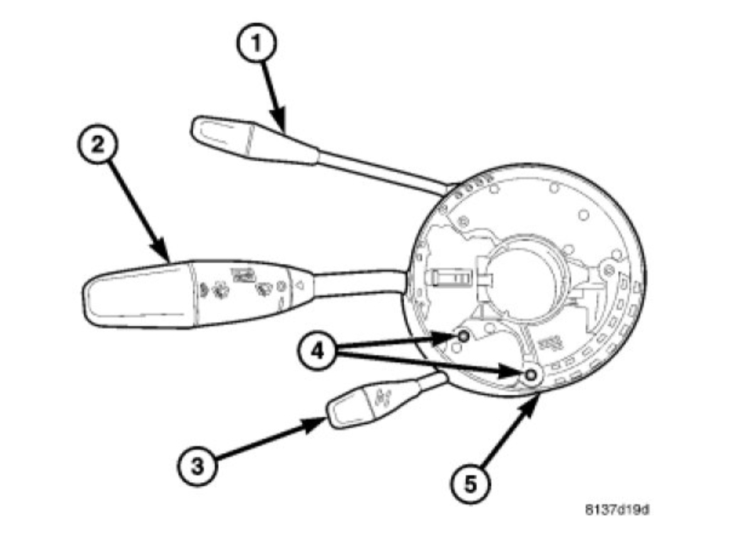

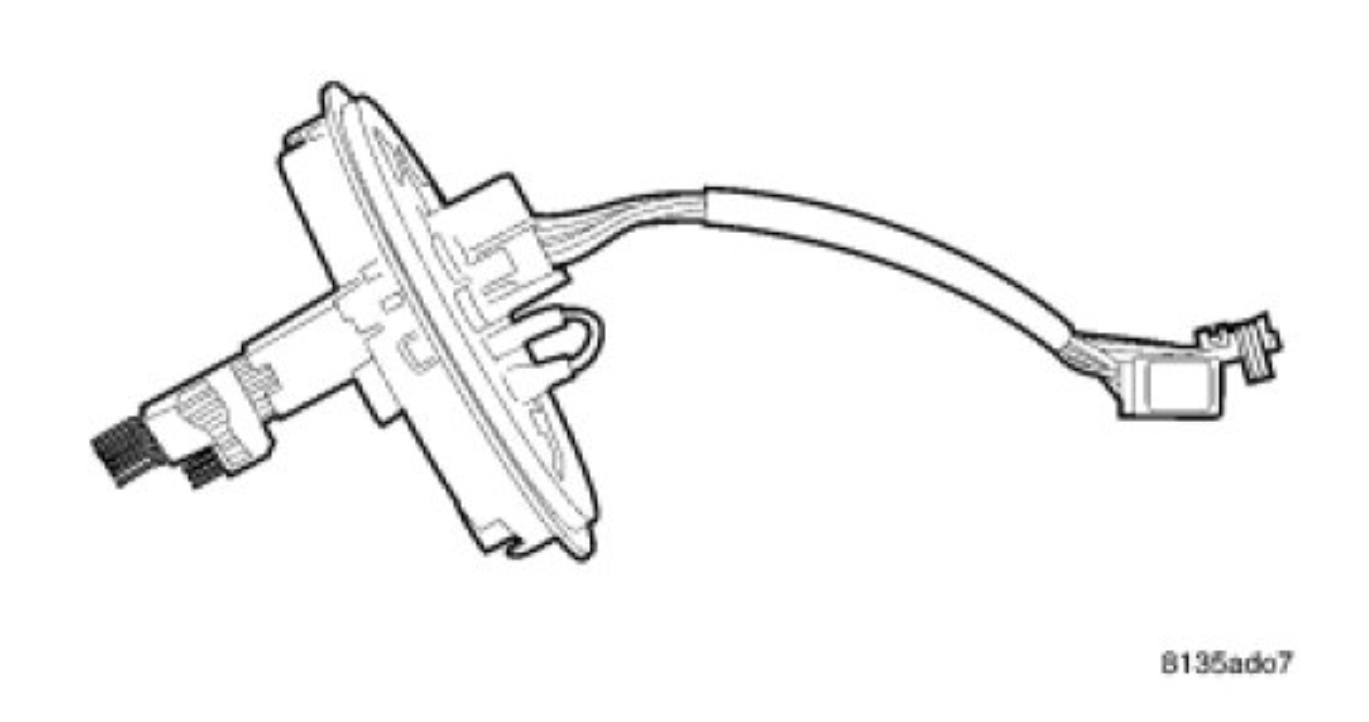

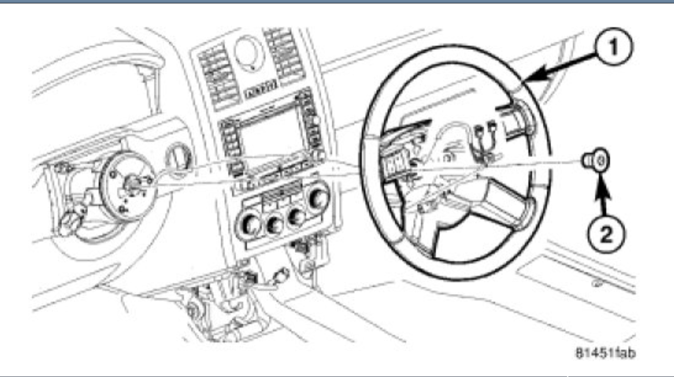

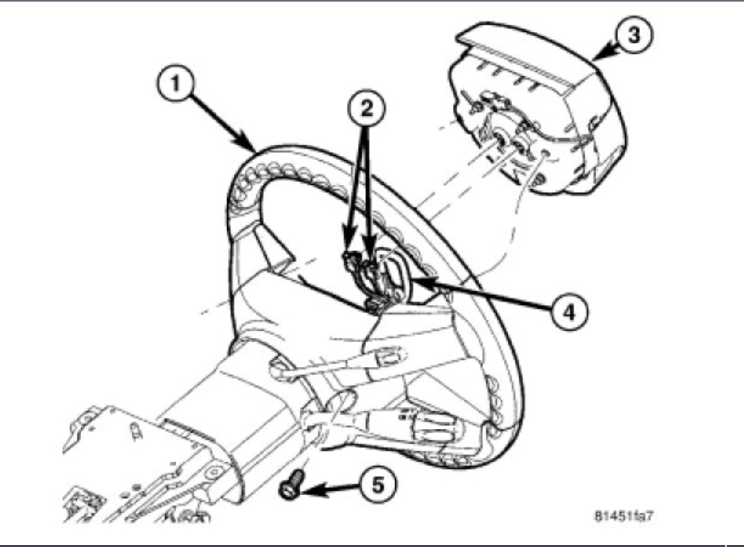

My bulbs aren’t out and seem work fine but sometimes when I turn the signal switch to the right the left signal comes and and when I signal left it won’t always turn on, but when it does turn on and I go to turn it off manually it activates the right signal or just is delayed. I’m thinking it might be loose wiring, but I’m not sure where to start looking.
Jan 16, 2020 at 3:04 PM
  • CAR REPAIR CONTRIBUTOR
  • 110,190 POSTS

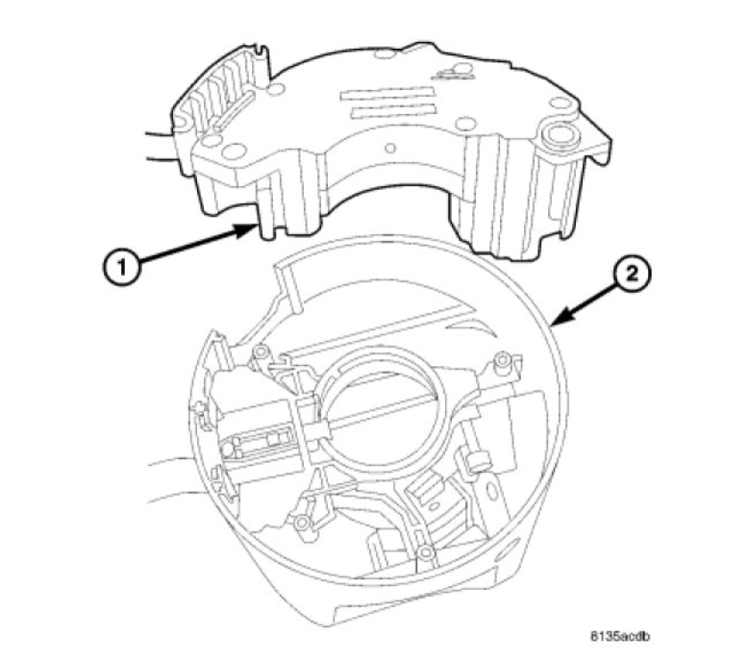

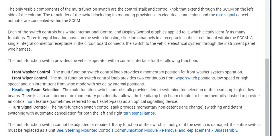

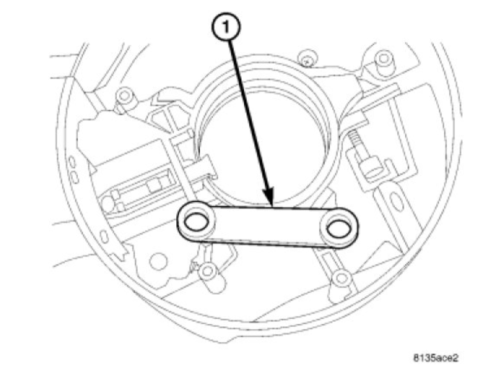

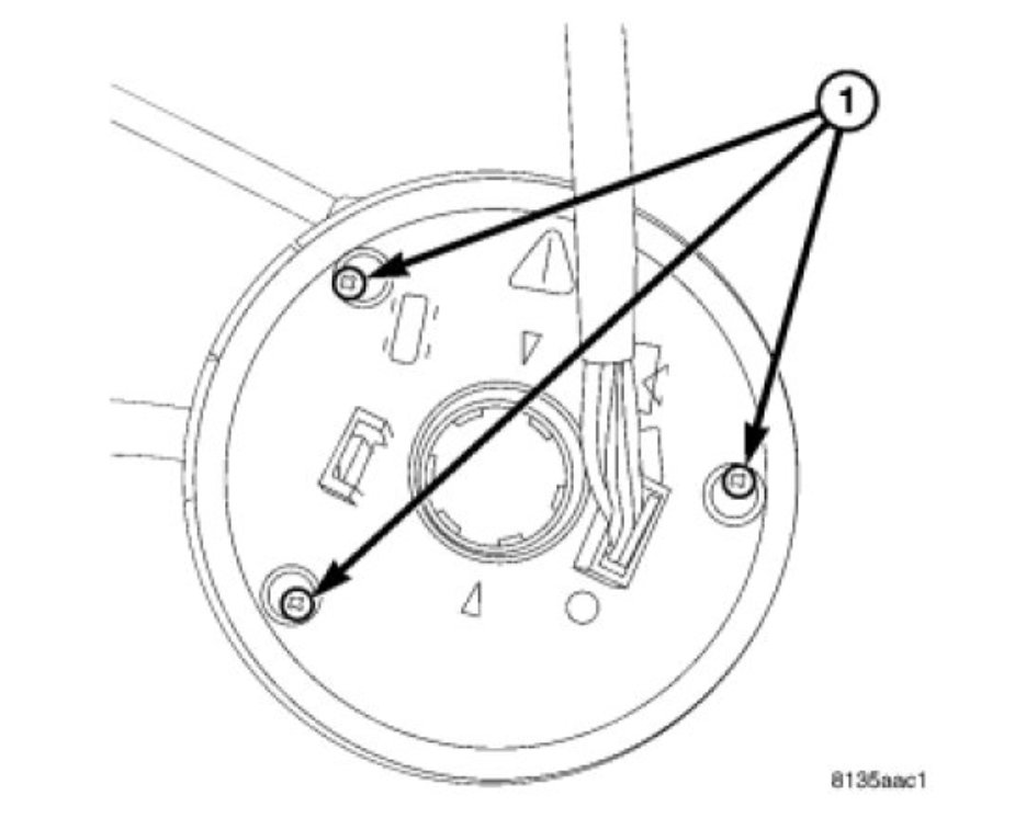

I have to be honest, based on the description, it sounds like the switch is bad. Replacement of the switch is somewhat involved because it is part of the steering mount control module. It requires removal of the steering wheel, and a few other components. If you feel comfortable, here are the directions. The attached pics correlates with the directions.

4. Remove the driver airbag (3). See: Air Bag > Removal and Replacement > Driver Airbag - Removal

5. Remove the steering wheel retaining bolt (2), then slide the steering wheel (1) off the shaft.
pic 3
6. Unscrew at least one clock spring screw (1) but don't take it all the way out, This will help keep the clockspring from uncentering itself.

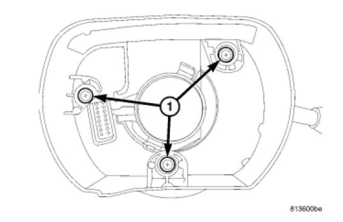

pic 4
7. Back out the set screw (1) through the access hole (3) in the bottom of the Steering Column Control Module (SCCM) (2).

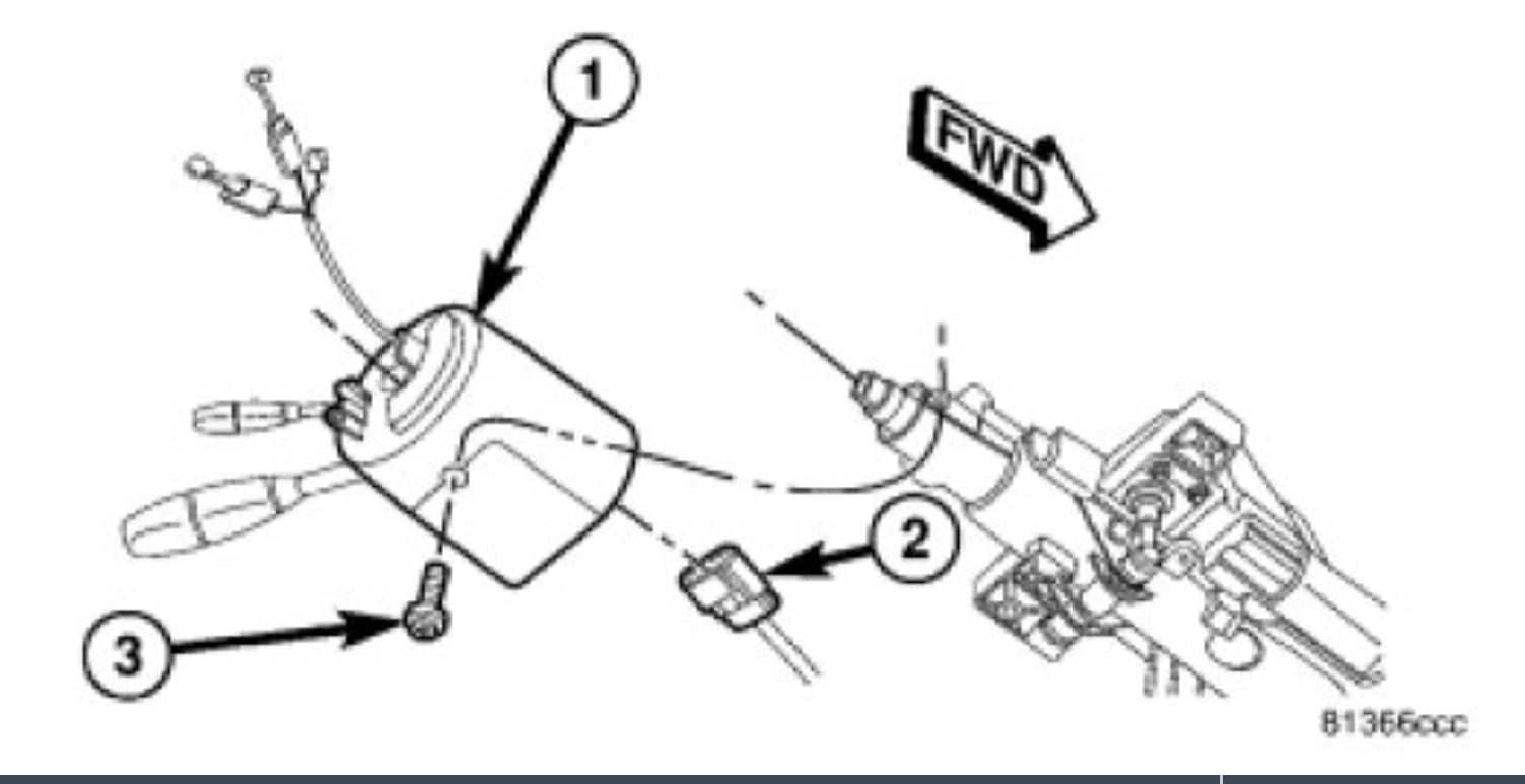

pic 5
8. Pull the SCCM (1) off the steering column shaft.
9. To service the individual components contained within the SCCM, See: Steering Mounted Controls Communication Module > Removal and Replacement > Disassembly.

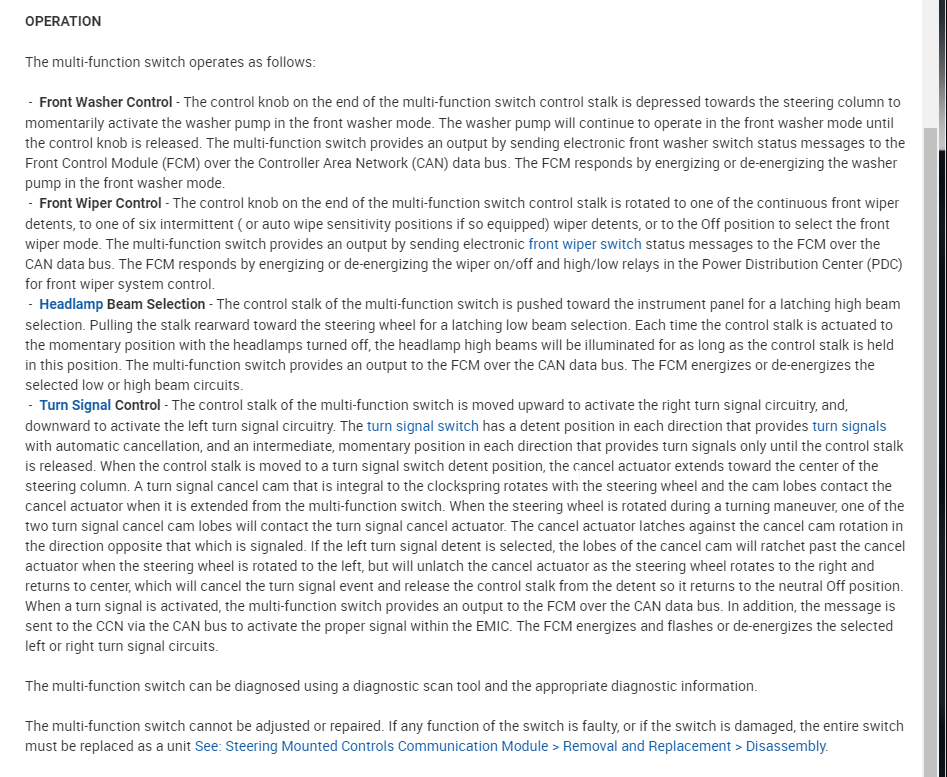

pic 6
WARNING: To service any component of the SCCM, the entire assembly must be removed from the column. This must be done due to the clockspring passing through the assembly and into the self docking connector. Failure to remove the assembly could damage the pins of the clockspring and prevent the airbag system from operating properly.
1. Loosen the three clockspring screws (1) just far enough to release the clock spring from the SCCM. Leave them in the clockspring so it won't unwind.
pic 7
2. Carefully pull straight up on clockspring to remove.

7. Remove the three screws (1) at the bottom of the SCCM shroud for the multi-function switch and Steering Control Module (SCM).
pic 13
8. Separate the multi-function switch from the SCM.

Let me know if this helps.
Feb 12, 2021 at 12:31 PM
It could be a wiring issue however the multifunction switch is a common cause of this. If it were me I would just replace the switch and then retest it as it is pretty common failure.
Let me know if you have questions. Thanks
