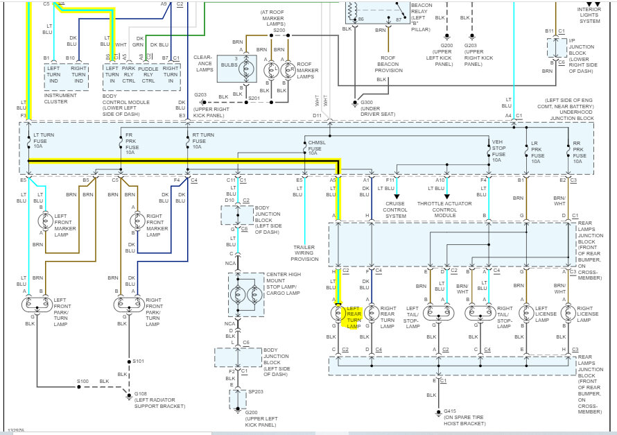

When I put on the left turn signal all of the flashers light up in the back?
2000 CHEVROLET 1500
200,000 MILES • V8 • 4WD • AUTOMATIC
POWELLKC2827
Replaced the combination flasher sensor and it is still doing the same thing, no change. Any suggestions?

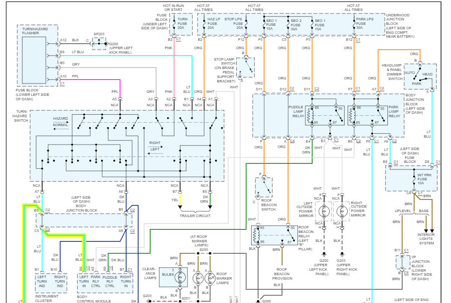

I attached the wiring schematic below related to exterior wiring. I have a question. Does the vehicle have a trailer wiring harness? If it does, disconnect it and see if the problem stops.
If there isn't one, you replaced the flasher, and nothing happens out of the ordinary with the right signal, my first suspect would have been the switch. However, if there was a short to power, it would happen when you used the right signals as well. Also, the front bulb would light up as well as the rear because the wiring is tied together (front/rear) I'm thinking there is a problem with the junction block in front of the rear bumper and mounted to the cross member. If there is some issue there, that would potentially eliminate the front right from flashing with the right rear. Ugh. This is an odd one.
Check the box and let me know what you find. Also, inspect the wiring to and from the box for evidence of damage.

Thank you for your help. Turns out it was wiring at the back of the bed associated with trailer hitch lighting. Man what a headache that was to run down! So appreciate your suggestions - they made the job a lot easier to figure out.
