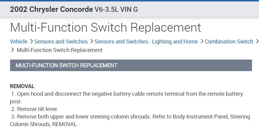

Turn signals flash four times and stop
2002 CHRYSLER CONCORDE
111,000 MILES • 3.5L • 6 CYL • 2WD • AUTOMATIC
RICHARD ANACKER

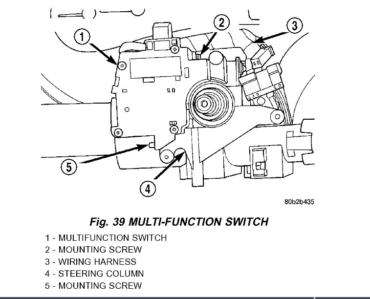

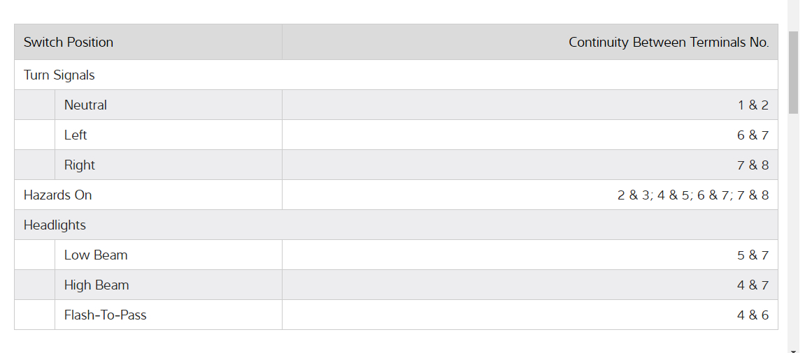

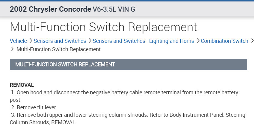

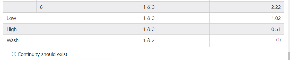

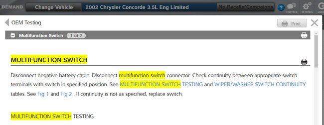

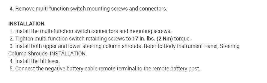

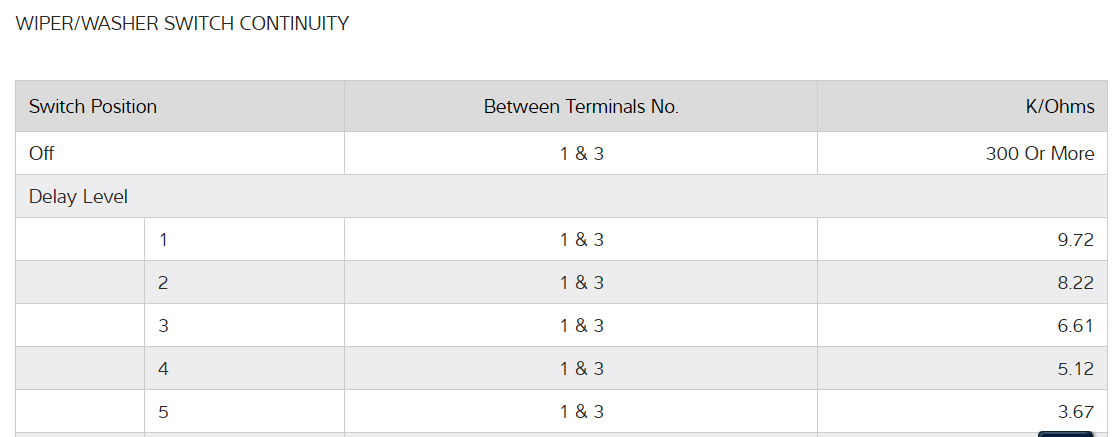

When using my turn signals they start to flash four times then stop on there own. Left and right down the same thing.
May 7, 2019 at 10:35 PM
SCGRANTURISMO
  • 4,897 POSTS

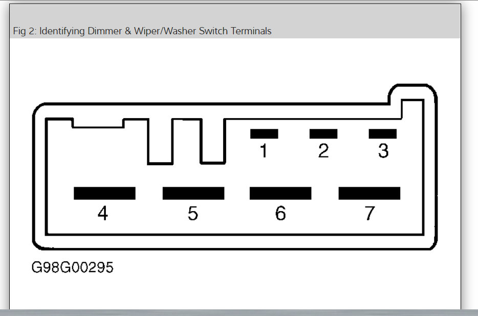

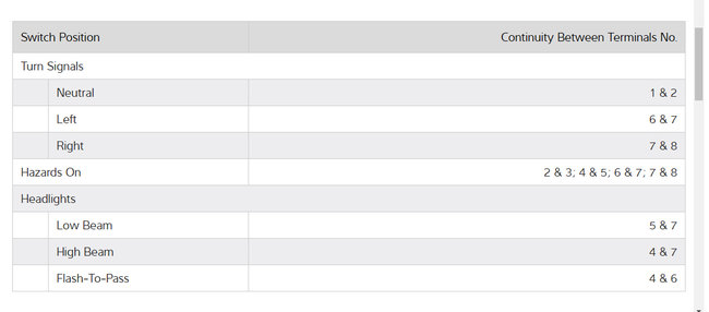

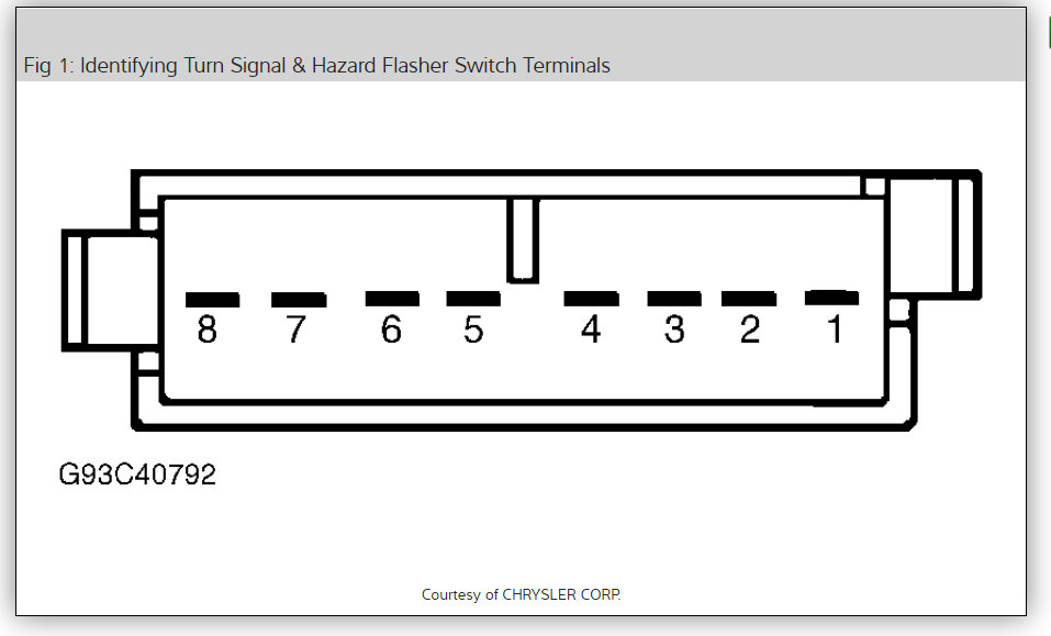

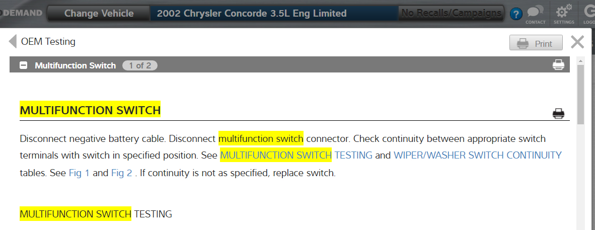

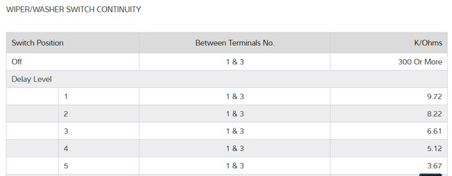

This could be a problem with your vehicle's multi-function switch, or to be more specific the cancel actuator on the multi-function switch. When you signal, either left or right, turn, then as your vehicle's steering wheel returns to center after the turn a cam located on the steering wheel's clock-spring hits the cancel actuator and stops the turn signal from flashing. In the diagrams down below I have included the factory diagnostic troubleshooting guide for your vehicle's multi-function switch. You will need to use a multi-meter in the Ohm's position to test continuity, so I have also included a link below if you are unfamiliar with how to use a multi-meter.
Please go through these guides and get back to us with what you are able to find out.
