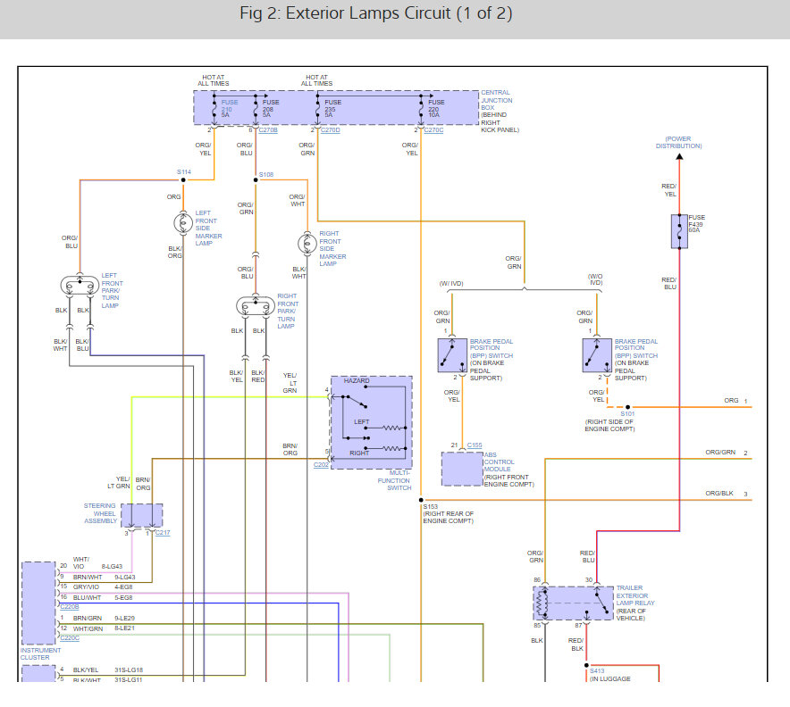

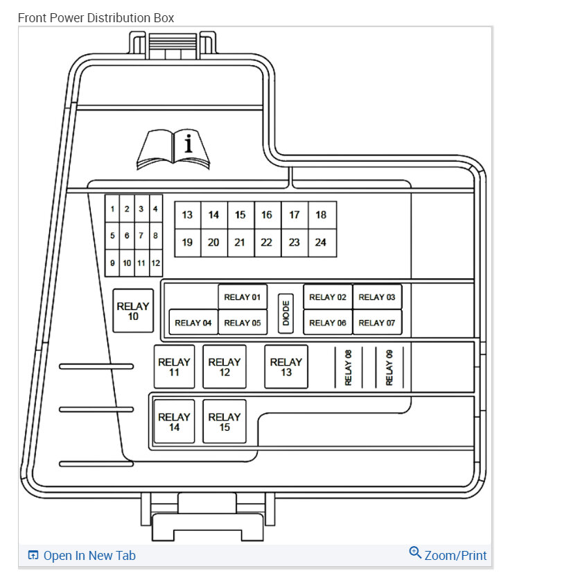

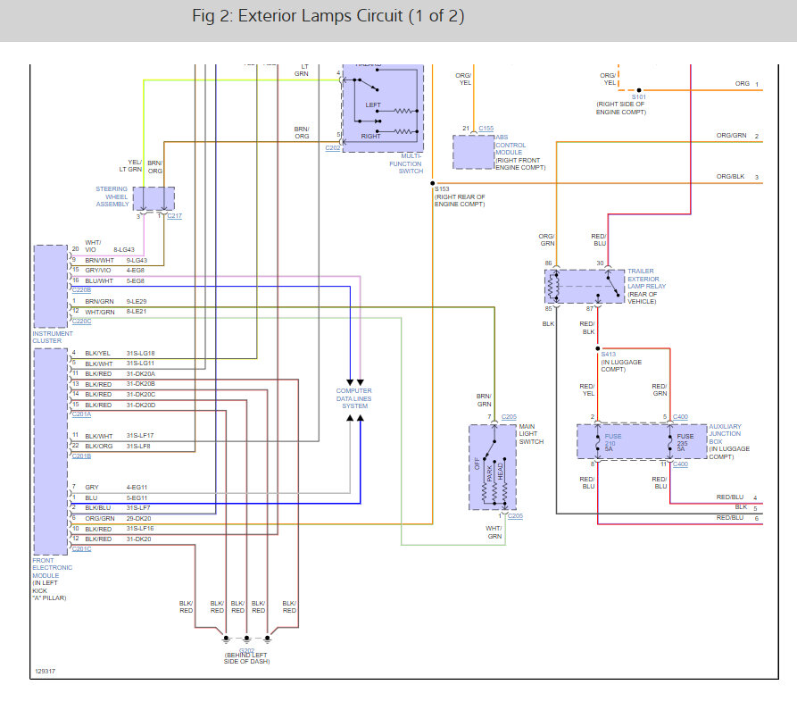

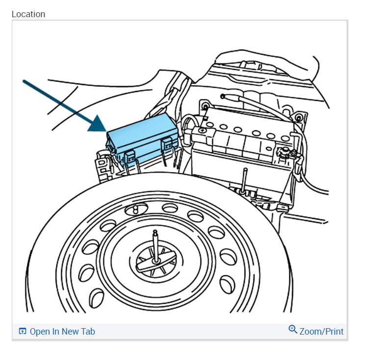

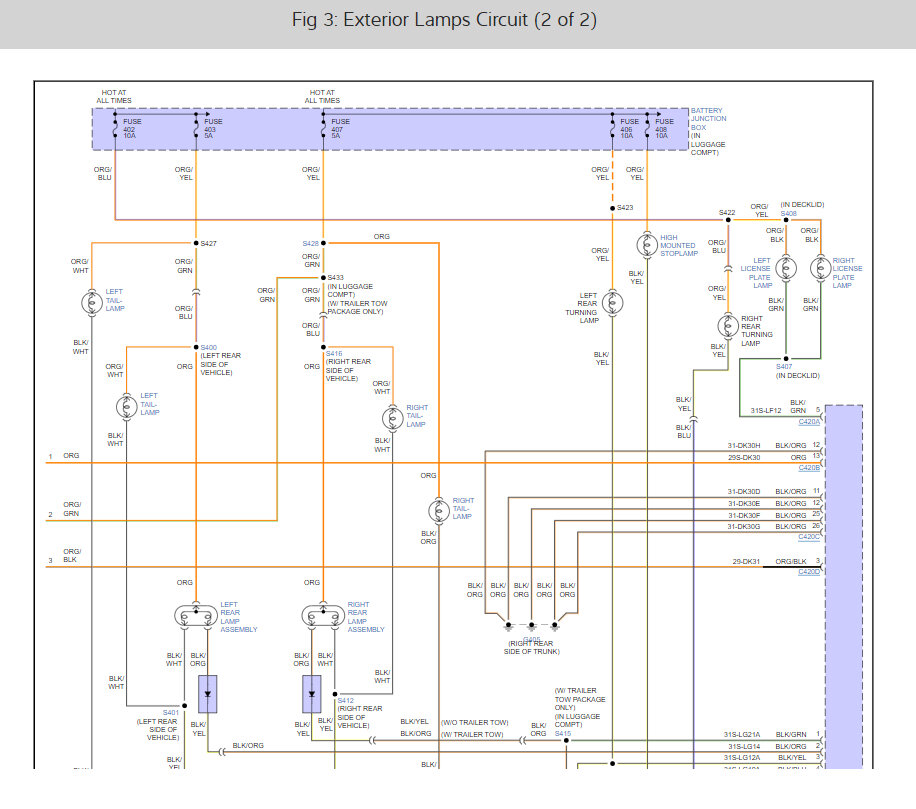

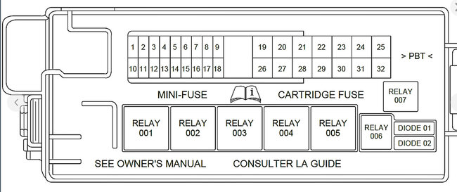

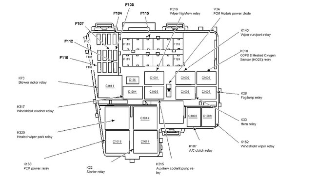

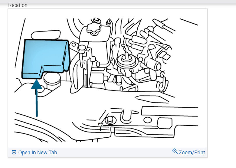

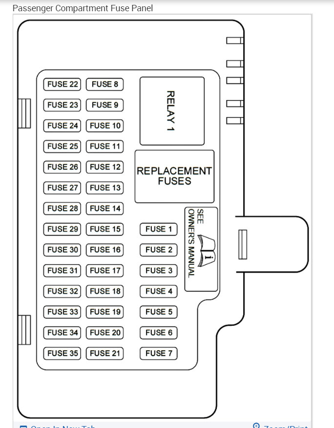

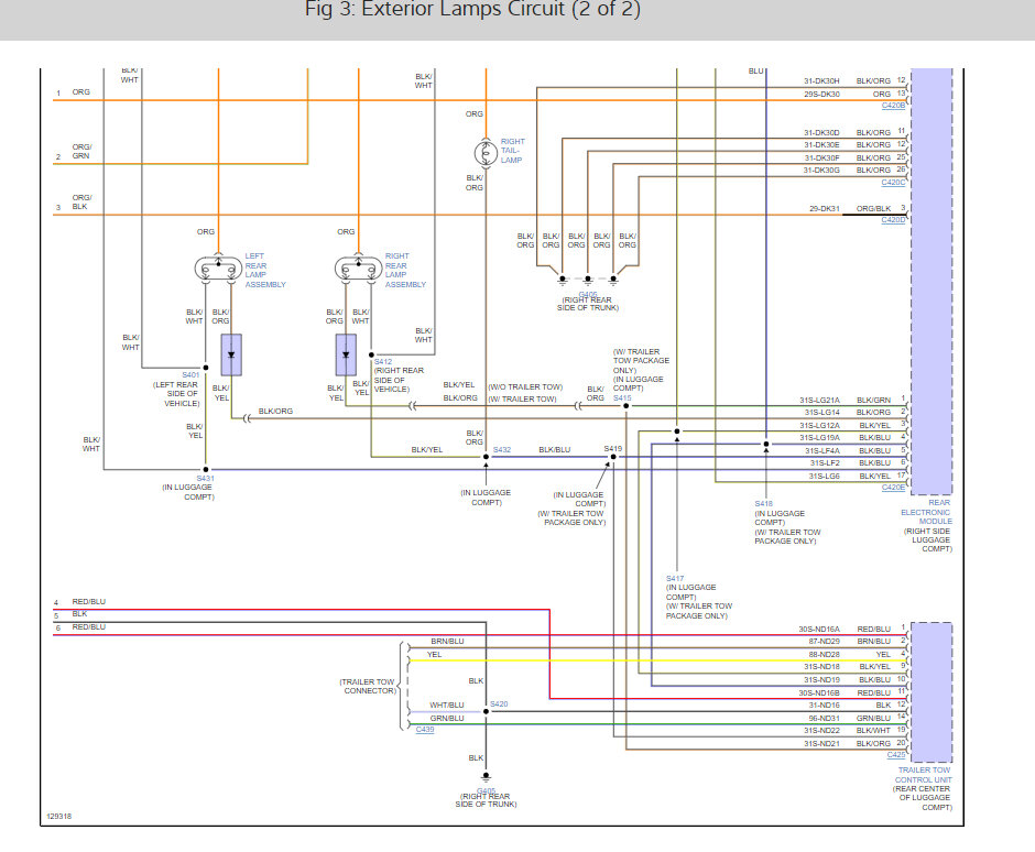

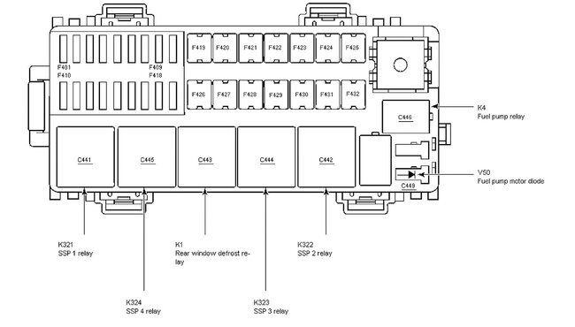

Need schematics on the vehicle listed above LS fuse boxes location.
Jan 12, 2023 at 11:27 AM
  • 54,836 POSTS
Sure, here are the locations of the fuses and I have included a guide on how to test the fuse and to check it for power:
I also have included the exterior lighting wiring diagrams so you can see which fuses to check and how the system works.
This guide can help as well:
https://www.2carpros.com/articles/turn-signals-not-working-blinker
Check out the images (below). Let us know what happens and please upload pictures or videos of the problem.
