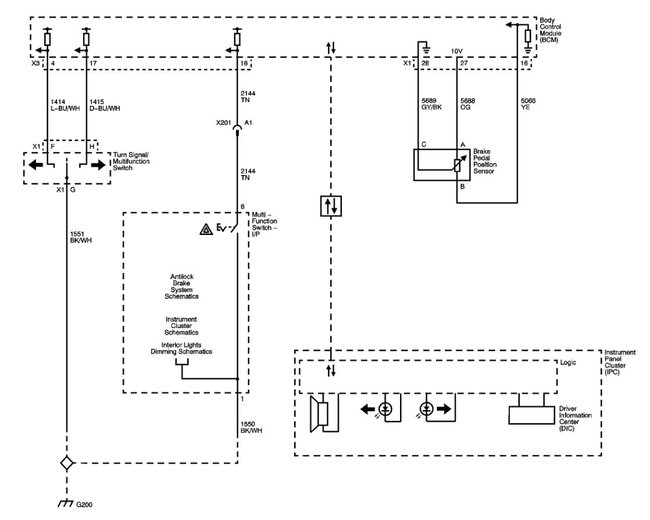

My turn signals all work, but there is no clicking noise to indicate the turn signal is on. Is there a relay that needs to be replaced or is it something different? Thanks.

Welcome to 2CarPros. The click on that vehicle is actually a sound played through the speakers. Do the key in ignition and seat belt warnings still sound? How about the turn indicators in the dash?

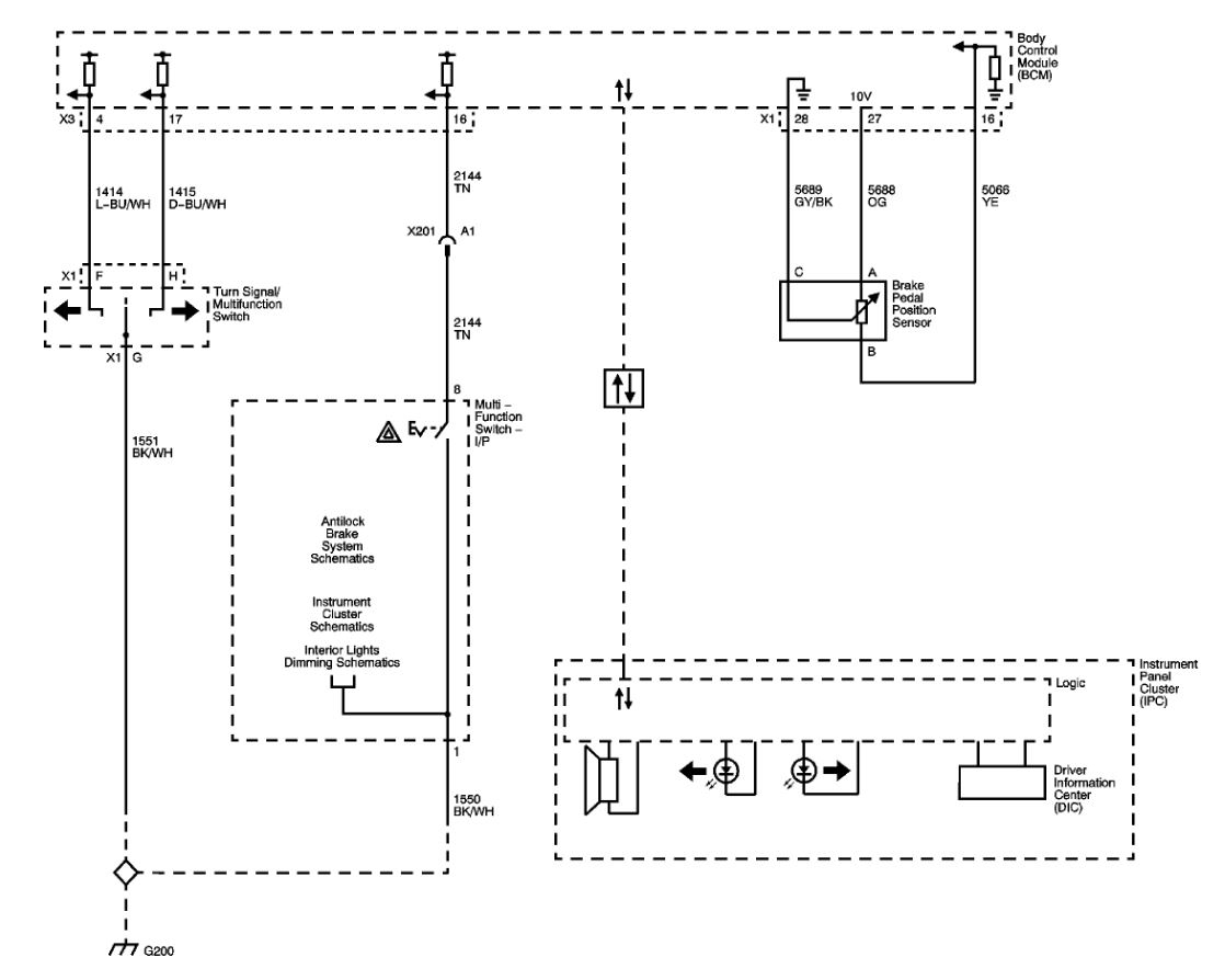

I haven't been near an Uplander in a while so don't remember if they clicked or not. The system doesn't use a mechanical flasher, the body control module does all the work. That sends a data signal to the dash or radio for the other chimes as well so those are working = the data line is okay. I don't know of any other mechanical item to click and the wiring shows nothing as well.

Hmm The only item about them I find is the turn signal reminder.
Turn Signal Reminder
A chime or audio warning activates as a turn signal on warning if the turn signal remains ON for a specific distance traveled. The turn signal warning sounds when a turn signal remains active, and the vehicle has traveled a distance of 1.2 km (0.75 mi).
The driver information center (DIC) turns the turn signal reminder OFF when the ignition switch or turn signal switch is turned to the OFF position.
There is no internal diagram of the BCM showing what it uses to flash the lamps but it could be a relay. If that is the case the two options would be to open the BCM, find the relay and replace it or replace the BCM, which is close to $200.00 when you add the module and programming it together. Not sure I'd want to do that for a click.

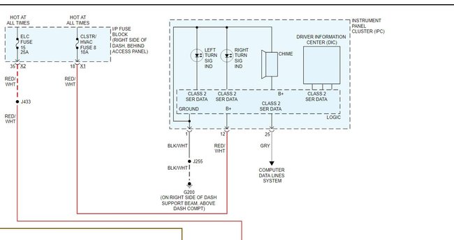

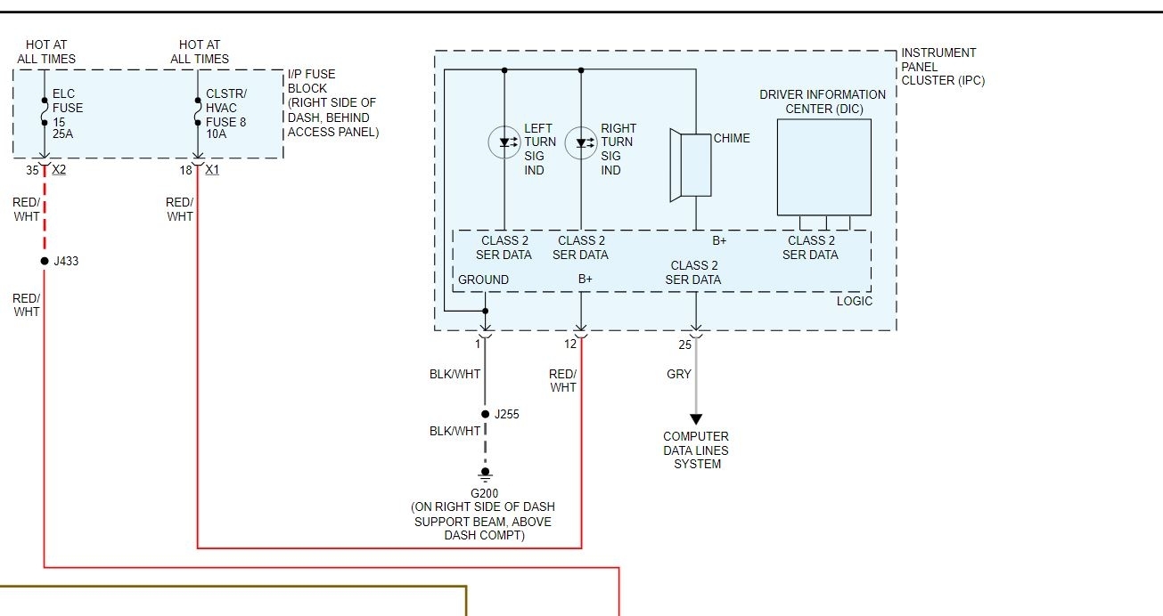

HMM, not sure what would have caused it to come and go like that without it acting that way now it would be hard to test because there isn't a way to hear it. The BCM does the switching and sends a signal to the DIC in the dash that signal tells it to turn on the left or right dash indicator and generate the tone for the operator. The dash is powered on the same fuse that powers the chime. Do the other warning chimes work like key in, seatbelt and such? If not then it could be the chime driver itself but the only way to repair those parts would be to have an electronics repair shop go through the cluster to repair or replace the chip.
