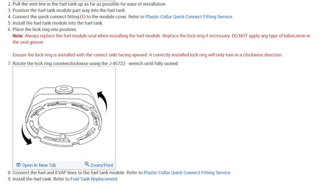

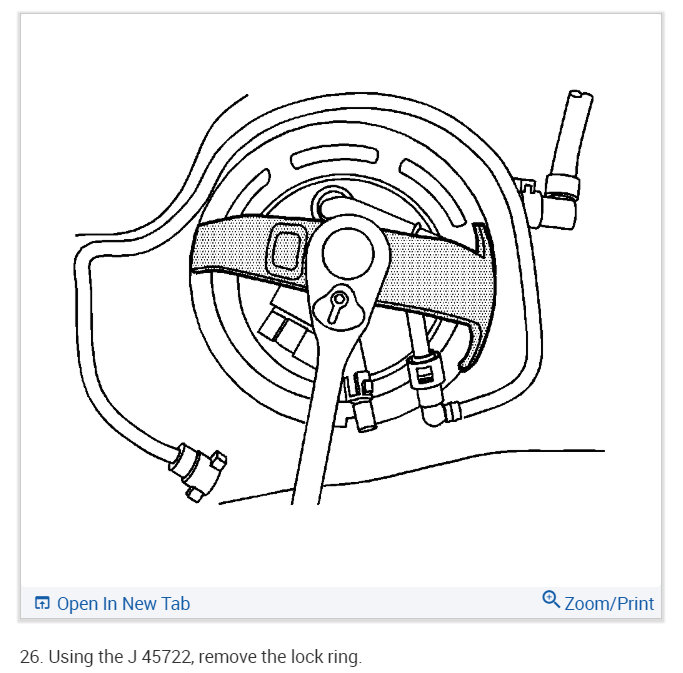

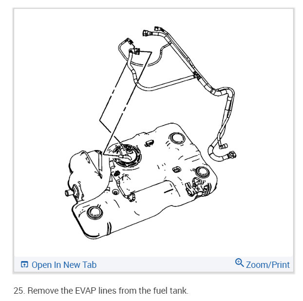

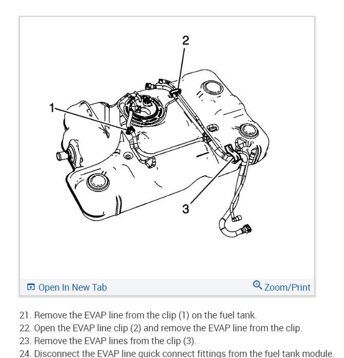

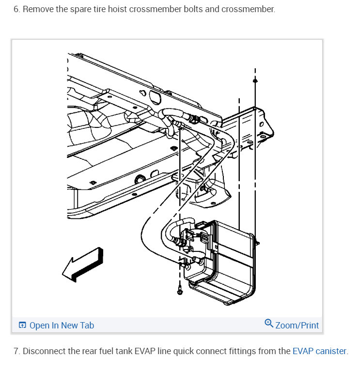

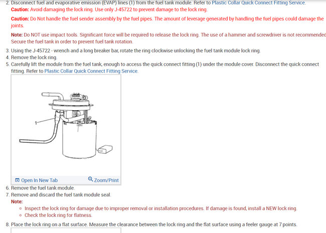

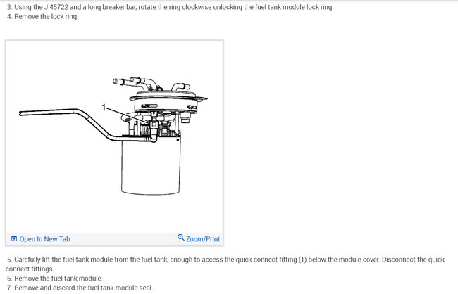

Seems to be worse under one-fourth tank. Black smoke when accelerating. Black carbon with moisture coming out of tailpipe.
Jun 6, 2022 at 9:31 AM
  • 55,433 POSTS

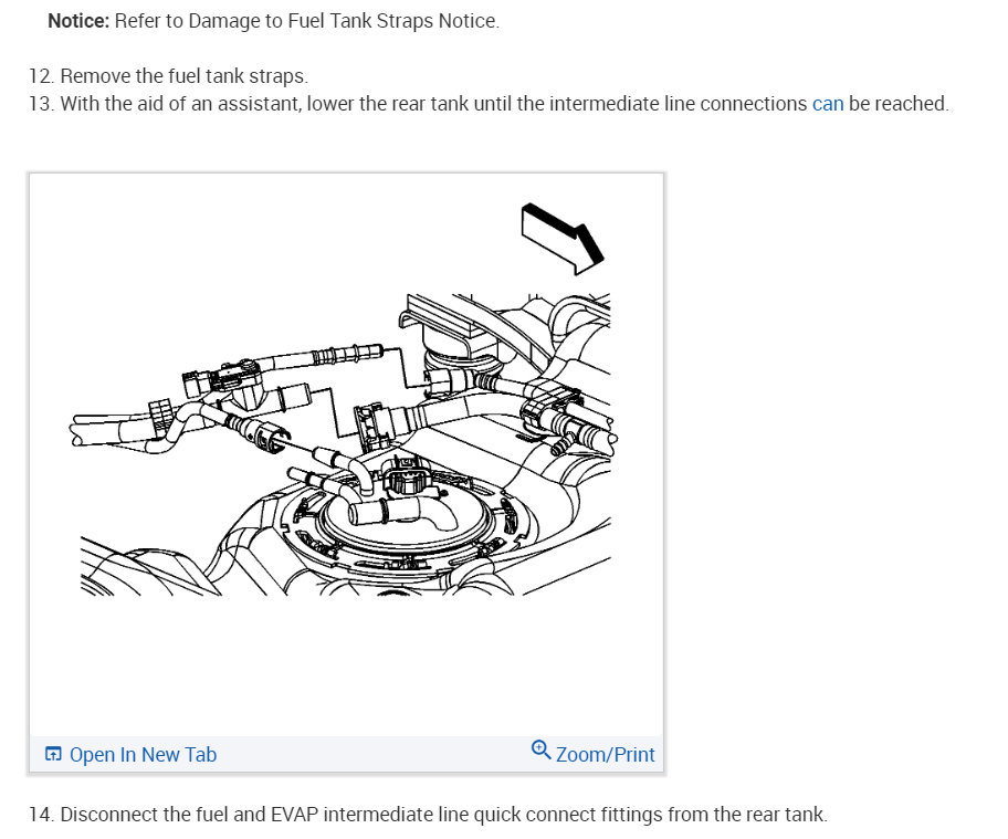

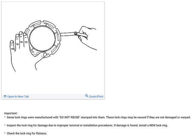

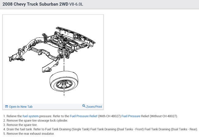

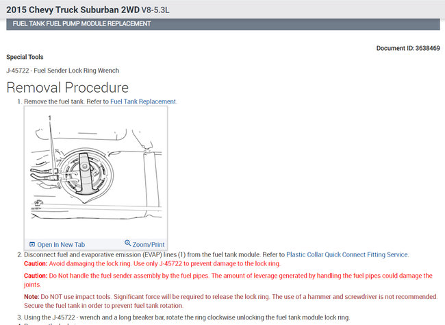

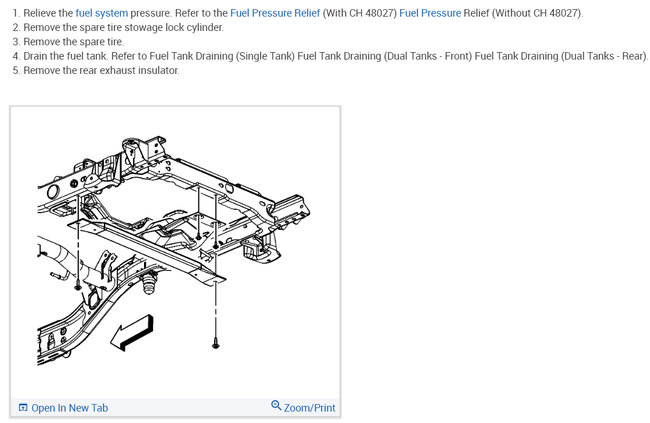

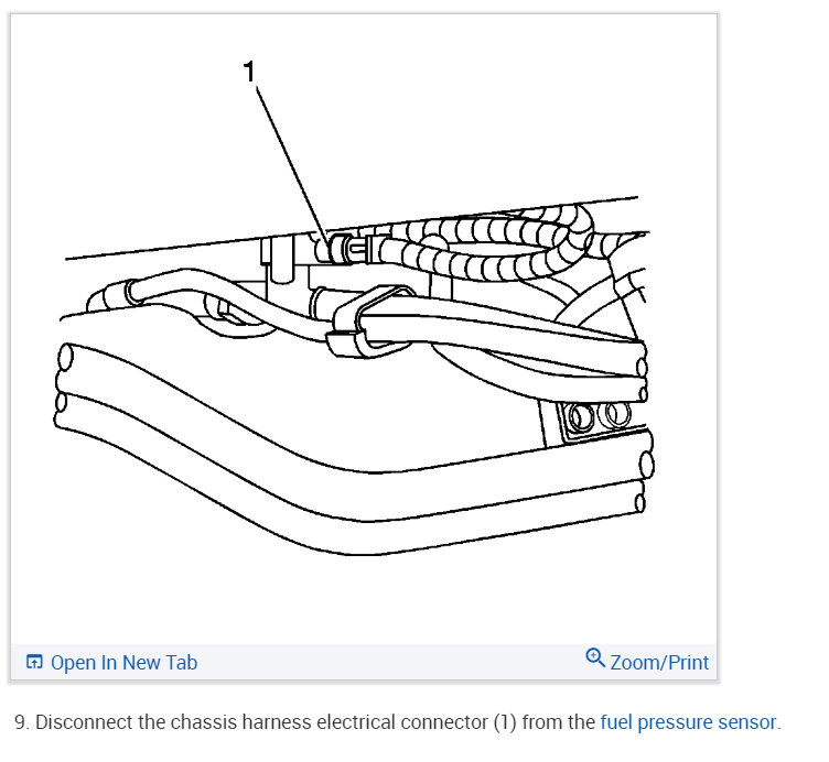

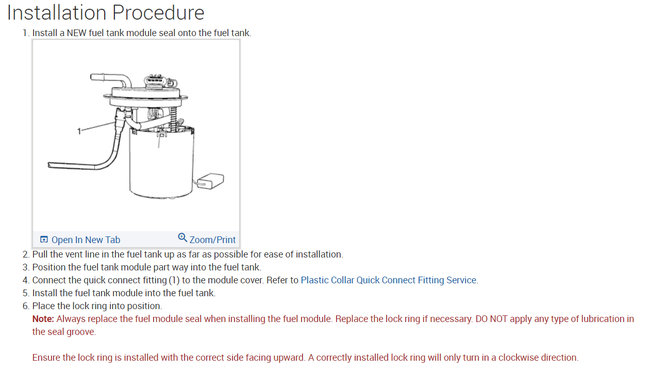

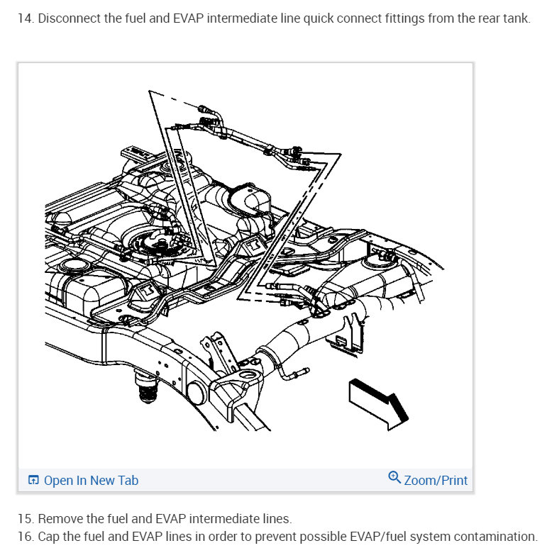

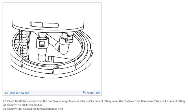

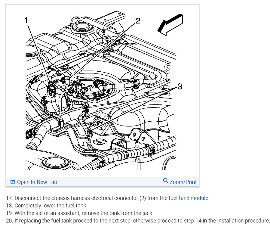

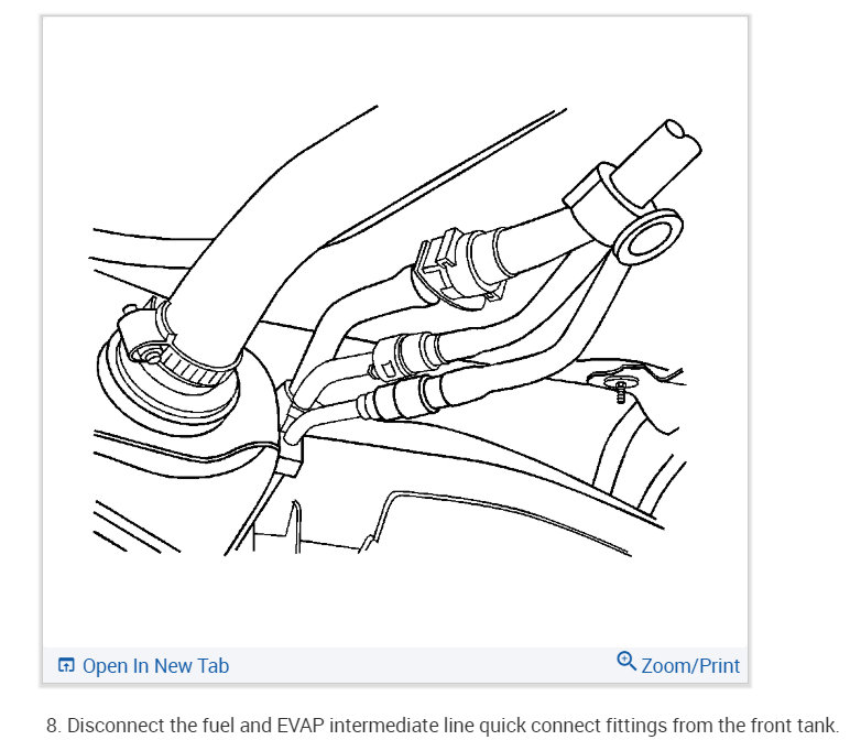

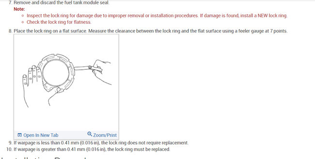

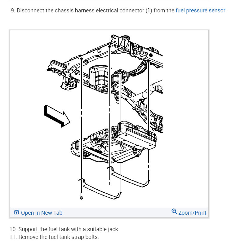

Yes, this happens when the fuel pressure starts to get low due to a weak fuel pump or clogged fuel filter if your truck has one. To be sure, here is a guide on how to check the fuel pressure and instructions on how to change the fuel pump out if needed, if you are going to get a new fuel pump unit, please get an AC Delco unit from Rock auto they are a few dollars more but worth it.
Here is how to change the fuel filter out with instructions after the fuel pump images below:
https://www.2carpros.com/articles/how-to-change-a-fuel-filter
