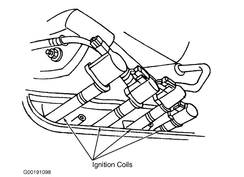

how to replace sparkplugs and wires in a 2003 lincoln towncar

you have to remove the ignition col covers then the coils they have one bolt for each coil there are not spark plug wires.. check the boots going to sparkplugs for damage, remove plugs but blow out holes with compressed air first. gp plugs to correct measurement and replace plugs . reassembly is in reverse order
