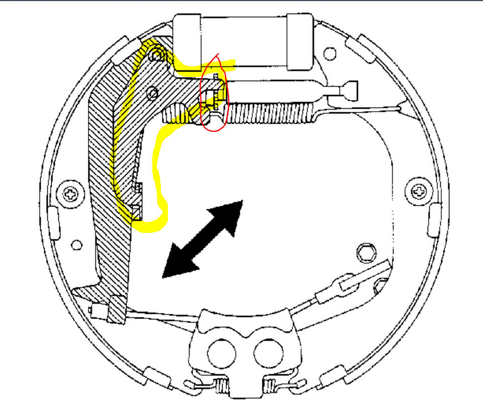

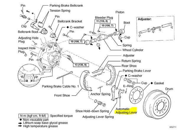

Does this vehicle have rear drum brakes? As far as the soft pedal, that is usually the result of rear brake adjustment. The brakes have a self-adjuster, but they can corrode and no longer work or the adjuster itself can corrode/rust and no longer turn. (See pics 1 and 2)
As far as bleeding, the system is sealed. No air can get into it unless it has been opened. So, no bleeding isn't required.
Based on your description, it sounds like the self-adjuster and adjuster itself need removed, cleaned, and lubricated. The brake shoes are likely out of adjustment.
Let me know if you have questions.
