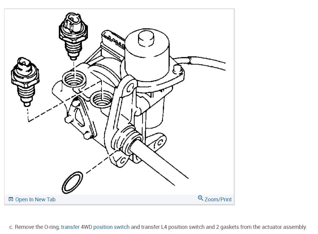

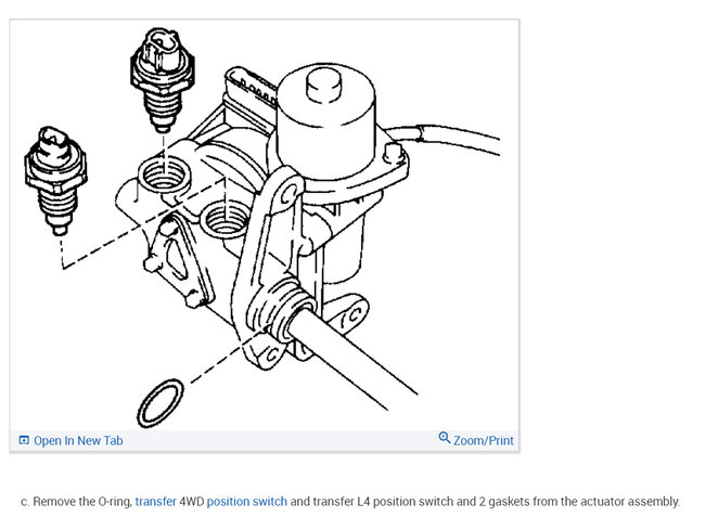

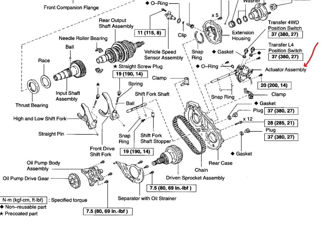

Yep, I would start by replacing the transferase shift actuator because you may have got a defective unit which is common with inexpensive parts. Here is how the job is done, if this doesn't help the transfer case is worn out and needs to be rebuilt. Check out the images (below). Please let us know what happens. I can send you rebuild instructions as well.
