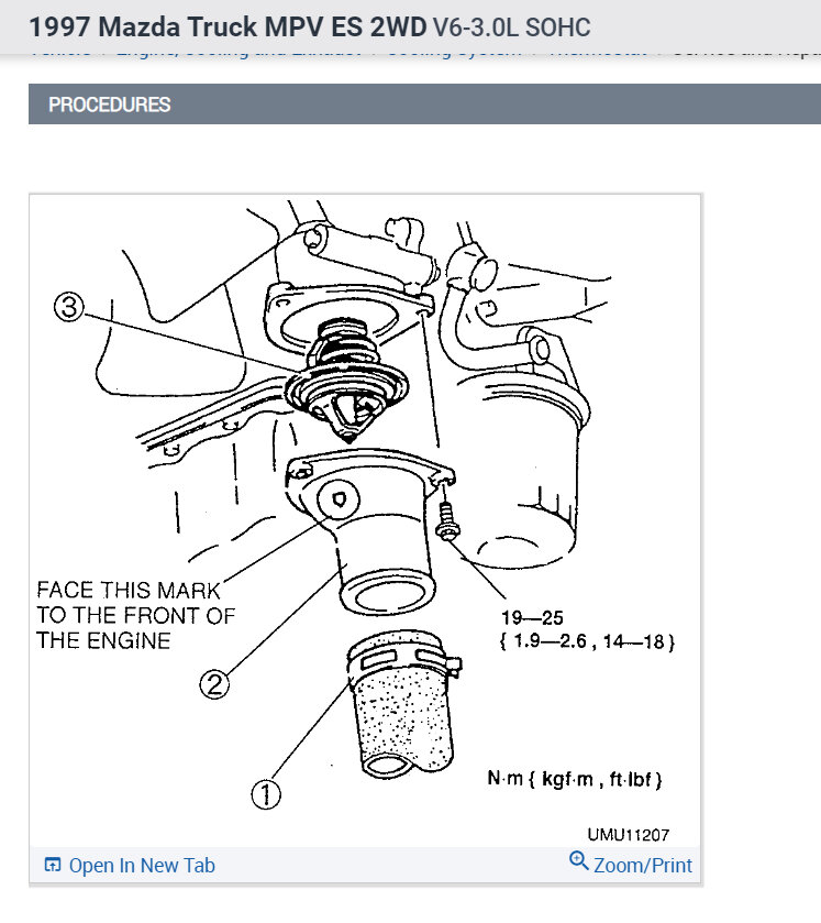

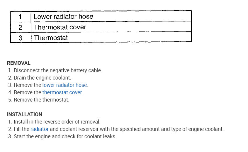

Yep, that is leaking pretty good, thanks for the video. Could it be you have a cracked housing? The O ring style of gaskets work pretty good if the sealing surfaces are clean. Please check this guide out below and I have added the instructions for your car in the images below. If you still want to install a gasket you should be able to take the housing to an auto parts store and they will have one that will work.
Once the thermostat is apart you can upload images in your response so I can see what's going on to further help you.

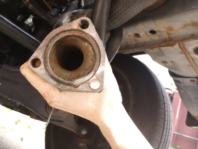

Thank you for your response. After talking to some people with more experience, I believe that the thermostat gasket is supposed to serve as the only gasket for the thermostat housing and there is not a separate one for the housing itself. I'm attaching a pic below; you can see where the thermostat gasket fits into the housing. I inspected the thermostat gasket, and it could definitely be replaced so I'll be installing a new one in the next couple days. I also took the housing apart again this morning and realized that I did not tighten the bolts enough when I put it together to make that video and confirm where the leak was coming from. I think that made the leak look a lot worse. Today I also soaked the housing bolts in vinegar and scrubbed them with a wire brush because I noticed that there was some gunk in the threads. I'm hoping that the combo of cleaning the bolts, getting a new thermostat gasket, and tightening the housing very well will solve my problem. The mating surfaces of the thermostat housing look pretty good to me. I don't see any cracks or chips.

Yep, it does look okay, clean and even surfaces are what you want. Let me know how it goes..

I think the new thermostat gasket plus cleaning everything helped a lot. It's not leaking anymore!
