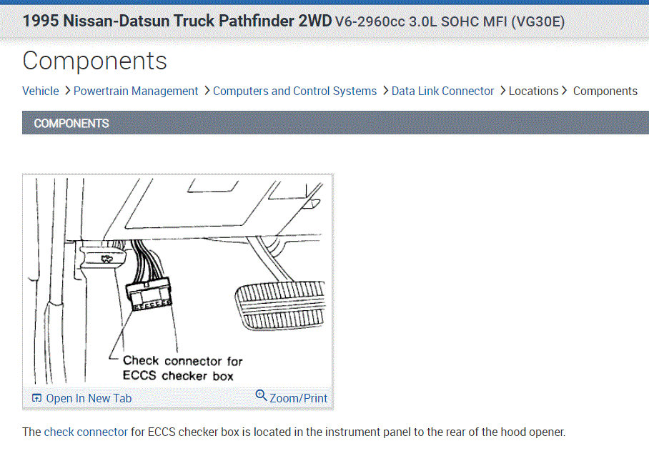

Yes, check engine light has been on for quite some time but it doesn't have a obd2 connection. how would I do a live read if I can't hook obd2 up? explain please. but in the morning when I start it I will take audio and send it so you can hear the ticking noise for yourself.

  • 110,248 POSTS
In 1995, they went to an OBD2 system. It should have a DLC. If it doesn't, I guess it could have been produced really early. If that is the case, take a look through this link. It explains how to retrieve codes from Nissan's OBD1 system.
https://www.2carpros.com/articles/nissan-obd1-diagnostic-trouble-codes-and-retrieval-procedure-1984-to-1994
If you look at the pic below, it shows the connector. Let me know if you are able to find it.
See pic below.
