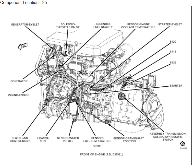

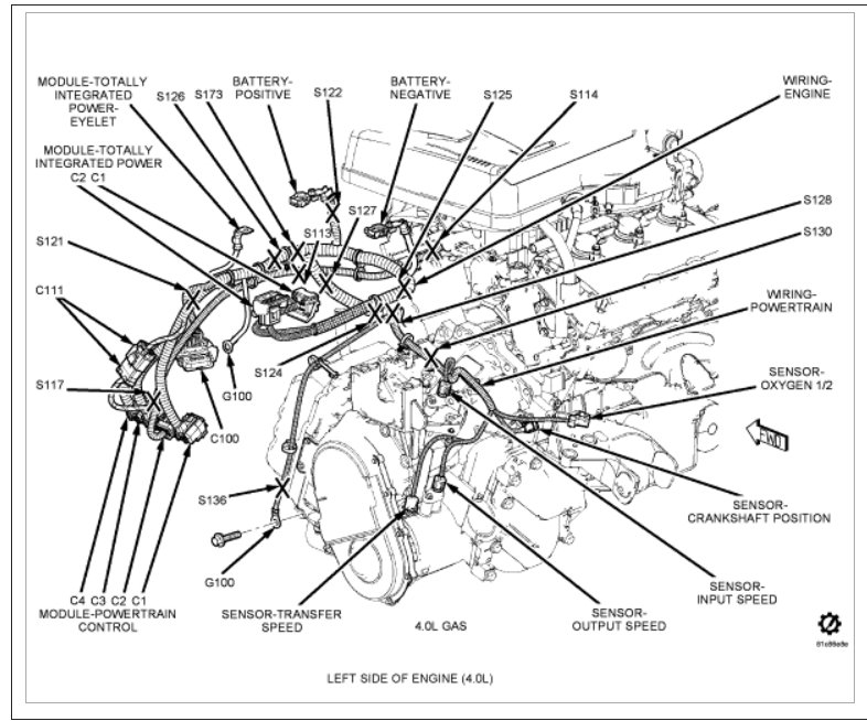

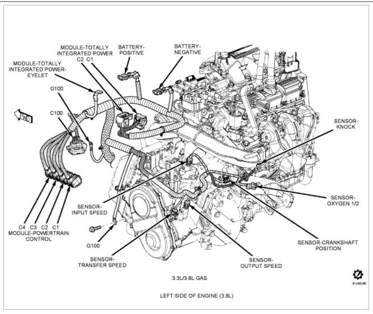

Yes, that is what I was going to say the classic crankshaft angle sensor problem. Here is a guide to help you see what you are in for when changing the sensor out:
Here is the location for your car I have included all engine options. Might need to jack up your car.

Thanks so much for the help. The images and instructions were great. I was able to find the crankshaft sensor and was able to get at it from under the hood. Unfortunately, as I was pulling it out the connector end of the sensor broke off and the base of the sensor is still in the housing. So, I am trying to figure the best plan of action for removing it. I have sprayed penetrating oil round it hoping to loosen the housings grip.
